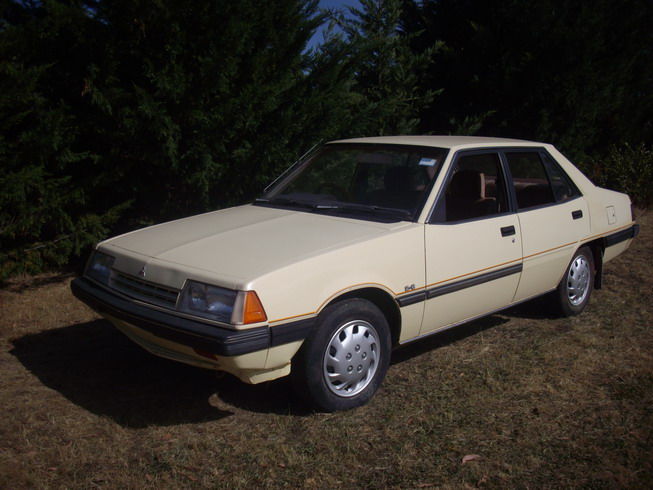

See, I call in every now & then to see what he's found. There is all kinds of treasure, usually in the form of old trucks. So we walk along the line and Dave says, "This one's probably too good to crush........"
Starts, drives, everything works, upholstery perfect..........even has air-con. 93,000km, and the speedo IS working!
sigma (4)_resize.JPG (108 KiB) Viewed 45541 times
Yep, it's a Sigma...........
'84 - probably the last model?
So, whats wrong with it?
Well, one tyre is peeling, and its outa fuel........and the radio is gone.
$400? It's coming home with me. :)
The short drive home reveals temp guage not working - the wire was off. And that flapping tread is a bit anoying. The spare was flat, but I pumped it up & it held, so that replaced the wrecked one. Bonus, the Florian wheels fit, & I've got a couple of good spares.

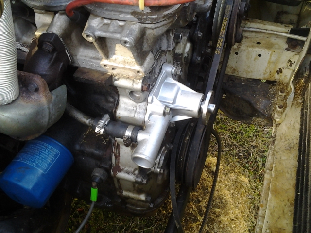

Step 1: Nice shiny new water pump. In stock in Autopro $80. Have already swapped the radiator, $50 from Young wreckers. Fitted a manual choke to the carbie, someone had removed the auto setup.
Might be some life left!

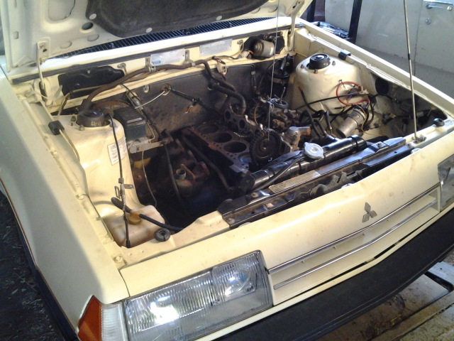

Soof course, it soon started blowing bubbles jn the radiator so, off with its head!
The back 4 head bolts were loose, so it was probably never retensioned after its last gasket replacement.
A vrs kit from ebay for $50 delivered and its back together. Drives a lot better!

I love your method of keeping tension on the timing chain there Matty :)
