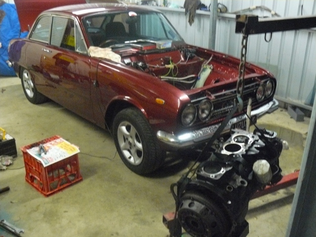

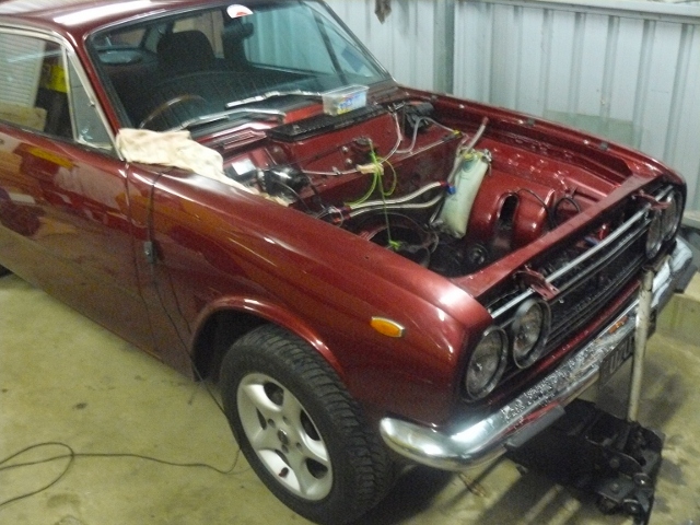

Missy has fronted to the operating table :? The twin cam in this car i bought in 1989 and the car sat for 18 years mid restoration while life and finances got in the road :evil:. The issue here is the engine was never a healthy one but the more i drove it the more it proved me wrong :P. with a few interstate trips nationals,nrma motorfest and a couple of interstate club trips :!: she returned home last sunday on three cyl's. I didn't bother working out why it's time to bite the bullet and give it a freshen up i.e rings, bearings head work, new timing chains ect. I have had a set of manifolds made to take webers so the gt carbs will make there way to another small project ;) more about this at a later date ;) While the engine is out i hope to respray the engine bay and repair stone chips to the bonnet and lh guard re chrome the cam cover and tidy up a few things.
Missy is wanting to keep up with rufus [Lewis's car] :lol:

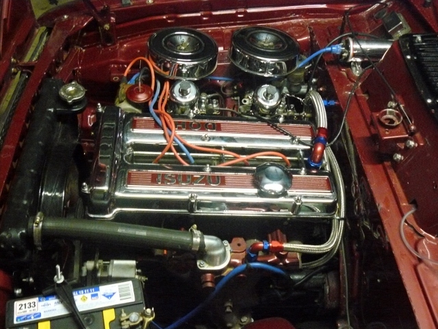

File comment: pick of engine when it first hit the road.

Keep those great pics coming in there Greg. She will keep up with the best of them once your finished.

She needs more than a hone :( looks like the blocks on holiday's too.

well the engine is back in the car and i had it running yesterday,it was in a bad state with the block needing sleeving and a few valves replaced with new modified toyota valves before she fired to life again. I fitted a pair of webers to it this time and had to move the brake junction to the fire wall to fit the air cleaners so a brake bleed today a few little tidy ups and a bonnet and i will have three gt,s on the road :D this day only took 22 years to acheive :lol: Nah im happy with that to be honest i thought ol yella was only a one day dream. The cam covers and a few bits are due back from being rechromed so it looks a little ugly with the odd bit's on her.
