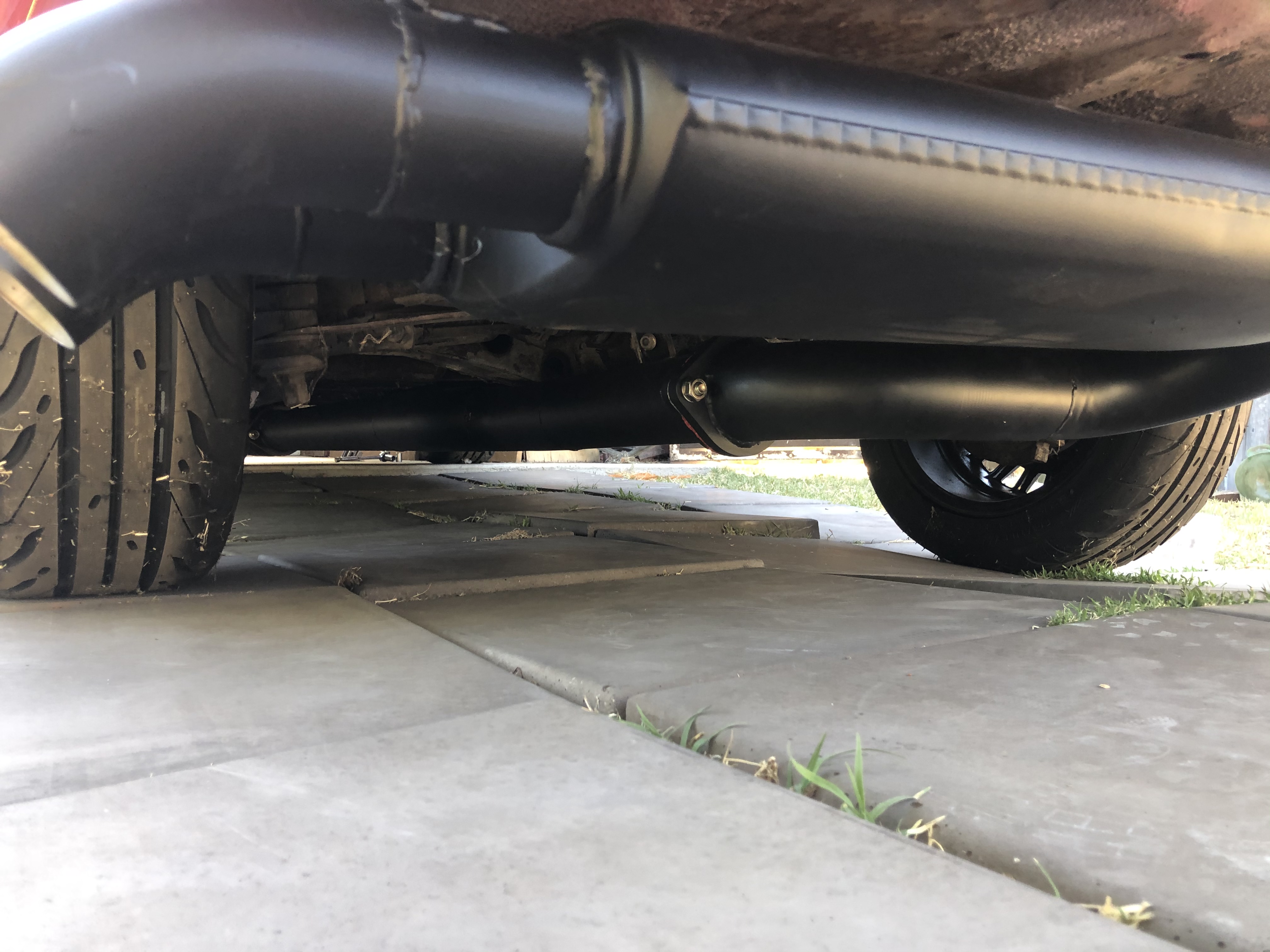

Exhaust completed.... wahoo!!!!
Wed Aug 19, 2020 8:40 am
Ok, side outlet. That's different, that's interesting, that's noice.
I'm looking forward to seeing this car, great work mate.
