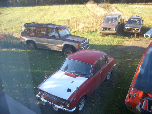

My Bellett is a four door sedan. It is fitted with a 4ZD1 single carb engine and a 5-speed gearbox from a Isuzu pick-up. Front brakes come from a Ford Sierra.
Here's a wiev thru my livingroom window.
Tuomas

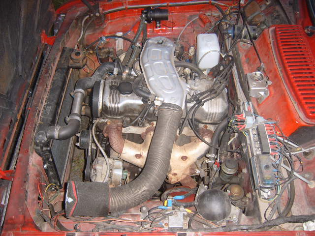

That's a 4ZE1 in Anttis race Bellett with webers etc. A pic of mine fitted with 4ZD1 (2,3l) is below. I once had a petrol heater in that engine compartment. It almost burned up the whole car. Luckily the fire department was quick enough to save it from disaster. You can even see the cinder on the firewall :? .
The most difficult part was to find an intake piping for the updraught carburettor to fit under the standard hood. This one is from a Mazda E2000 van! The oil filter had to be relocated as well.
Cheers, Tuomas
