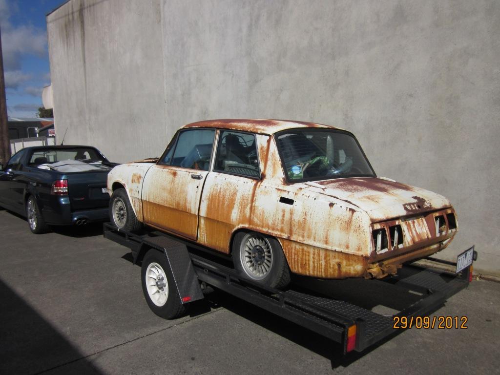

tomorrow is here and we picked up the spare car today. Thanks for all the help so far, Jason.
I knew from the start it would take some time. In fact my own projected arrival date was only one day out.
The process is a bit drawn out and import approval compounds that a lot. Getting two cars and a heap of parts too does not help either.
More pictures now on the new picture thread. Warts and all.
"Patina" this car has in excess.
I already started to work on the other car, i removed an air cleaner from this one and cleaned it up at home. Not sure if i can get an air cleaner element for it? Maybe some period Nissan had them also?

something for my three days off each week although this morning I was "told" the balcony on the house has to be painted next. I think that needs negotiating till after Nats !
That car is very straight except for the transit damage. Guards easily fixed, bonnett more work, but I am not going to do any work on this car. Energy needs to put into the better one.
I did see some air cleaners on ebay that looked similar to these. The guy is not far from me so might stop by or phone him to get measurments sometime. I like the look of these air cleaner cases so would prefer to use it if i can.
There are so many things to do though. 1st off is to get the engine running. Will buy a new battery next week too once i know what size it is.
I was not real happy with the way the trailer towed, it may have been because the rear of the car was weighted down with all the stuff in it.
Rear spring?:_ has 3 leaves, I have forgotten what a sedan and GT has?

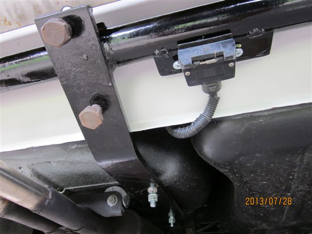

an update on my Sports.
You may recall I was looking for a tow bar. Craig helped me out and I have now fitted it up. ( I had 2 other offers also, thanks to those who did, but this one was closer to home) Not without some drama though. I was thinking a few hours would do it but that's never the way. When half bolted up, the bumper bar was hitting on the tow bar so off it came and a section of plate had to be ground out of the tow bar.
Then the holes in the part under the tank were not it the right place so had to be redilled so as to fall into the pressed area of the boot floor (where the spare sits)
I found the wiring diagram from the PR60 owners manual has different wire colours to whats in the car so had to trace them all out. The diagram appears to be from a long tail light model but i would have thought the wires would be the same. Not so. One win though, a towbar wiring loom out of a past Ute I had, was pressed into service. Never throw anything away!
Last problem, the bolts holding the tung section did NOT want to come out.......

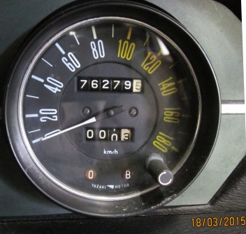

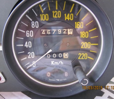

My Sport speedo reads about 16kph off so i decided i might try the spare speedo instead from the other car.
Got it a few weeks back and today cleaned it all up, removed the glass to clean inside etc. Inside the actual speedo is very clean compared to the Sport which i dismantled.
What really surprised me (something not notice before) is that the two speedos have a different max speed!
Both cars were made in 1972, one in May one in August so you wouldn't think there would be any differences.
BUT my Sports speedo reads to 180kph while the spare reads to 220kph! Note also how the zero reading is at a different place on the dial.
Can anybody explain this? I think' GTR's had 220kph speedos? Anybody know.... (maybe I have a GT-R Sport model, very rare :) )
1st Pic is my Sport, 2nd is the spare

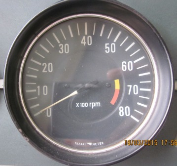

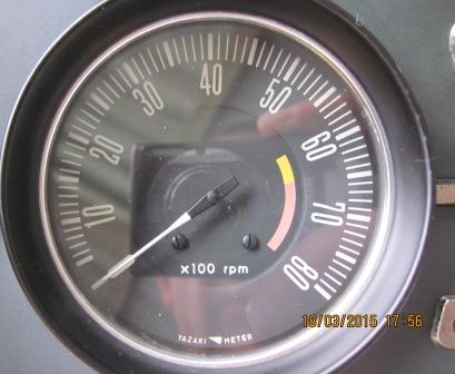

funny, there's more, Tacho's vary also, warning sections at different rpm, numbers done differently. Seems to imply different engines.
Another interesting thing, the overspeed warning buzzer is not on my car but is on the spare.
again, any Ideas ?
1st pic is my car, 2nd is spare car
PR95.... whats in your GT ?

My 72GT has the 220kph speedo and 6500 RPM Yellow and 7000 RPM Red Line tacho same as the first one you posted, and looks to me that they are matched with same space between the numbers.
Geoff
Wed Mar 18, 2015 7:54 am
Geoff
thanks Geoff,
appears mine is a mixture ..... wrong speedo, right tacho. Or they just chucked in what they had at a the time on assembly line !
strange though as Japanese rego papers show correct odo readings.
I'm going to fit the spare speedo and tacho for now as its simple to do, to see how the speedo accuracy is.

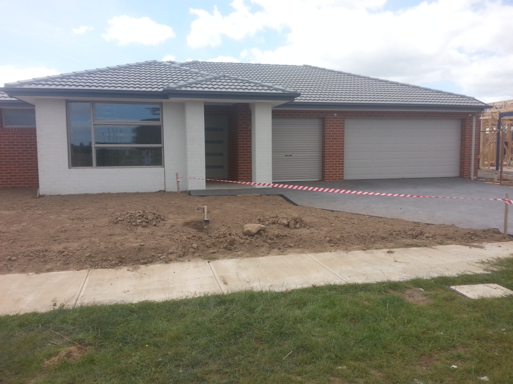

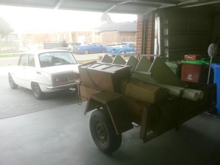

Have now moved almost every thing into the new house, bar a lot of stuff from the shed.
Bellett Sport has done sterling duty, moving everything, in a 6x4 trailer..... a lot of trips of course and many entries in my Club Permit log book.
the sharp eyed among you might notice the builder put two types of garage doors on the place. Single is roller, double is sectional. Of course they should both be the same, sectional type! (fixed now) Among many things screwed up in this build.

one Sport fits in there... plus my and other halves every day cars. Although its a bit tight right now till we unpack all the boxes !
Need some volunteers to help in the garden .. ;) with the rain we been having, bring gumboots. :)
Another load comes in... Interesting point, the trailer is older than the Sport. I built it in 1971, my first welding project.
