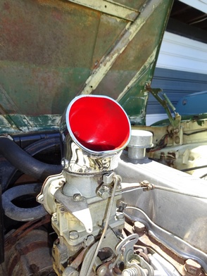

Author:  Stickman [ Mon Aug 24, 2015 7:32 am ]
Post subject:  Re: Dear Donkey.....
The early Bellett Nikki was bigger. Had bigger jets too.
The late Bellett one was rubbish. Small chokes, small jets.
Is all due to the cam they had.
If u want a Nikki, get a Gemini or Datsun one. You need a different air cleaner tho.
Donkey's is the early Nikki (and doesn't use an air cleaner :twisted: )
Author:  PR91 [ Tue Aug 25, 2015 6:06 am ]
Yeah same size neck as a Stromo.....
Nikki jets are interchangeable tho. U could always just bang some bigger ones in out of a Gemini or Datto.
