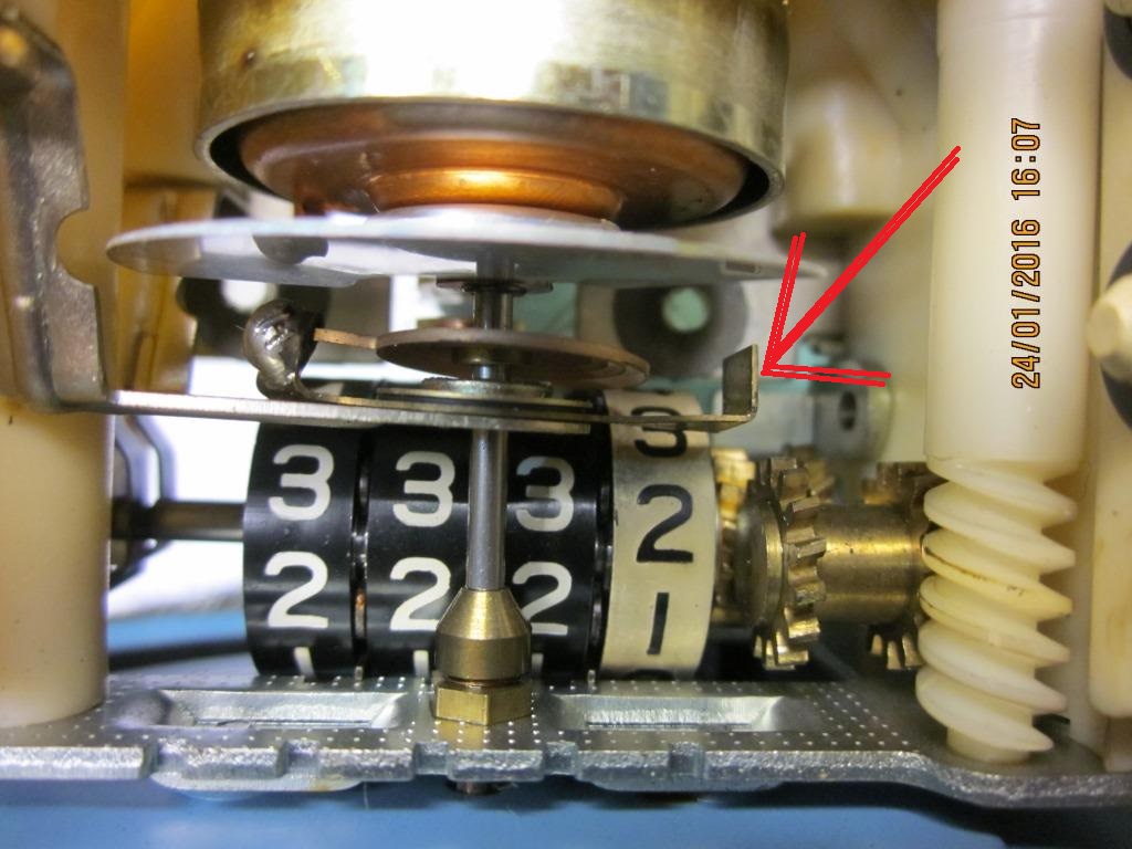

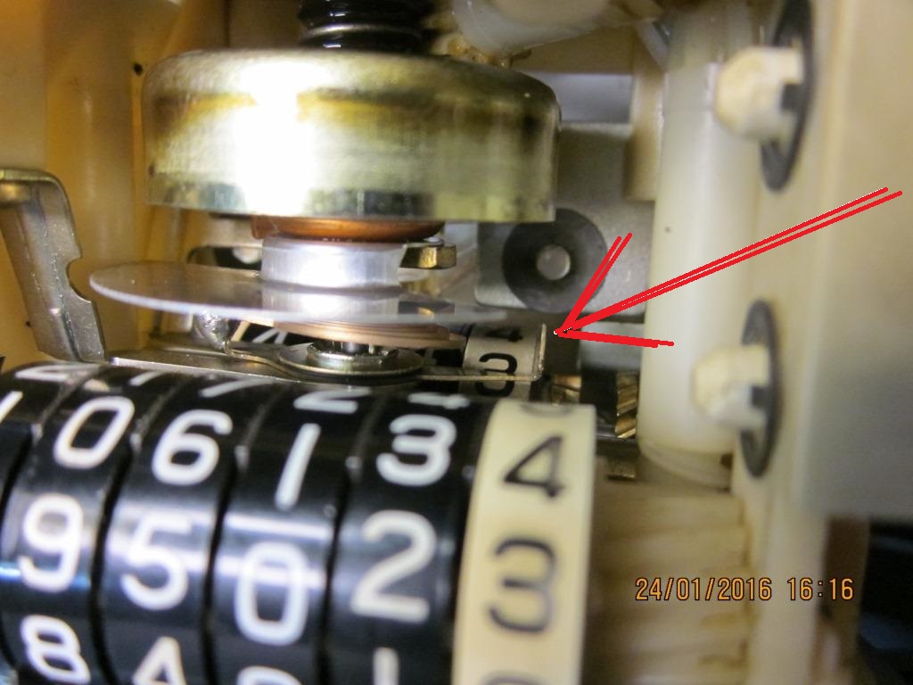

an update on Speedo's
Mine reads slow by quite a bit. Pulled it apart again and adjusted the little lever. Pics show where its located (near the spring).
In one picture I removed the Odometer wheels, so that it might be clearer.
In general, pushing DOWN on that lever on rh side makes the needle read higher. Be careful as the metal is very thin. Don't slip into the spring either or you will ruin it.
My speedo reads about 15kph slow. It shows 86 at 100kph ! A lot. Just how much to adjust it depends on the error. I pushed mine down with a small flat blade screwdriver about 2mm or so. I am yet to test it but will report back later. If you press too far down it will hit the trip meter digits. Don't do that.
Ideally if you have a helper and a known speed device (eg GPS units often have a speedo in them) then you could have the speedo opened up but connected to the speedo cable and have the helper adjust it as you drive...... NOT EASY though. Be careful. Alternate is to do a little at a time with the speedo out of the panel so you can stop, adjust it, then try it again..... when happy refit it to the panel.
