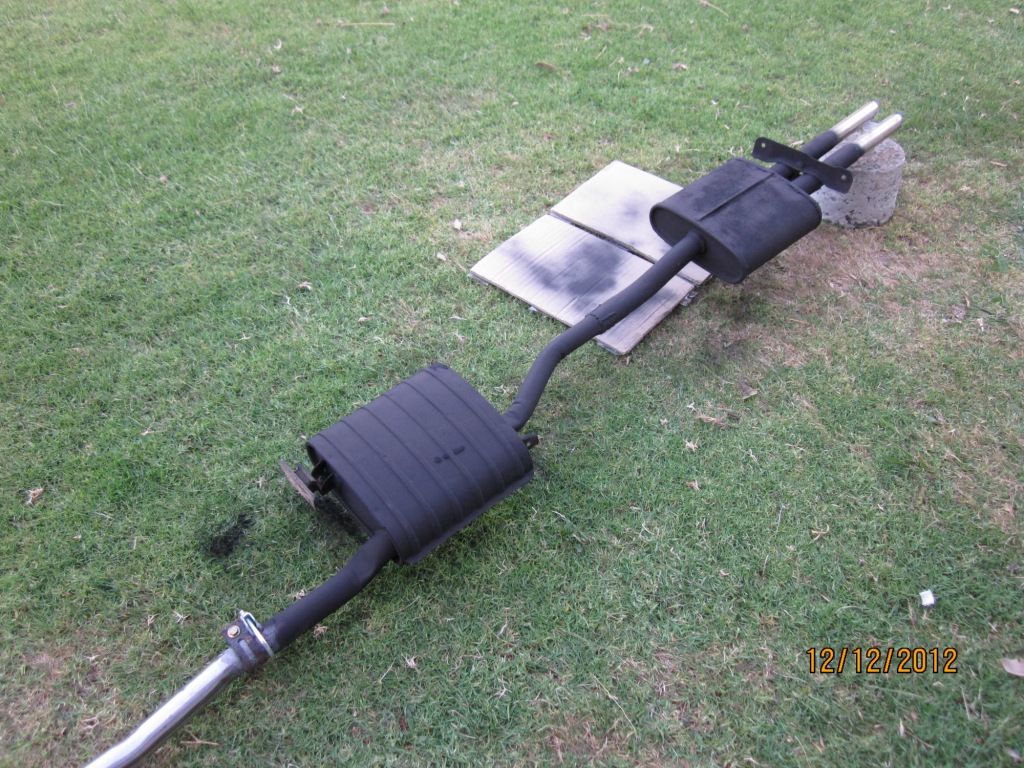

Re: Sport" Bellett sedan PICTURES
Post by Glenn »
this is the exhaust. I replaced the forklift damaged section up front and fitted an oval bolt on plate to make removal easier. But, after a couple of drives, it's painfully apparent that one of the mufflers has a loose baffle in it. [it rattles like mad] Hard to tell which really but i think the rear. Spare car has a muffler on it, or maybe should just find another to replace it with.
Can't fix the steering noise, it might have to come out completely to see what's wrong. Maybe the donor car again. It's drivable as is but annoying. :(

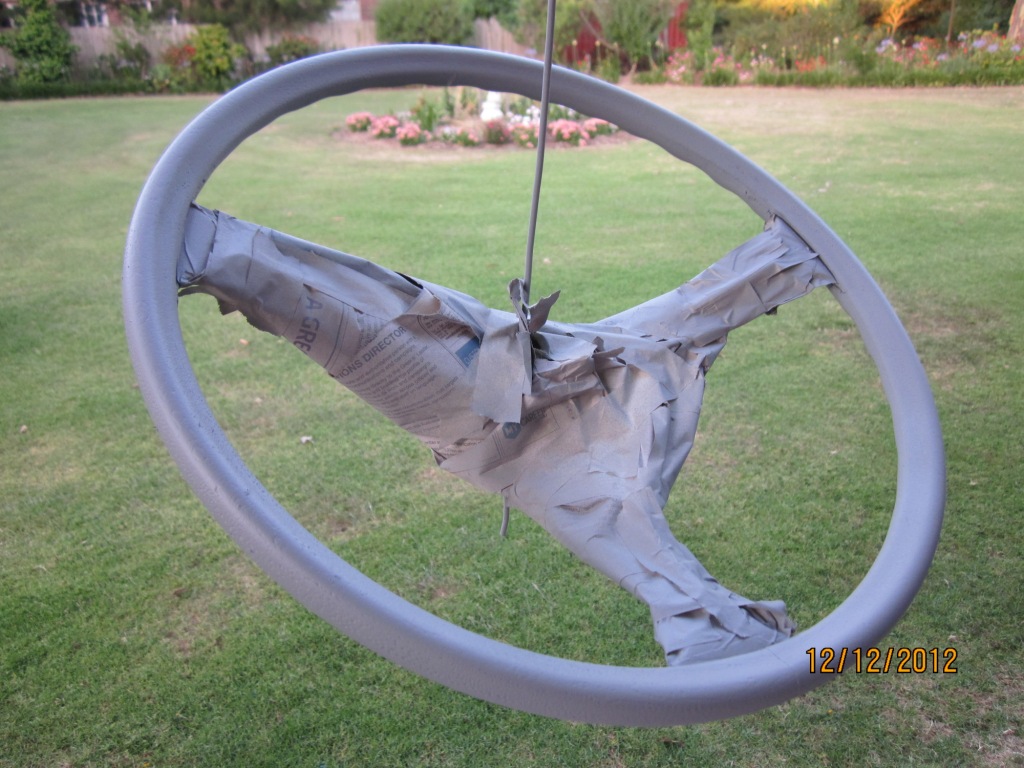

Steering wheel was cracked and both the spare I have are also. I elected to fill the crack and two pak it in grey for now. OK, it's not 'restored' but its a sticking point for a RWC as it is. These late model wheels are plastic and they shrink and crack. Later I will get it leather wrapped I think. I also have an aftermarket smaller wheel for it but it has no centre horn assy.

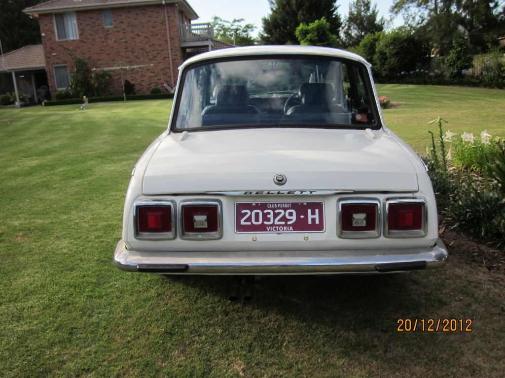

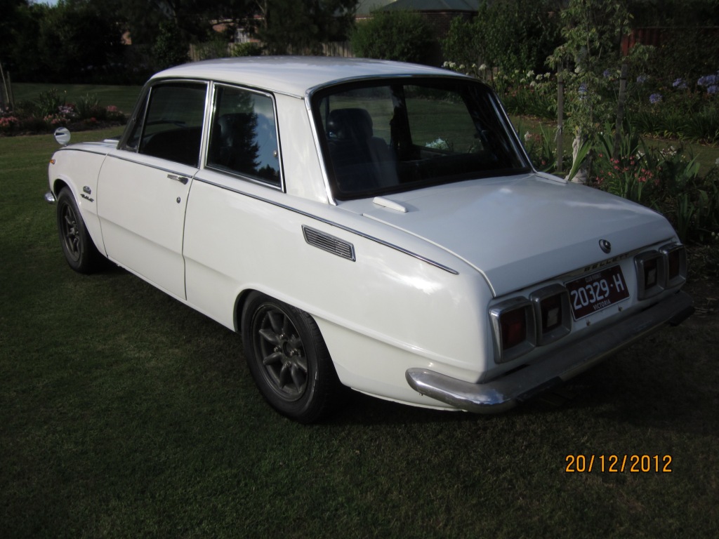

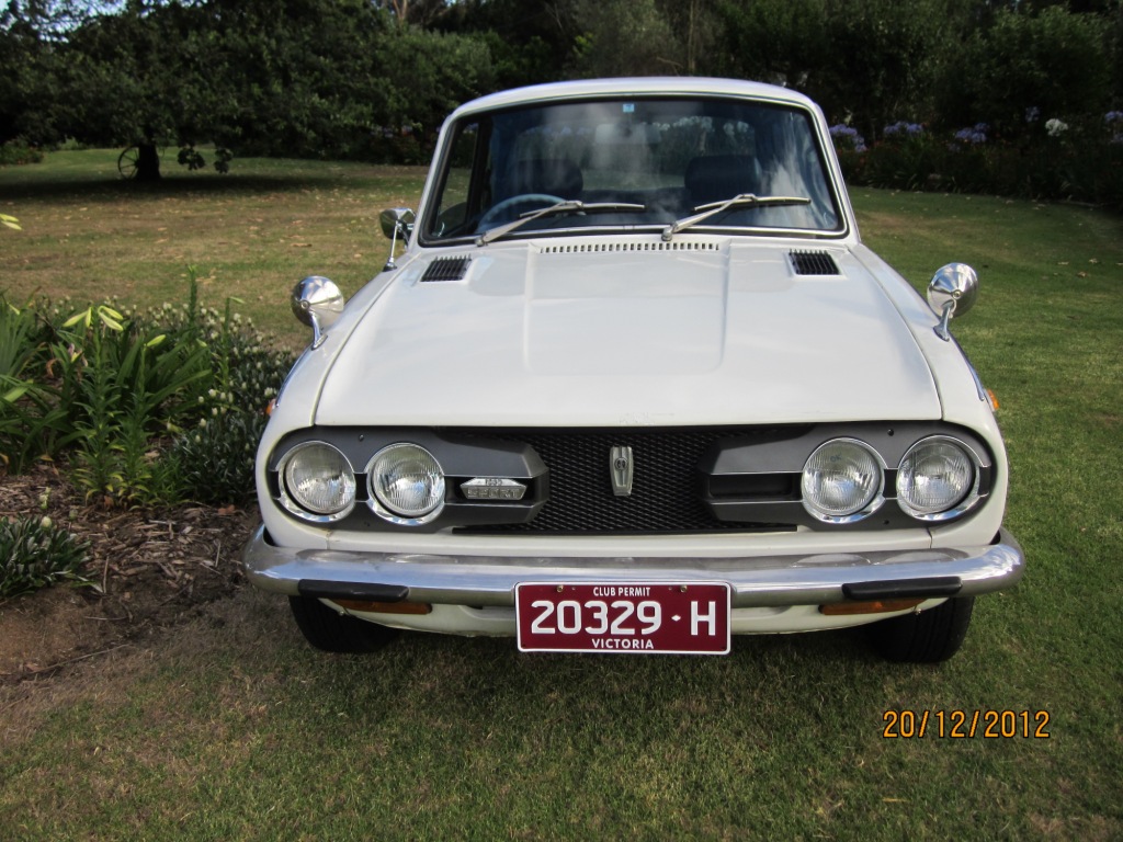

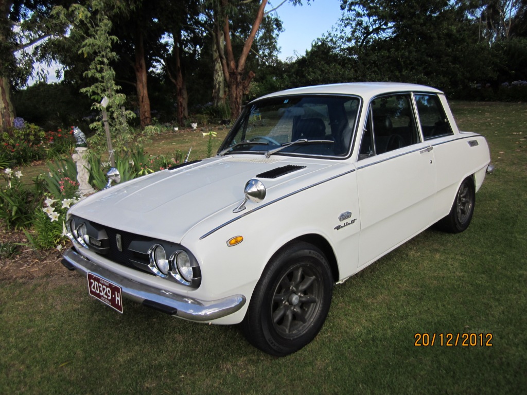

OK, finally got there!

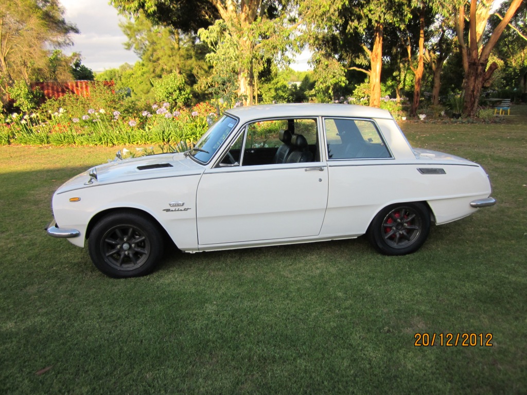

RWC yesterday, a hiccup, the red painted calipers (ex Japan) not acceptable. Aparently 'aftermarket' painting of calipers is a no-no. So, had to strip the red paint off last night and bring car back for inspection again. Stripping was not an easy job! Car has now travelloed about 60+km i guess. ODO is not working but speedo seems fairly accurate and is steady. Ride is very firm. You do feel those 'bumps' on our 'super highway' roads ;) Steering is light. Brakes as i recall.... not great. IN fact only just passed the RWC brake test but there was a fair bit of surface rust on the rotors which should clean off with use and hopefully brakes will improve a bit.
Armed with the RWC, i went off to the Vic roads office to get some shiny new plates. Not all offices carry the plates in stock so had to travel quite a ways to get them on the spot. All over in about 5 minutes then. They didn't even want the Eng report ! :shock: :? Contrary to their own web page.
There are still things to do, over time. eg Interior carpet, while half decent, has shrunk. But car has genuine 'Bellett' rubber mats (not in there yet) front and rear to cover that over a bit. Bumpers need new chrome. The sharp eyed among you will notice there is a GT door trim on lh side and a "sport" on rh side. Left door trim backing is badly water damaged and will be repaired asap. Most of the paint is as I got the car except sills, part of front guards, rear quarters (bottom only) and bootlid. A cut and polish is needed.
It's been quite a journey! More to do, but the pace will slow down. So many things around here neglected, i need to catch up on.
Post by Stickman »
Congratulations Glenn, job very well done.
Very very nice looking Sport indeed I must say.
Post by Glenn »

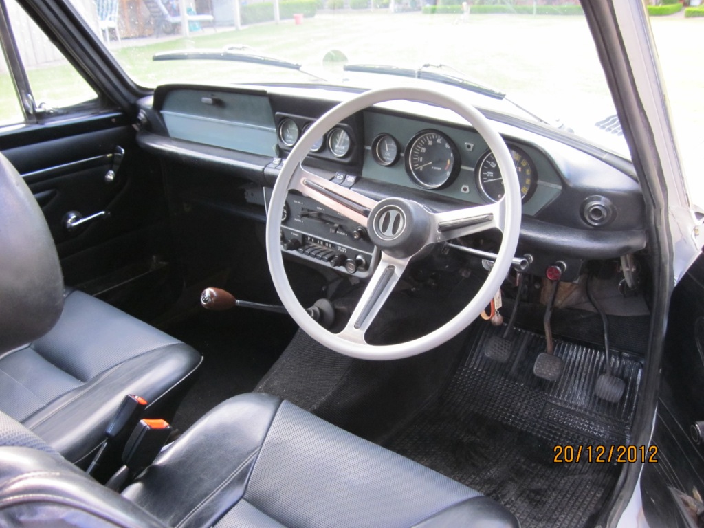

thanks for the kind words. It actually probably looks better in the pictures.
Post by mrflibbles »
congratulations, she is a nice looker!
are you going to leave the rear view mirror on the door?
must feel real nice to have the plates on her!
