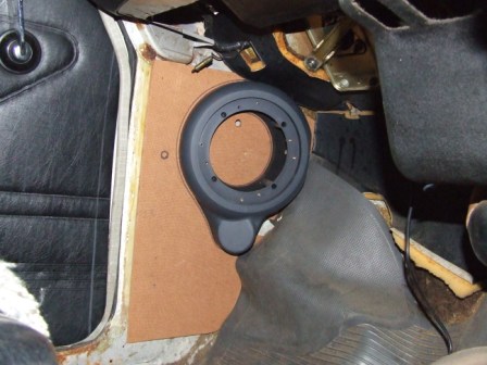

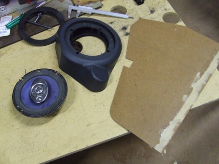

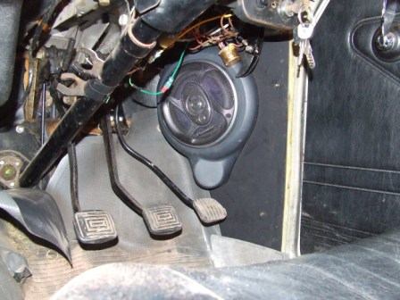

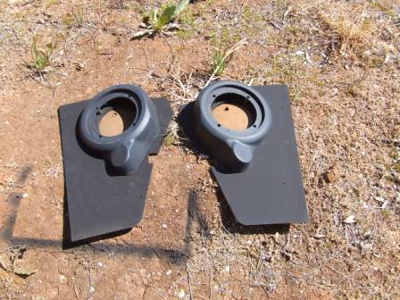

Latest update on the front speakers.
The panels aren't covered that will be done later.
The sound is pretty good with all four pumping :D
Still got a fair bit of work to do, bit I'm still ticking things off my list.
Got radiator back, wasn't too bad after all, must have just been the water pump and lower radiator hose leaking pressure.

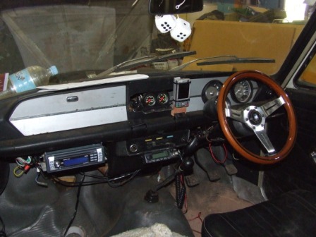

Well I reckon this will be the last update before I see everyone at the Nationals.
Well after getting duded with one of the uni joints and the other not having enough packing to stop the rollers falling out every-time you touched the thing I finally got the tail-shaft back in.
In the meantime I also finally did the conversion from side handbrake to center handbrake. I still have to take the front seat out to remove the old handbrake :shock:
Stereo in and it's LOUD. First time I tried it it blew the fuses :o
Rewired it directly to the battery through a relay and heavy duty fuse, no blown fuses now all the way up to window rattling volume ... oh wait that's not that loud in a small Bellett :lol:
Gauges, spotlight switch and GPS mount fitted into dashboard. Though it's not pretty it will suffice for the moment.
Sadly, i'm going to run out of time to finish the steering wheel horn and boss, I will have to make to with the ebay purchase instead.
What else ???
Radiator not too bad for a 40 year old (I think it has been replaced once before, it has a really old NatRad copper label affixed to the fins), back flushed and pressure tested, cap neck resoldered and she's as good as gold.
I managed to get another washer motor, not the right one though it's good enough to spray water on the roof :shock:
Changed wiper arms, still need new blades but at least they sit on the windscreen instead of flopping all over the show.
Looking forward to catching up with everyone at Coona.

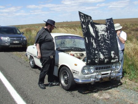

Sad news :(
Bella didn't make it home.
Broken windscreen and blown engine.
Still had a great time and enjoyed catching up with everyone.

Thanks guys.
DM it was 70km approx from Balranauld when the screen went. We then forgot to top up the water, so ....
60km from Balranauld engine expired. (oil exiting from between head and block is never a good sign).
