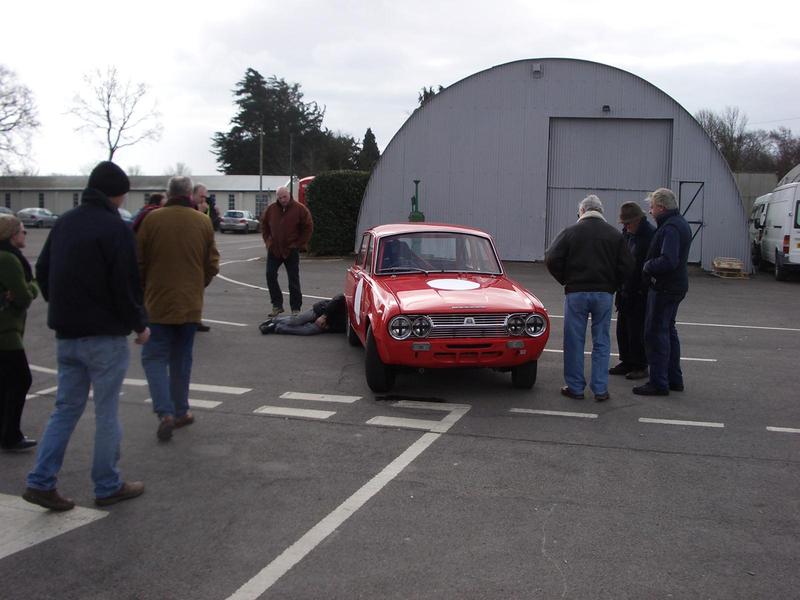

And lastly, some of you might enjoy this photo taken at the Goodwood test, it gives an idea of the interest Rolie is generating over here.....when you consider the other stuff they could have been looking at.
Wed Mar 30, 2011 10:57 am
Great wealth of info here Brett,Iam currently running wheels off Pinky to see how tyres wear on the front as they are new.Tyre that was on front left,nearly slick on outside,have a box of shims workshop manual,can talk to someone old school for wheel alignment ANY OTHER TIPS Gerry
Wed Mar 30, 2011 11:01 am
Geeze Gerry when I saw that pic of the Pom Bellett and I thought that was you lying on the ground under it :shock:
Wed Mar 30, 2011 10:45 pm
:oops: Yeh got told by a few I was seen lookin under the backend of the odd Bellett at Coona,even got caught on film,can asure you that problem is under control,and it was'nt the drugs :lol:

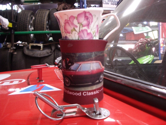

In the meantime thank you to the Forum, in particular, Dave for my gift from down under. Below is a pic of it being used as it's intended I assume...keeping a nice cup of tea warm.
