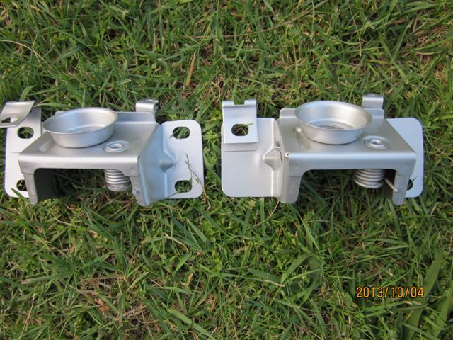

While working on the Sport today fixing a leak in the petrol tank drain, I found another little 'difference' today. The bonnet catches on the '72 Sport (and I assume most late models) have only two bolts. Maybe a worker suggested they save 2 bolts and got an award :) :)
File comment: Variation in bonnet catches.

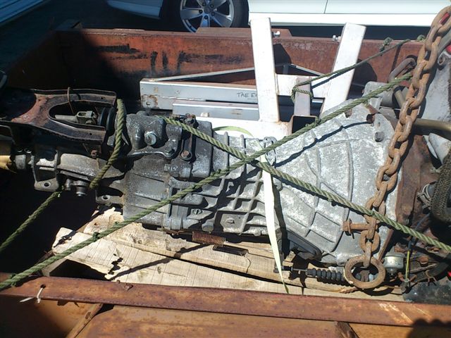

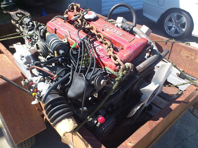

Finally, I also now have the 2L DOHC and 5 speed. It missed the boat when the Sport came and arrived on a later shipment and has been sitting in a wharehouse here for a while.
Info I have when buying was they had ~83,000km on them. I have no idea if a 117 speedo (Odometer) has same number of digits as a Bellett? If it has 7 then it may be genuine. ie not 2nd time round.
I am unsure right now what I will do with them though ! Maybe sell. I was thinking to fit them to the spare car if i decided to restore it but that looks less than likely, time wise here now.

by the way, the engine and box were picked up with the Sport towing a trailer, with the "new" tow bar. (thanks Craig) My trailer is pretty heavy and i would guess it was pulling about 300kg all up. Seemed to pull it ok although you know its there !
and, while putting the engine into storage, a guy from a factory over the road came over with the usual, "a Bellett, i had one of those, this one looks different though"

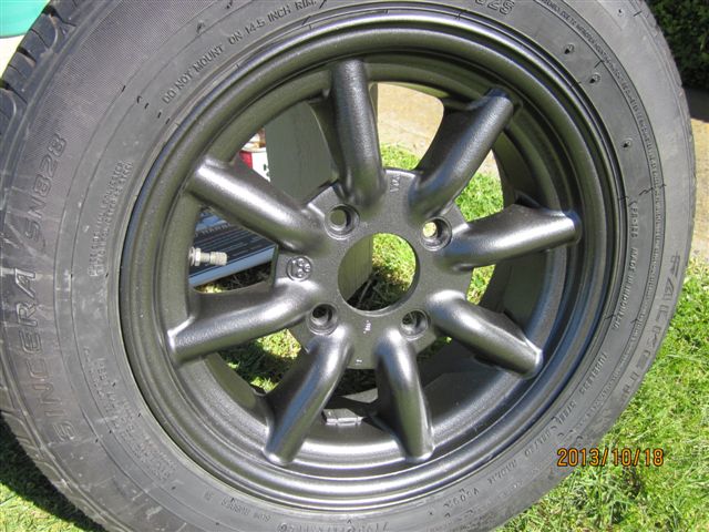

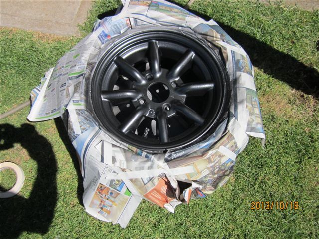

Trying to tidy up the Sport a little for the upcoming Japan day, car show next month (unsure of the date) in Vic.
Decided to re-paint the Watanabe wheels. They are currently a bit ratty looking with original paint which is like a semi matt grey colour and badly chipped and spattered with cement for some reason. I was never that keen on the dark colour, preffering the more conventional Minilite silver but having done these, they don't look too bad now. Dark wheels are the current fad anyway!
KJB put me onto a spray can from the big 'B' hardware store. It's not the same colour but do add a little bling to the wheels, being a metallic black. A bit fiddly masking up but have done two now and they come up pretty well. Not as durable as a Pro paint job perhaps. The centre picture probably shows the colour best.
Now, where can I get some caps for them ?

Fri Oct 18, 2013 8:45 am
Measure the the size you need and enter it into ebay search, I got mine from a guy on NSW noth coast. Then get onto early GT for a set decals to go in the centre :)
