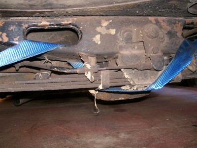

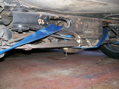

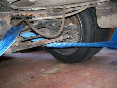

Posts: 199
Hi Alistair, great work, keep going. Looking at the photo's of the rear transleaf spring it appears to be installed upside down, if my memory is correct to w plate should be to the top and locates with a rubber shaped the same, this may reduce the pos camber a little. Prior to me obtaining a factory competition transleaf, we use to have two, sometimes three transleaf springs clamped together, hard to describe though they started with the spring tensions oppisite each other and then clamped, then for a little more neg , we would place either another larger rubber between the leaf and the wishbone mount, or if this was too much, one of the smaller rubbers, these little adjustments are dependent on driving and or road conditions, if i get a chance I will post a photo of the factory rear transleaf, regards Geoff.

Would be great if you did have some pictures, I had a thought that it may be installed upside down when I was first looking at the camber issue.

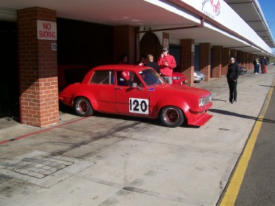

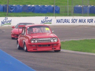

Posts: 199
Rear is set at around 3 degrees neg, i do not have shot from behind. this is the best on hand :cry:
Wed Dec 17, 2008 12:48 am
Posts: 199
Sits nice under load, uses all of the 255mm of rubber ;)
