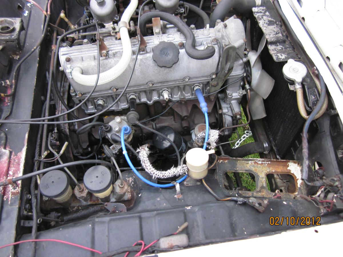

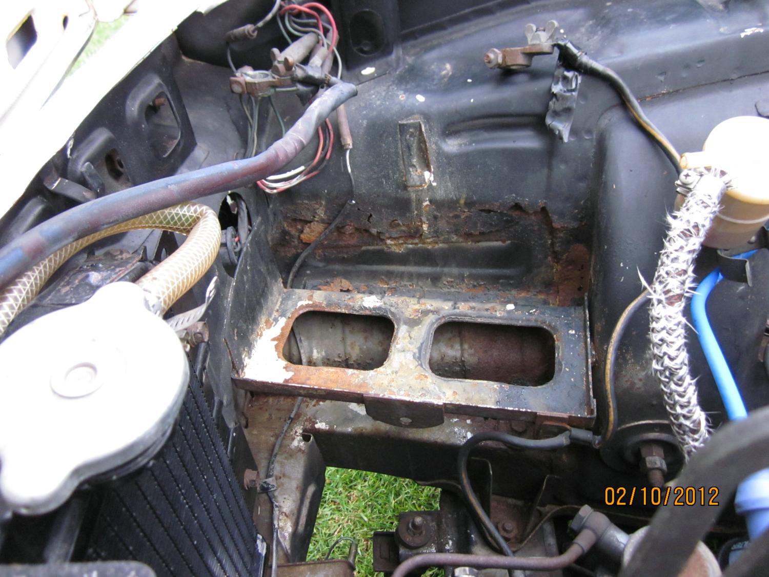

Gent's in the light of day, some nasties appear. There is pretty bad rust in the battery area and possibly down to the chassis rail. I just quickly looked this morning before leaving for work.
No fluid in master cylinder, but has brand new rubber caps on the 2 reservoirs. Typically these in my experience deteriorate badly so new is good !
The battery was on charge all night and seems to be good. Runs the headlights ok and turns the motor over. (Just briefly to check it.)

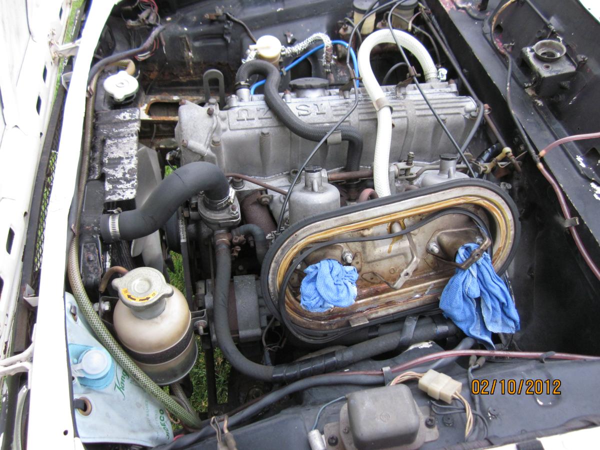

Radiator appears to have been re-coed. Green fluid in the radiator looks fresh.

I need to get it open to see whats in there.... no coil on the car either. What type of coil do late models use ?? Resistor type or standard non-resitor?? Distributor has new cap too so it appears the guy was trying to trace the ignition problems and gave up......

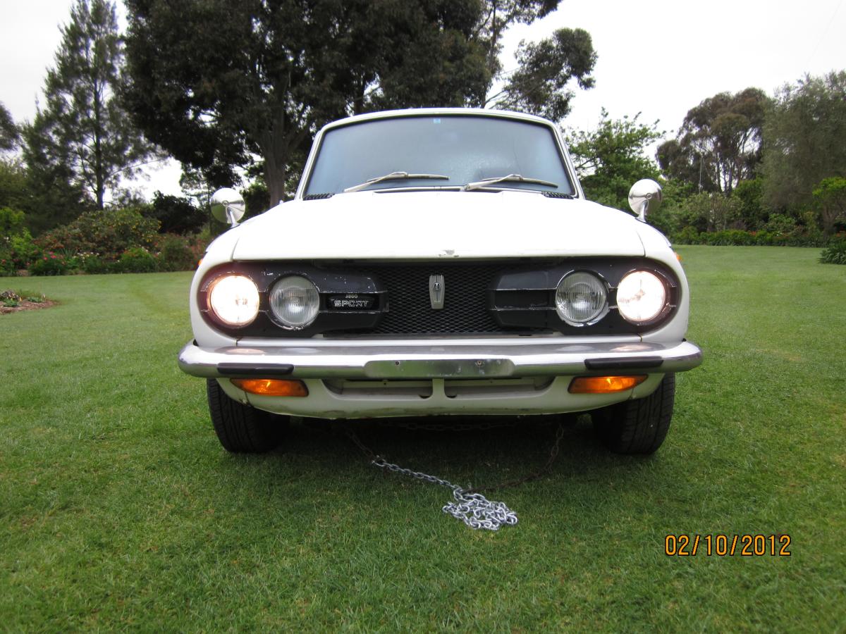

File comment: Finally, the Sport is in my backyard...

But I will give it a shot. The rust in the battery area and sill is a concern as it's maybe a RWC issue so needs to be fixed. To do that properley means engine out. I want to make sure the engine is ok before i do that as if i remove and replace then find engine is crook, it has to come out again. I don't like the matt black sprayed in engine bay either. Actually behind the engine, its still white, where the spray gun would not reach. YUK.

Congrats mate...at least it is all in your hands now! Shame about the rust, can be fixed no probs (as you know), but with definitely slow down roadworthy I'd imagine.

Pretty common spot for rust in the Bellett, looks nasty but repairable, great to see you have got it, at least can now assess instead of guess. looks big job for 2 weeks. Coil will be non resister, have just replaced mine.

yes, battery area is common although I never had one before this bad. But just time to fix it really. And 2-3 weeks is just not enough.
OK on coil, thanks. I will have to buy one. Most in wreckers i would think are resistor type. What did you use ??

I think i found a air filter to fit mine.... going lunch time here to try it in my air box. It's not exactly the same but possibly adaptable.

Boot lock horizontal is unlocked, I tried pretty hard to get filter, closest was out of 180B SSS, from memory was to high, I was talking to Tom Amos at motorfest last year, and he said that they used something and cut it down and glued, not sure what is was, but I think Dave M would be able to enquire for you, I had a set of rechromed air cleaners from a 1600GT, so was easier to make adaptors.

yes, a 180 SSS air cleaner is 60mm high Vs 50mm in the Sports. A bit shorter overall also. I thought it might be possible to adapt it soemhow ? Even so, they are hard to find also.

Surely there would be an option on the Air cleaner element :?:
It does look like a Datsun air cleaner style and size, what about the Datsun Sport, either the 1600 or the 2000 version :?:

I went and bought a SSS filter just now. I think i can make it fit ok with a small extension on the base of the air box. Trick will be to make it look not like an extension !
