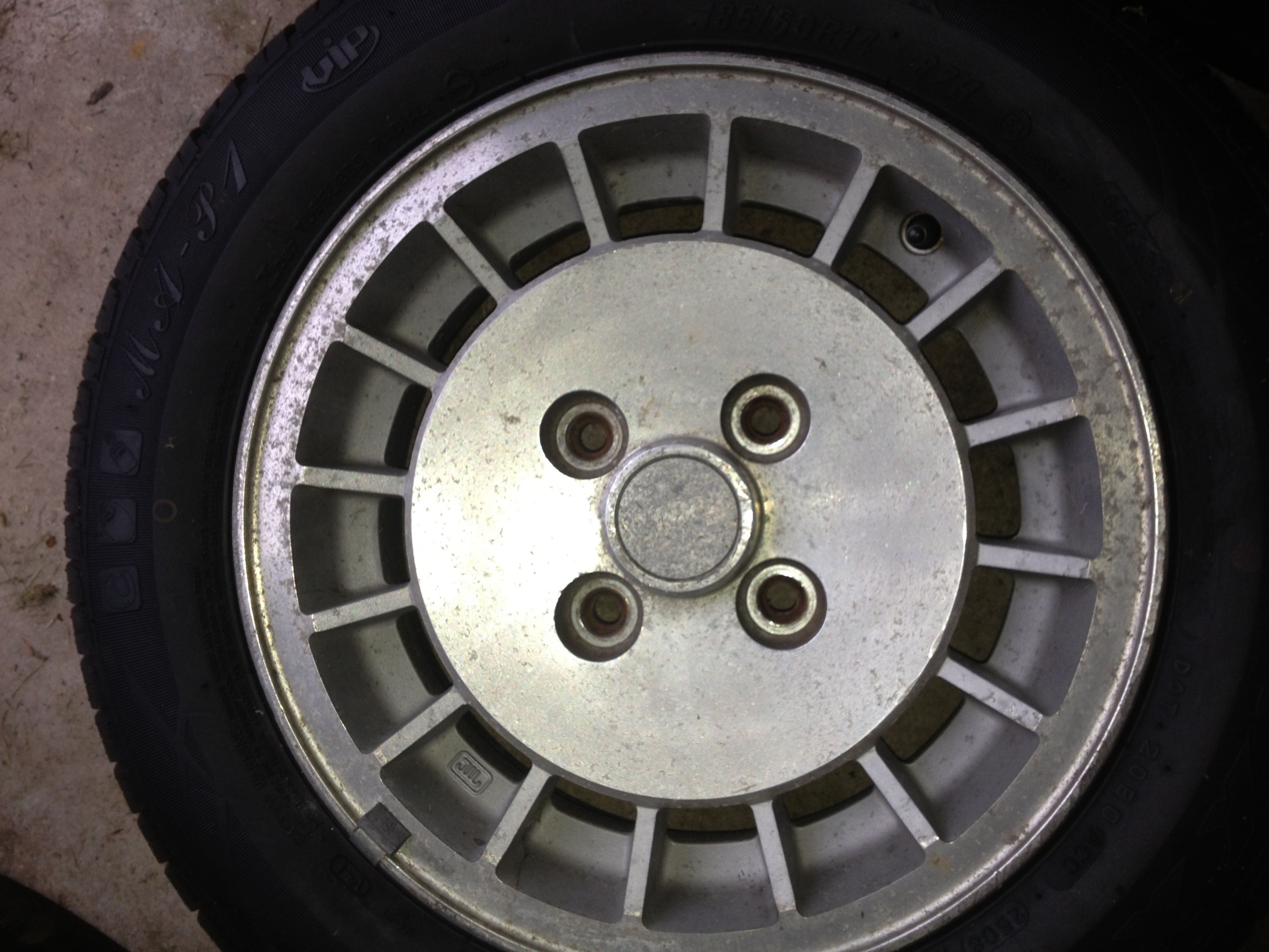

These are a set of Sigma GXE / Scorpion mags 14x6 I think which I know fit
As they where in Asroc when I bought her
J

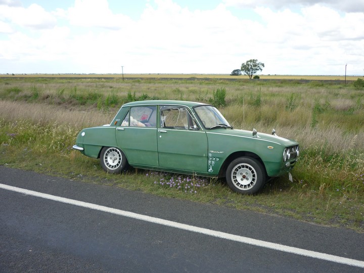

I have a set of scorpion rims too that I used to roll on (sitting up the back paddock now)
They were on the blue car I got from WA then put them on Donkey for a while as in pic en-route to my first Coona nationals.
Perfect fit and offset, ran 185/60/14 tyres on them.
