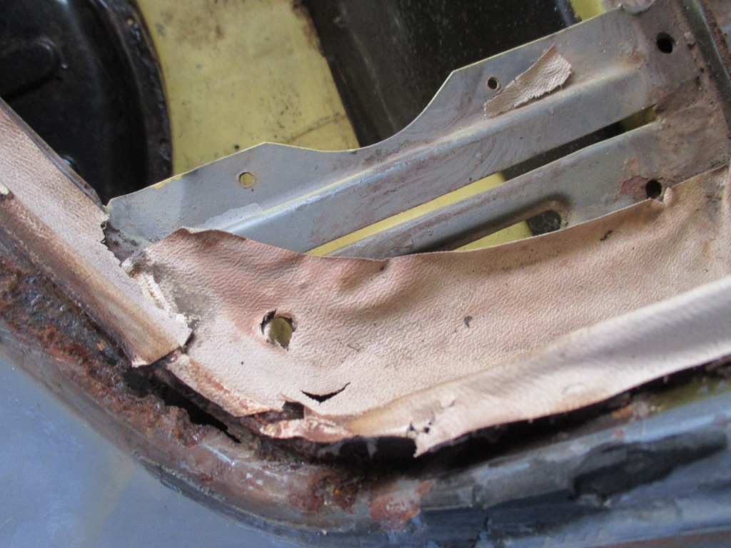

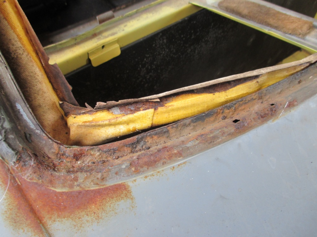

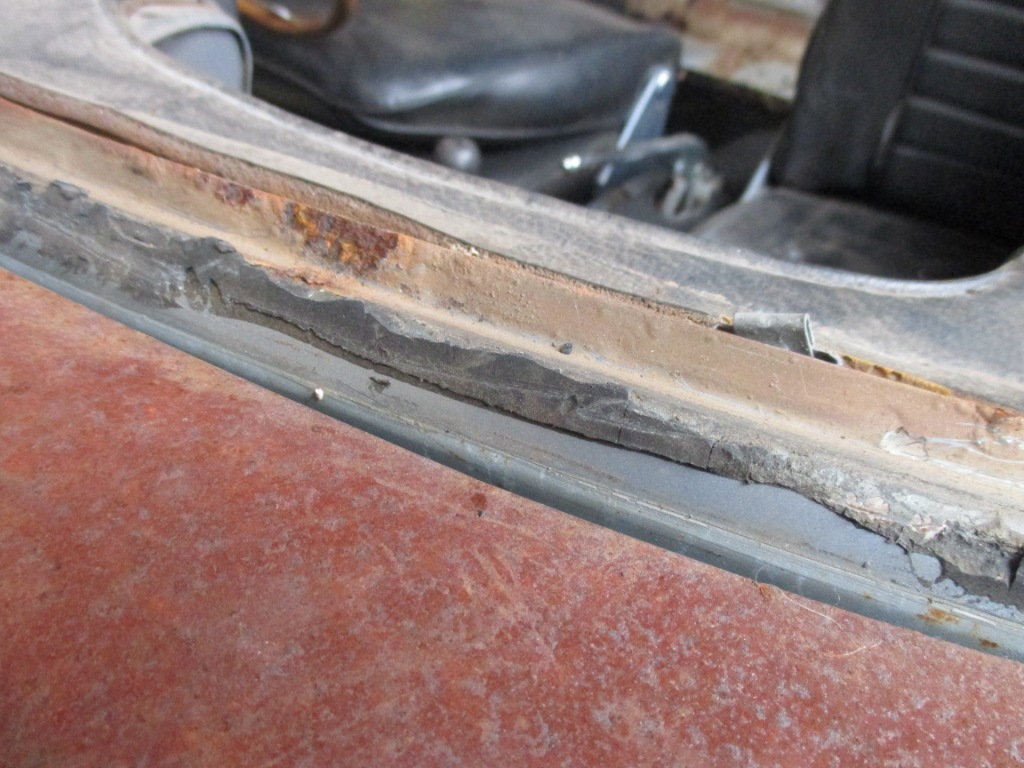

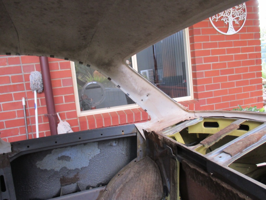

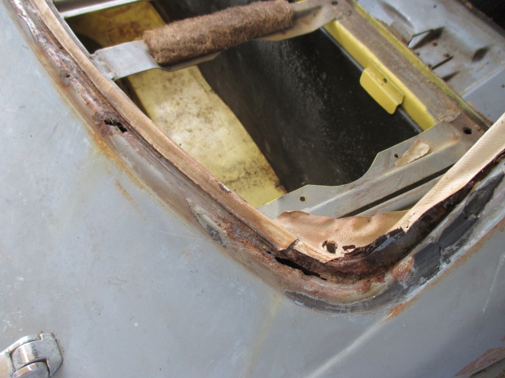

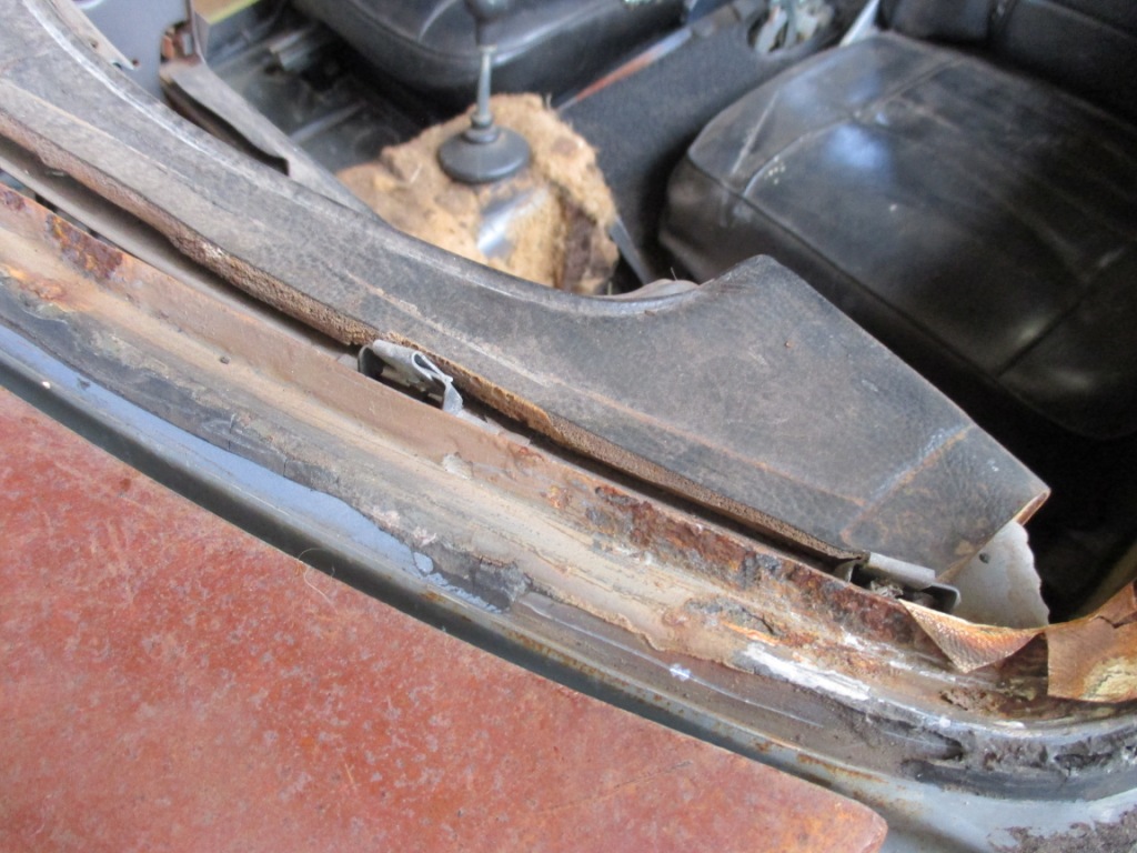

here are some pictures after the windows came out. Some of the original silver grey can be made out. Small amount of rust but nothing that cannot be fixed.

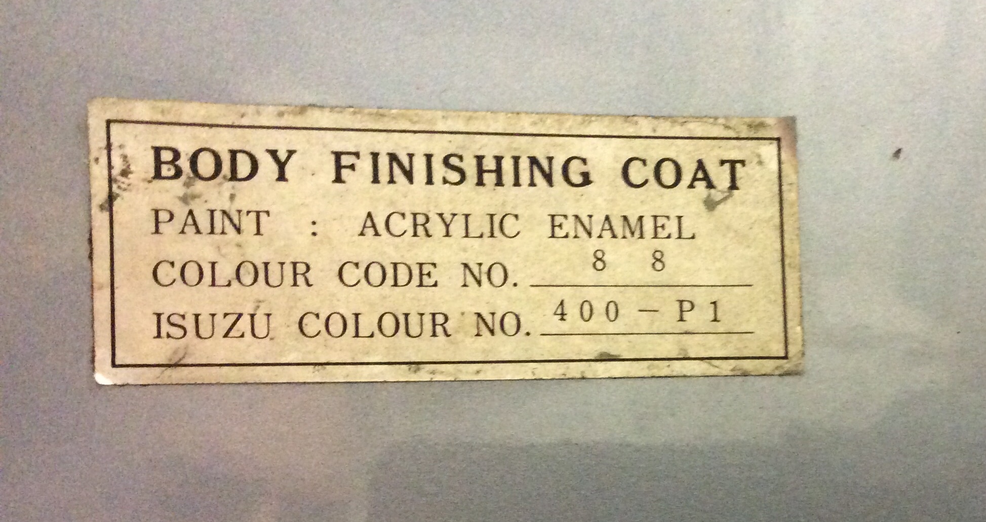

Excellent to see you working on such a rare car! Let me know if you need any specific photos of my PR90 Inside or out to help with its reassembly.
I have attached a photo of the original sticker under my PR90 bonnet ( that I carefully removed before its restoration in 1991 then reattached) showing paint code 0088 Silver Grey (as per the brochure of the 1967 Bellett Gt.. but same colours as PR90.....Isuzu White or Silver Grey)
It was repainted in Acrylic Enamel back in 1991 very close to the factory colour. I beleive the actual formulations for the paint codes were hard to find even back in the 90’s s, so a lot of matching by an experienced painter was done for our belletts and other Isuzu’s.
In 2011 after some areas of that paint job were failing and some bubbles appeared I bit the bullet and stripped the car of external bits then took it to my local panel shop who talked me into refinishing it in water based 2 pack. Not the best result for 2 reasons
1. The old repairs on a few panels, although isloated with the relevant undercoat still allowed moisture vapor to push through to create some bubbling in the flexible 2 pack layers.
2. The colour match of this 2 pack to the factory silver grey is pretty good in low light or the shade but under bright sunlight it does appear to be more silver.
I am still very happy with the even gloss finish it has after 7 years but I would definitely recommend to repaint yours in a solvent based paint .....steer clear of water based 2 pack!
I hope this helps. ;)
