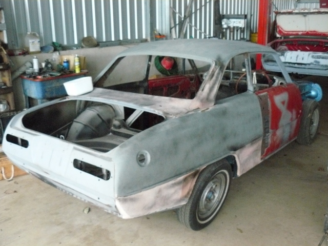

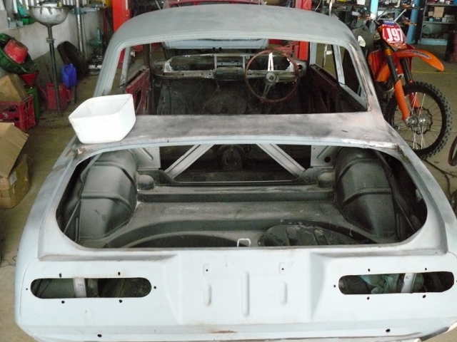

Farmer asked if i sleep? Liz will not let me now i have 19 weeks till this car is done.no 2 wedding car :shock:. as mentioned i have it for three weeks then its off to be painted.

i love all the stories we get on the bellett.net
those pics you have there GT orp are superb.
reckon the pic with half the side missing and the cold coffee sitting on the firewall plate is a classic.

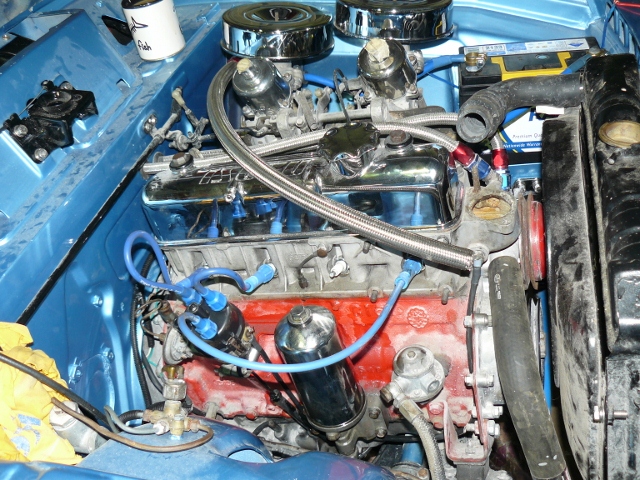

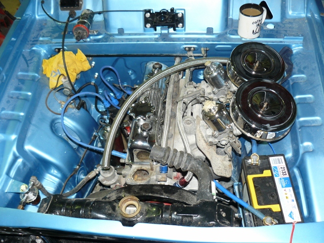

Ok oz some fresh coffee picks today, i got it running again. It still needs a exhaust,tail shaft back in later tonight when the paint drys and new uni joints fitted and its almost a driver again :D. I am waiting for the fuel bowls to come back as the chrome was a failure. I have a spare set in the meantime. The wiring needs a little more time for tidy up but the picks show it fully wired but a few point need retaining. The brake need bleeding again as they are a little spungy.
[the photo's engine bay is dirty mainly bog dust from the panel shop but i need to keep the body dry]
As for women issues it's more fun when you know your in trouble when you come in at midnight ;) . adds to the sport.

quick question. is that Holden Red that the block is painted as the original red of the GT block was a blood deep red as i have the original engine mount with the original paint that was used to match the paint i used for my GT block. (make some sense of that sentence!) guess it dont really matter if your not doing a factory resto anyway :)
hope the coffee was hot that time
