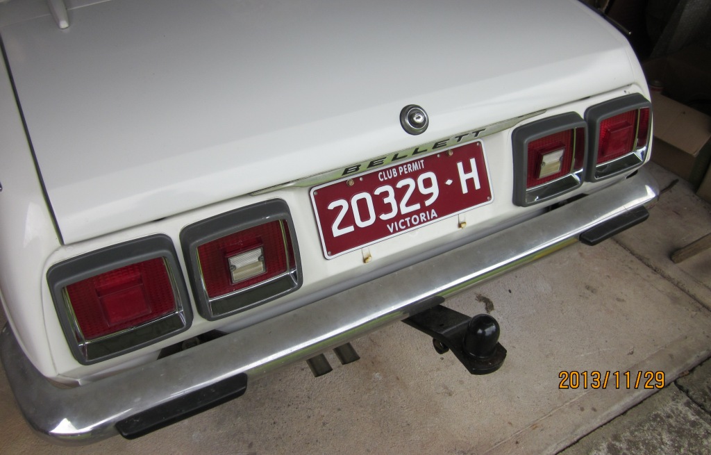

Small progress update. Chipping away: The tail light surrounds on the car are pretty grotty (chrome) and I have 3 brand new ones that came with the car. The new ones are different though, as they have a grey outer and chrome inner section. The originals are all chrome. Luckily, with all the spare parts, I found a reasonable grey surround one to make up the 4th light. In fact the only other grey one.
So today I fitted the four surrounds. Looks much better ! OK, no big deal, plenty of other things that need some TLC too. In looking through the NOS, also found front 1/4 window new rubbers. That was a ncie find but a fair bit of work to replace them, which won't happen for the all Japan day.

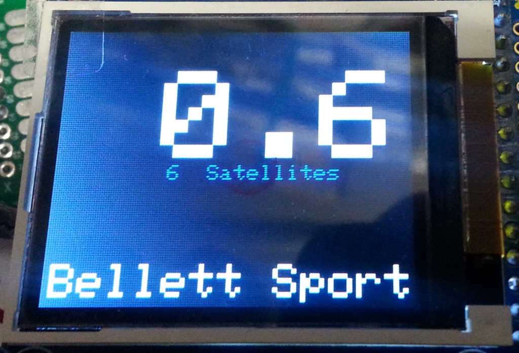

Next thing to look at is the Speedo and Tacho. I did fix the speedo's Odometer some time ago but the actual speed indication is way out. At 100kph indicated, actual is about 86kph. I wondered why all the cars were zipping past !
The tacho reads fast too. I have a spare instrument panel and will check it out, but in the meantime, my electronics background got in the way and I decided to have a fiddle with an electronic speedo, based on a GPS.
Most of you will be familiar with the GPS units with mapping display, but you can also buy the bare receiver modules (about size of a postage stamp) used in the GPS on eBay complete with antenna. (170979281074) They receive the signals but present raw data to an output pin. There is no display.
I coupled this with a small microcontroller (simple very small computer) called an 'Arduino'. These are easily programmed [in the 'C' programming language] to read data out of the GPS module. To display it, I used another eBay item, a tiny 1.8 inch (diagonal) full colour display. This is about the size of a std. Petrol gauge to give you an idea.
The picture shows the result with the display in kph. Colours will change too, over 100kph it will change to a red display. Final version may vary a bit from this. For example, it could also display RPM. Since the unit is sitting on my work bench, the speed shown is the static speed. Note that although people believe a GPS speedo is absolutely accurate, in fact it can vary by typically 2kph just as a GPS cannot be absolutely accurate in location. (unless you have the Military version) But its certainly more accurate than my current mechanical speedo ! Typically, the speed shown on a commercial GPS unit will be averaged over a number of readings. I will probably add this also later.
I won't be replacing the gauges in my Sport with this. Its just a way to verify speed when i either fix the current speedo or fit the spare one which is also unknown accuracy. But its a bit of fun.

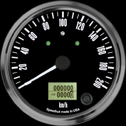

I found a GPS SPEEDO from speedhut.com which I will probably update with in the near future.
Have a look:
They can do just speedos or clusters with fuel and tacho, indicators and high beam etc.
They are custom faces with your logo and can do old school look or modern look.

Sun Mar 30, 2014 1:59 am
Have a look:
that's pretty nifty. If i was doing a new build, might be worth a close look. Lots of sizes and scales available also. That 400kph one might be handy !
But mine is just for testing, not primary gauge. And my cost is under $50.
UPDATE:- I compared the GPS speedo with the digital one in my everyday car. It (GPS) reads about 2kph slower at all speeds up to 100 which would accord with most manufacturers having slightly fats reading Speedo's.

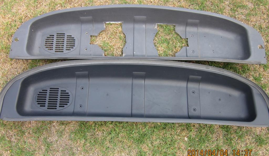

Another small update. Hope you guys don't mind.
The rear parcel shelf had some huge speakers in it when i got the car. The fellow who installed them cut big holes in the plastic shelf. Non-repairable holes. I got another one, also with some holes but smaller. Taped them on the back and filled them, then painted the whole shelf with a very close match vinyl spray. Came up pretty well all round. At least anything left in the back does not end up in the boot.
The radio that drove those speakers was a Japanese one of course with non standard frequency ranges so was tossed in the bin, leaving the original AM radio which still works fine.
