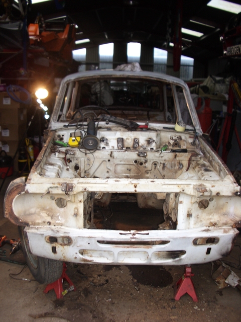

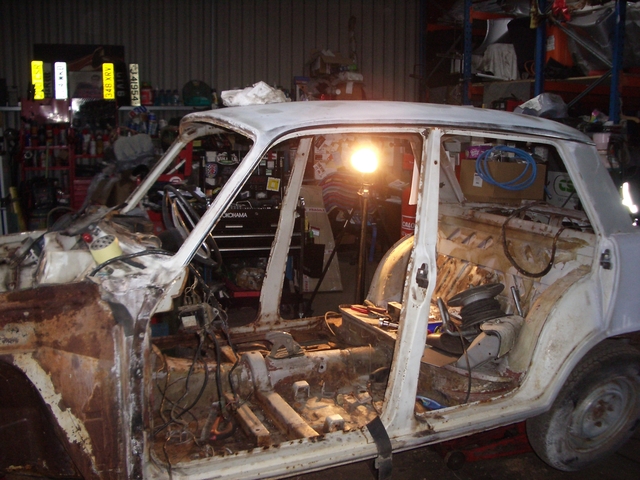

Have a look at the new lightweight Rollie. Pics taken at the end of last week.
Looks like me and Yellowperil are going head to head in a resto race.

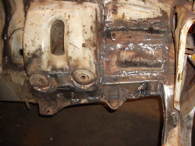

Apart from a massive and very ugly rusty spot around the engine mount under the battery tray (I expect you seasoned Belletteers have seen this before... it looks like a brilliantly designed wet mud/leaves trap) the rest looks pretty good.
Floor is now in and cage is being inserted. And fingers crossed we're still on schedule.

Looks like there are three cars in the resto race :?: i hope to have rolies replacement on the track on the 16 of march. I will post photo's next week ;). Mark there will be a panel packed to replace under the battery,the young fella that works for me cut it out with a oxy :oops: i would have prefered to unpick it. As you know time was a factor.

Yes, Greg we used the plate your bloke cut out, but sadly the old rust worm had eaten his way all along the chassis rail under the two round engine mounts and the other way in front of the rad. We used a few bits from the front cut and quite a lot of new metal, and we reckon it looks pretty sound now.

pretty standard thing in a bellett thats been outdoors for years these days pom.

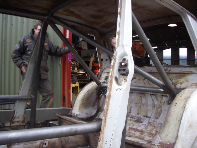

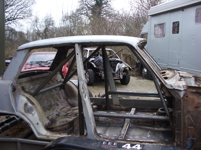

Posts: 490
Rollie is caged.
Off to spray shop today, hopefully photos next week.
