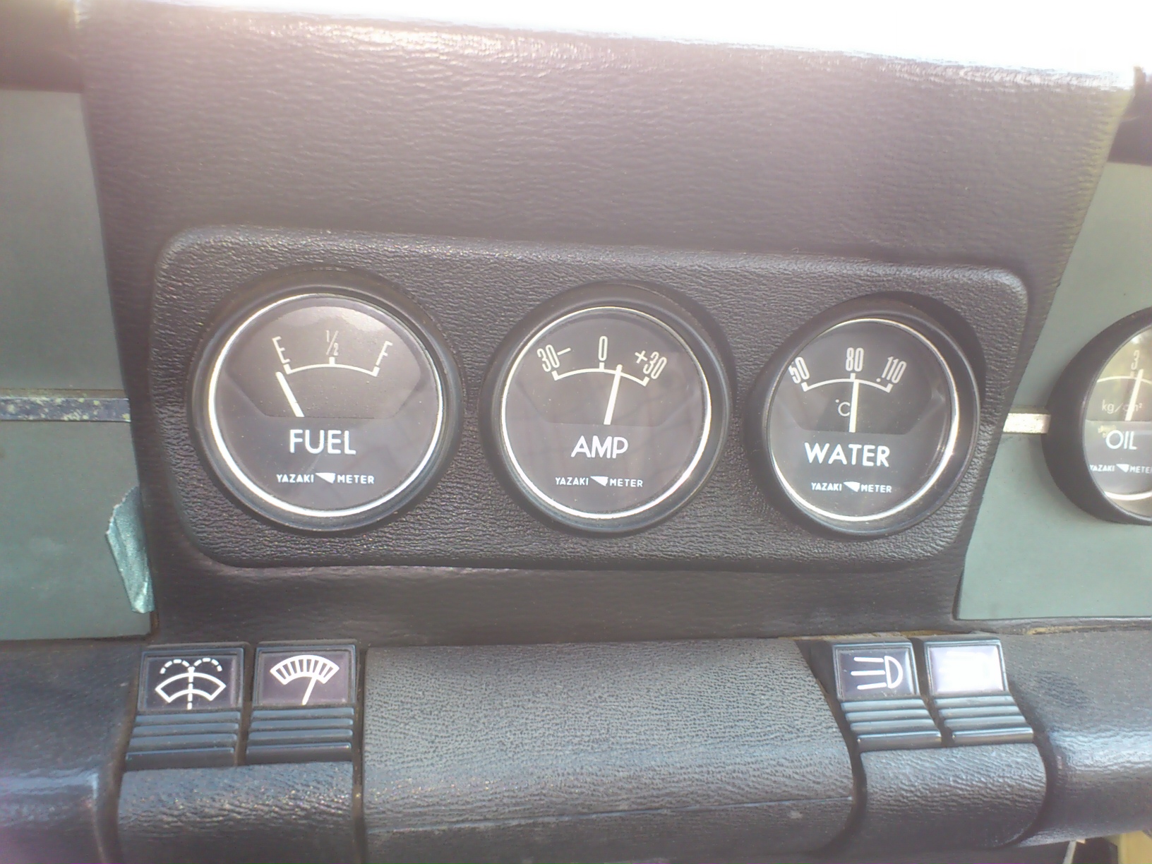

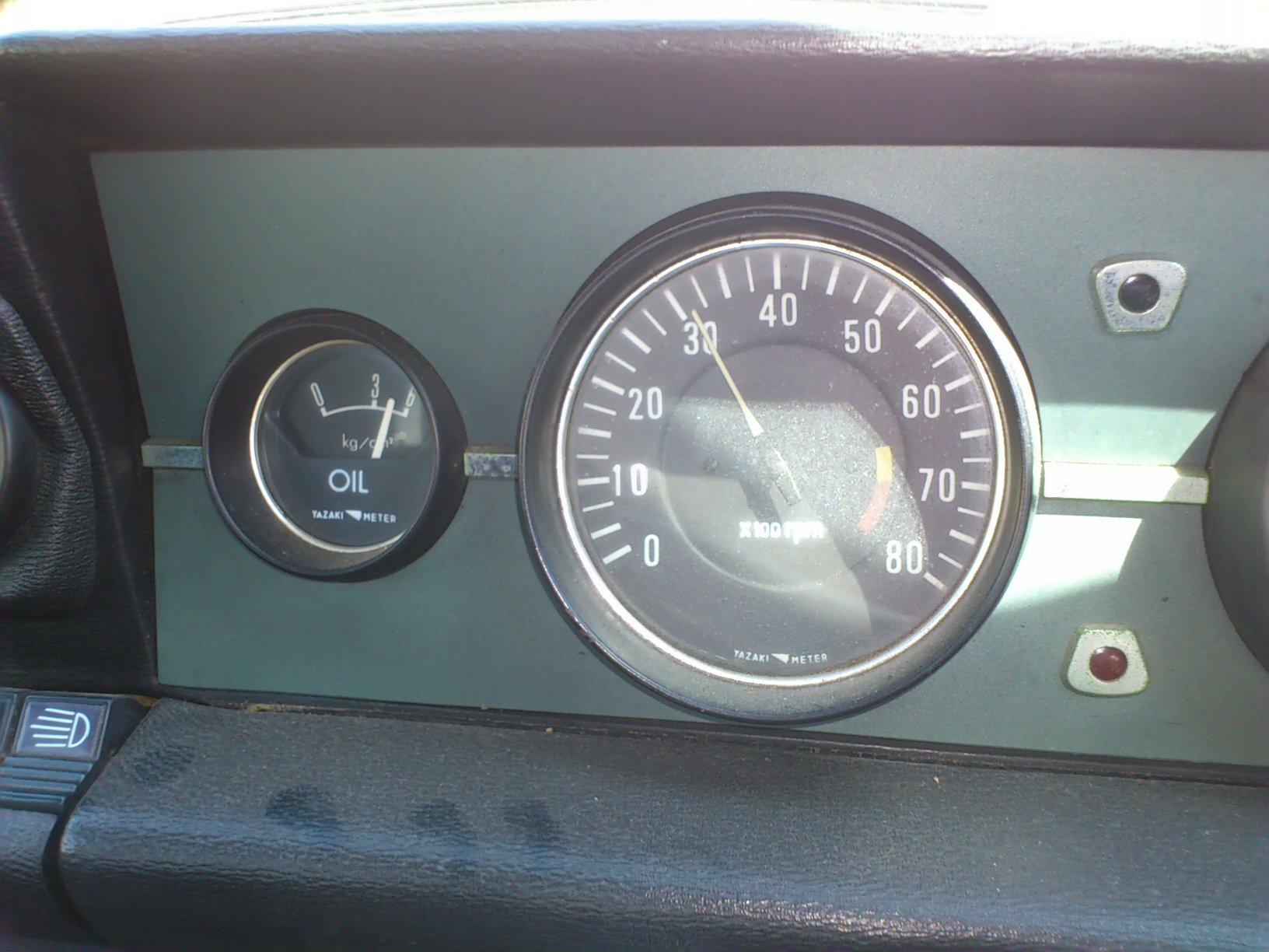

Music to my ears, engine runs ! :D :D
Fitted up the dizzy and coil from spare car, made some coil adapter wires, put in some 98 octane and new fuel filter, turned the key and she started up once fuel got up to the engine.
Carbies flooded initially but settled down quickly. Carbs obviously need to be pulled apart and cleaned etc but after a warm up she idles quite nicely. A little bit of smoke at rear on idle but none once engine is revving. Maybe rich at idle ? Choke stuck perhaps. Things to look at.
All the gauges work, (unsure of fuel gauge as only put in 5 litres) clock works, looking good so far. :)

Thu Oct 04, 2012 12:30 am
LOOKIN GOOD!! :D
Keep it going Glenn, sound good exhaust? ;)
Plenty of oil pressure!

perserverace Glenn, good to her she is running so well all things considered. instruments all look good and dash in good nick too
fule guage often take a tank or 2 to settle back into a "good" reading.
pretty exciting to have her running and sounding so good already
