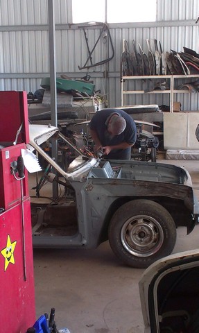

Without Greg availing and offering his workshop with hoist Donkey may not have had the rear end so extensively overhauled.
It's a bit hard to work and stay motivated when your working off a couple of small trolley jacks on the dirt floor of a carport that turns to mush whenever it rains so the hoist, workshop, company and hospitality mean more then a thank you and a hug can express.
Plus I learnt a few little facts and tricks when it comes to Bellett bums and Donkey asses :mrgreen:
The man himself in action

As Sticky said it was a fun weekend with a lot of laugh's. I am amazed we got all and more done than expected Russel said there is no way we can get what we planned done ;) we exceeded it :o . Adam has some tidying up to do now it will keep him busy for weeks and I had a reality check :idea: never start another big project :roll: and in the case you do don't let Russ have nothing to do as he stabs the car with screwdrivers and it messes with your head. I like to repair what I can see and then find the next repair but Russ likes to find them all at once so by the time you repair one hole we have another 10 waiting :shock:

Sorry Davo I thought you were talking about the car beside Donkey. No the car I was on is a gt it belongs to Adam, Ken and Carols son I wont mention surnames most can work it out. He is building the car on a limited budget with a few major structural issues. we did no panel work but replaced the a plllar that you could put your fist through :? Lizzies race car donated the piece we needed so it was cut out and picked back to three pieces and placed into the gt. The shock towers have 3mm plate now fitted and a huge amount of holes filled with weld where bit were cut out and holes drilled ect. While we were working on the car we noticed the sub frame was in bad condition so we rolled what was left of Lizzies car and cut the sub frame out and fabricated new sections from 3mm plate this was not planned for the weekend but a couple of hours grinding will see it done. I wanted to attack the floor pan below the rear seat and plate that to but we ran out of cutting discs :( But to be honest we were over it also.

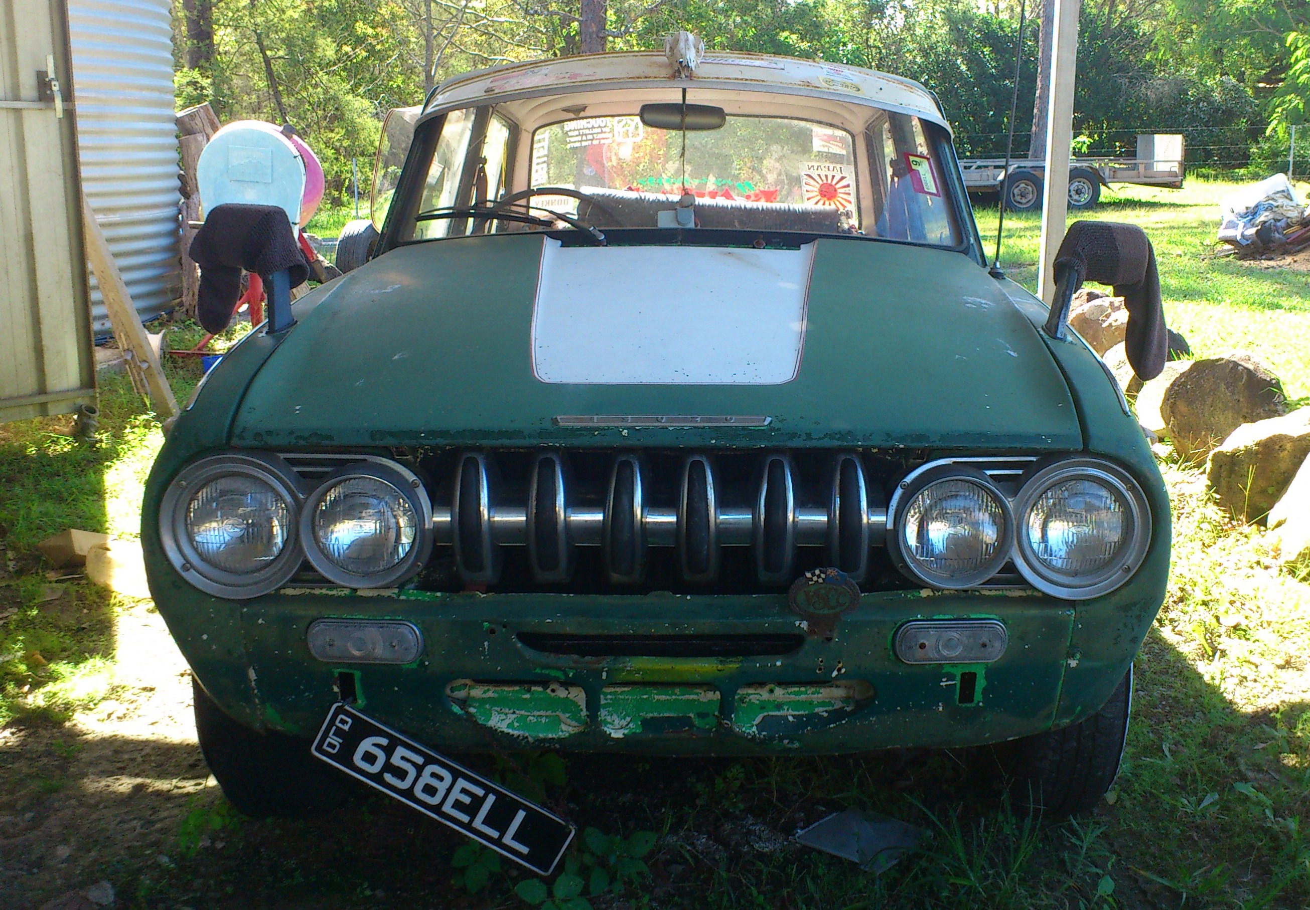

4. I need to make some brackets for his new grill :twisted: some will love it but many no doubt will hate it

That's the exact sort of shifter length I'm aiming for mrflibbles. My hand should just go under the mirror 8-)

As for the new snout, :?: :mrgreen: :?:
Mon Aug 19, 2013 11:14 pm
I tuff muzzle. :shock:
