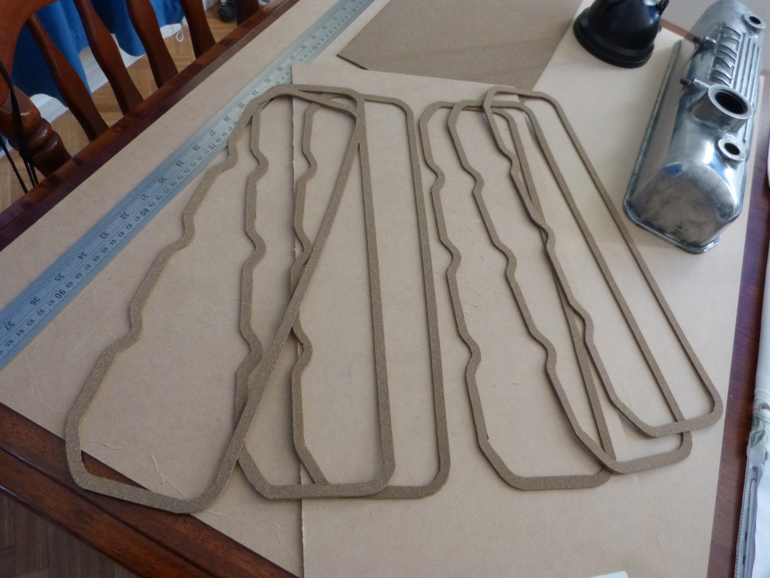

A quick update on the manufacture of the rocker cover gaskets. It had to be put on hold temporarily because of the unforseen trip to hospital. But I'm home on light duties and gives me a chance to knock out a few.
Claws loaned a rocker cover for the template, as i didn't think of tracing a few onto the gasket cork before getting my cover back on the engine...Doooh :oops:
I should see a few made by the end of this week i hope ;)
Sun May 25, 2014 10:28 am
GOOD ON YA MATE STAY WELL ..DONT OVERDO IT .......CHEERS DAVO
Sun May 25, 2014 1:01 pm
Well it's taken a bit longer than expected. Back to work, lots of life changes, and slow recovery from the Pancreas issue. But here they are. I have produced in total 7 tappet cover gaskets for the G161 engine, out of one roll of 2.5 mm gasket cork. And there is still enough left for a a sump gasket for Claws. I don't know if the sump has the same gasket thickness, i guess we'll find out. Gasket cork comes in 1.5, 2.0, 2.5, 3.0 and 3.5mm thicknesses, i think.
The first one i made was the roughest, and is on my Bellett doing a fine job !! So by the third one, I had improved and developed a technique in marking out and more acurately cutting the gaskets. It was a handy thing to learn.
OZ has already had his delivered and was surprised at the quality of it. And thanks Claws for providing the tappet cover to draw tempates, I'll deliver yours next.
So that means I will have 4 left. PM if anyone needs one, and i'll find a way of sending. I can always make more down the track.

what is the secret for holding the Cork while you cut it out?
usually the cork moves all around the place when cutting
Mon Jul 14, 2014 7:31 am
Great to hear from you also pa-man.
Glenn, no secrets here and willing to share what works. Gasket Cork can take some nutting out.
Three things are needed to make gasket cutting work :
1. the right tools
2. technique
3. method.
Tools: a craft knife is good and they usually come with a variety of blades. I use the scalpule looking curved blade as it gets into the corners cleaner and also cuts a straight edge well.
Find yourself a long straight edge like the ruler in the photo, and also a shorter ruler with mm's if you can.
A good ball point pen to mark out the template. Oh, good lighting and coffee, or 2 reds help. You also need a steady hand, a keen eye and paitients.
Technique: this partly answers your question Glenn, and explains part of the method.
Use the t/cover to mark out the width of your cork (length of the cover) to get a staight edge to work from for each gasket.
Mark this with the ruler and pen. Hold the ruler down firmly in exact possie and draw knife along edge, alot of weight is needed to keep the ruler exact and the knife bearing down through the cork and along the ruler. Then placing the t/cover exactly, trace around the exterior, the three rececess, the corners and the "back straight". Measure the inside line to 8mm by using short ruler by marking sighting dots. Still with pen mark many dots around corners, less in the straights. Then play dot the dot, hand drawing the curves and using the ruler for the straight bits. You should now have a template drawn.
Method: Using your keen eye and steady hand, cut all of the corners and recesses first, both outside and inside. Follow the outside line of the pen mark to ensure width stays ok. I push directly down on the tip of the knife and literally nibble around the corners with an up and down motion using the edge of a finger from the other hand as a guide. Once the corners are cut right around to the next straight bits, use the ruler and firmly hold down along the straight lines drawing the knife firmly and slowly from one curved bit to the next. You should feel when they meet the already cut curves and break away, hopefully cleanly.
To summarise your question Glenn, its all about where you start cutting and where you finish. I found the more intact you could keep your template, the less movement you would have. But it also requires you to bear down hard on the ruler to keep things in place.
So, do the corners and rececess first. Then do the staight bits from the front of your main piece of cork, cutting the recessed edge first, then the side bits. Then cut the inside line of the back staight, so the centre piece of cork pops out. Then your last cut is the outside of the back straight to finally severe the gasket from the main piece of cork.
Now have another red and.... REPEAT THE WHOLE BLOODY PROCCESS :P Siiimples ;)

Thanks for the detailed method. Sure works well. The wine helps too by the sound of it. A practice one also I imr.
