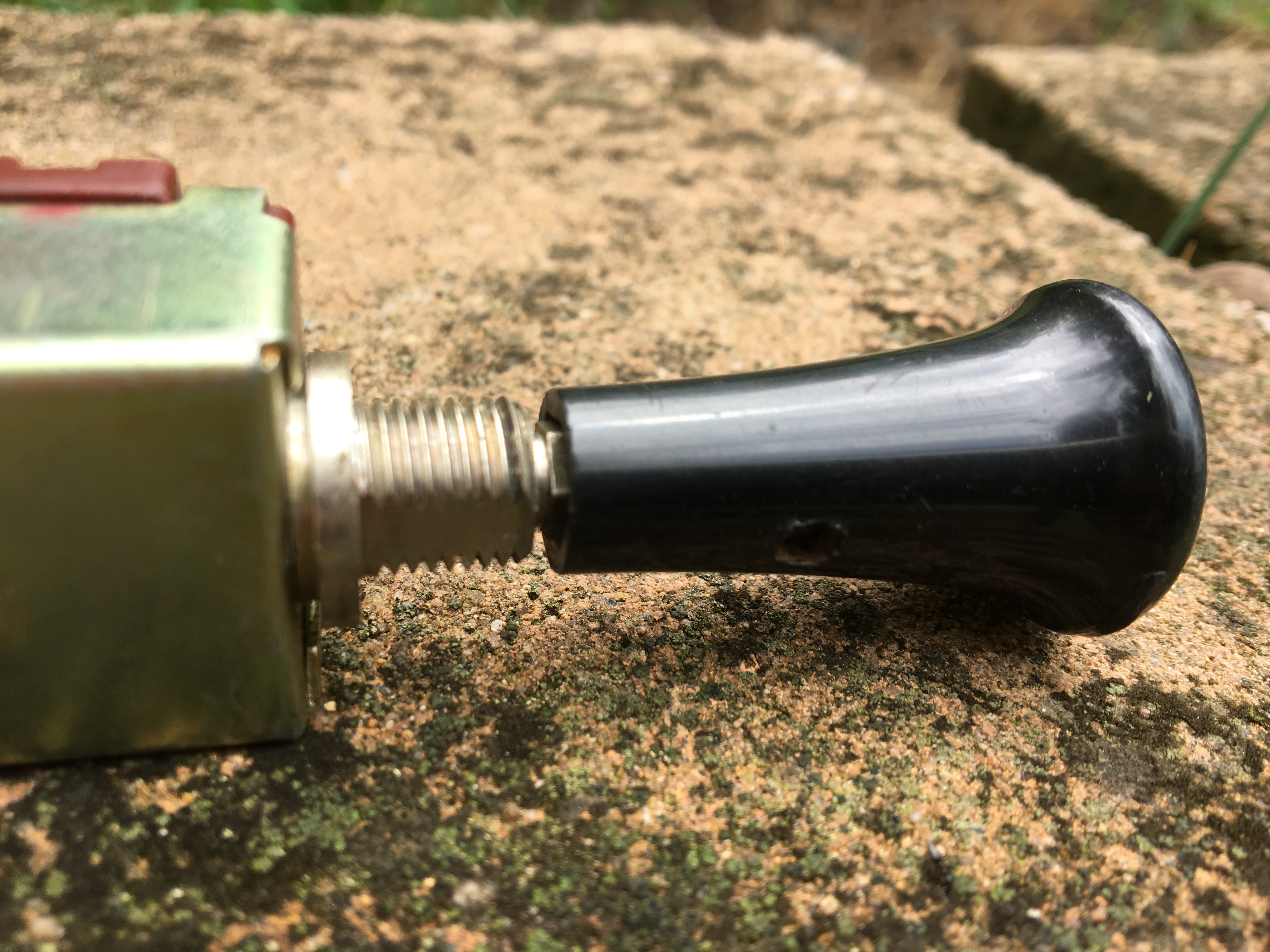

Every time I visit the garage, I seem to find another problem or some. Today I discovered, that one connector on the light switch is broken. That caused the heating. How to remove the light switch plastic knob? There seems to be some kind of a brad in the knob, but I couldn't figure out, how to remove it.

BULLITT wrote: its easy ..................... Not very helpful... Any hint how to get the brad out?
_________________ The only Bellett in Estonia
| Thu Dec 21, 2017 9:01 am |
BULLITT
push the little button on the side under the front of the switch I will take a photo tomorrow for you all is good ..cheers dave
| Thu Dec 21, 2017 10:25 am |
67GT
Joined: Sun Jun 14, 2009 8:44 am Posts: 348 Location: central coast
Hi Bellett EST On the bottom of the switch knob there is a small pin that holds it on. Just press a fine tool ( screwdriver or drift etc ) into the hole and gently pull the switch knob out. Unscrew the chrome ring and the switch will pull through the dashboard toward the front. Hope this is a little more helpful. Regards Warren
| Thu Dec 21, 2017 12:26 pm |
BULLITT
good to see the bellett spitit all helping ..merry xmas
| Fri Dec 22, 2017 12:06 am |
BULLITT
The push in clip is the same on the wiper switch. A nail or sharp object. Pushed in and wiggleda bit then as abivescew it out cheersdave

as warren said push into that hole and pull off the plastic piece with L see how you go on it

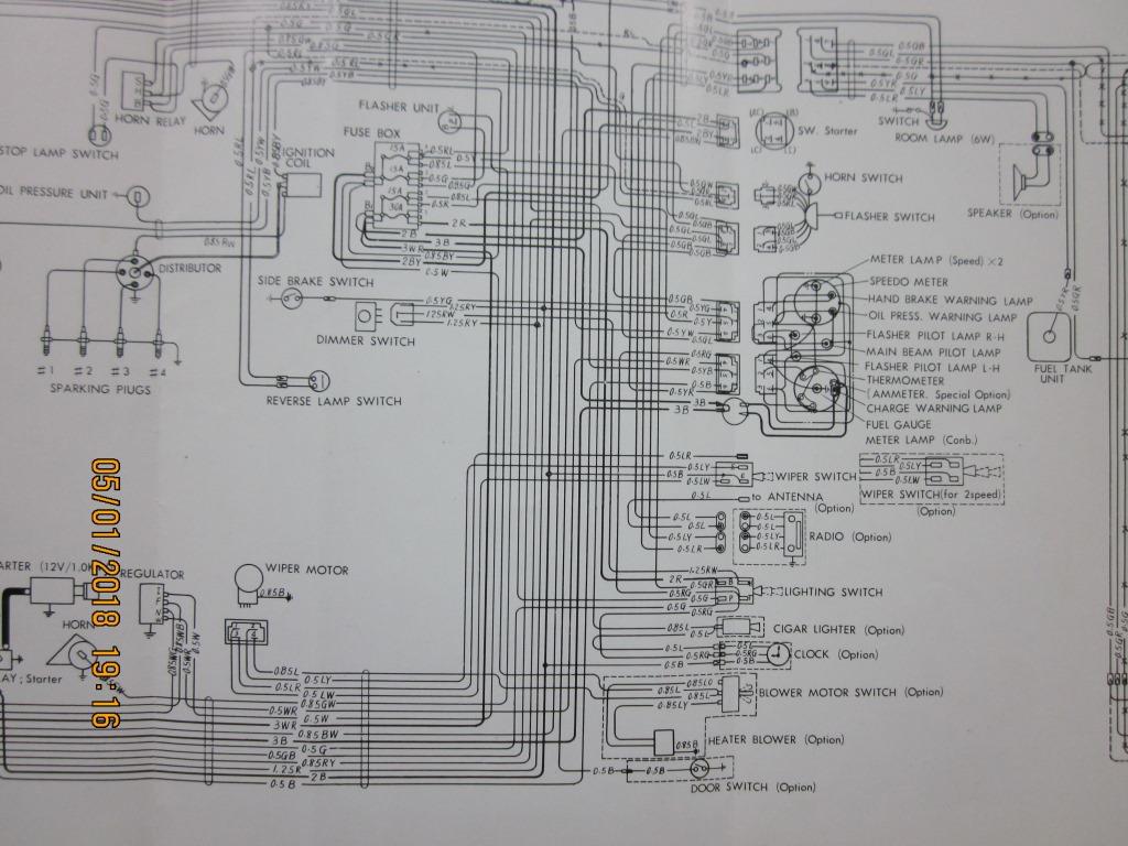

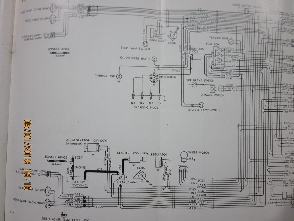

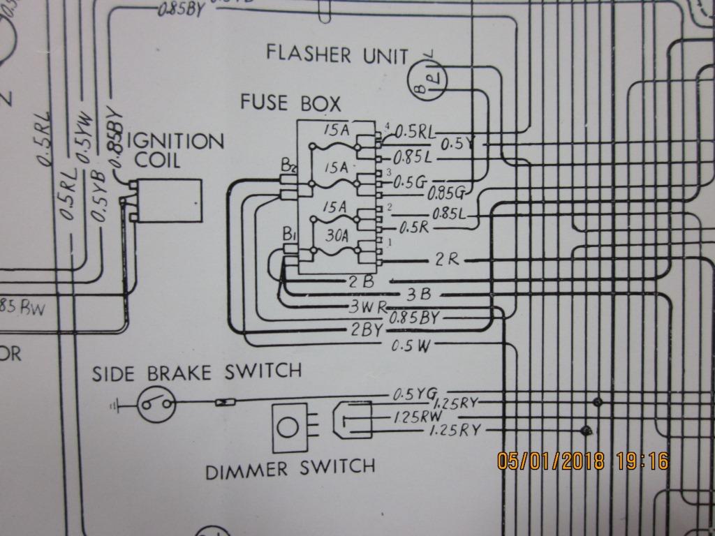

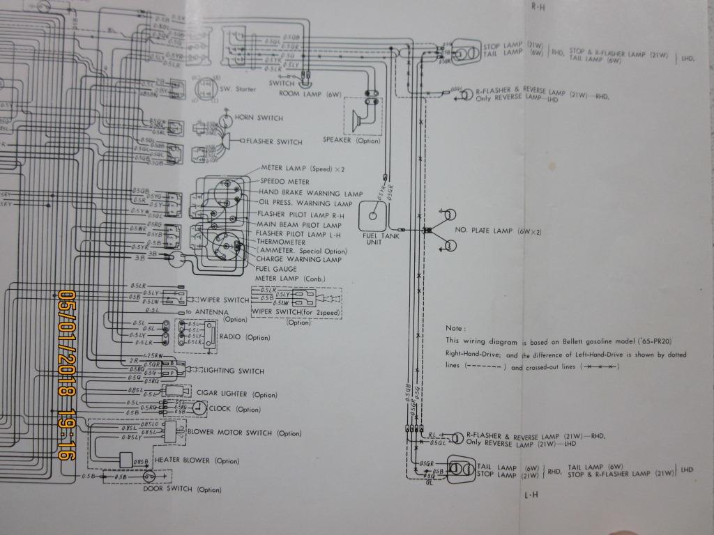

Could anyone share the electric chart? And also - what are the nominal amps for fuses? I don't know if I can find same size fuses (6,3x30mm?), but I suppose they can be replaced with 6,3x32mm. One of the fuses seems to be original, 52 years old and working. It has some kind of Isuzu logo inside.
| Thu Jan 04, 2018 8:09 pm |
Joined: Tue May 10, 2011 2:23 am Posts: 2826 Location: Melb.
| Fri Jan 05, 2018 9:20 am |
Bellett_EST
Joined: Tue Oct 10, 2017 8:41 am Posts: 75 Location: Tallinn, Estonia
Thanks for the wiring diagram, got what I needed.

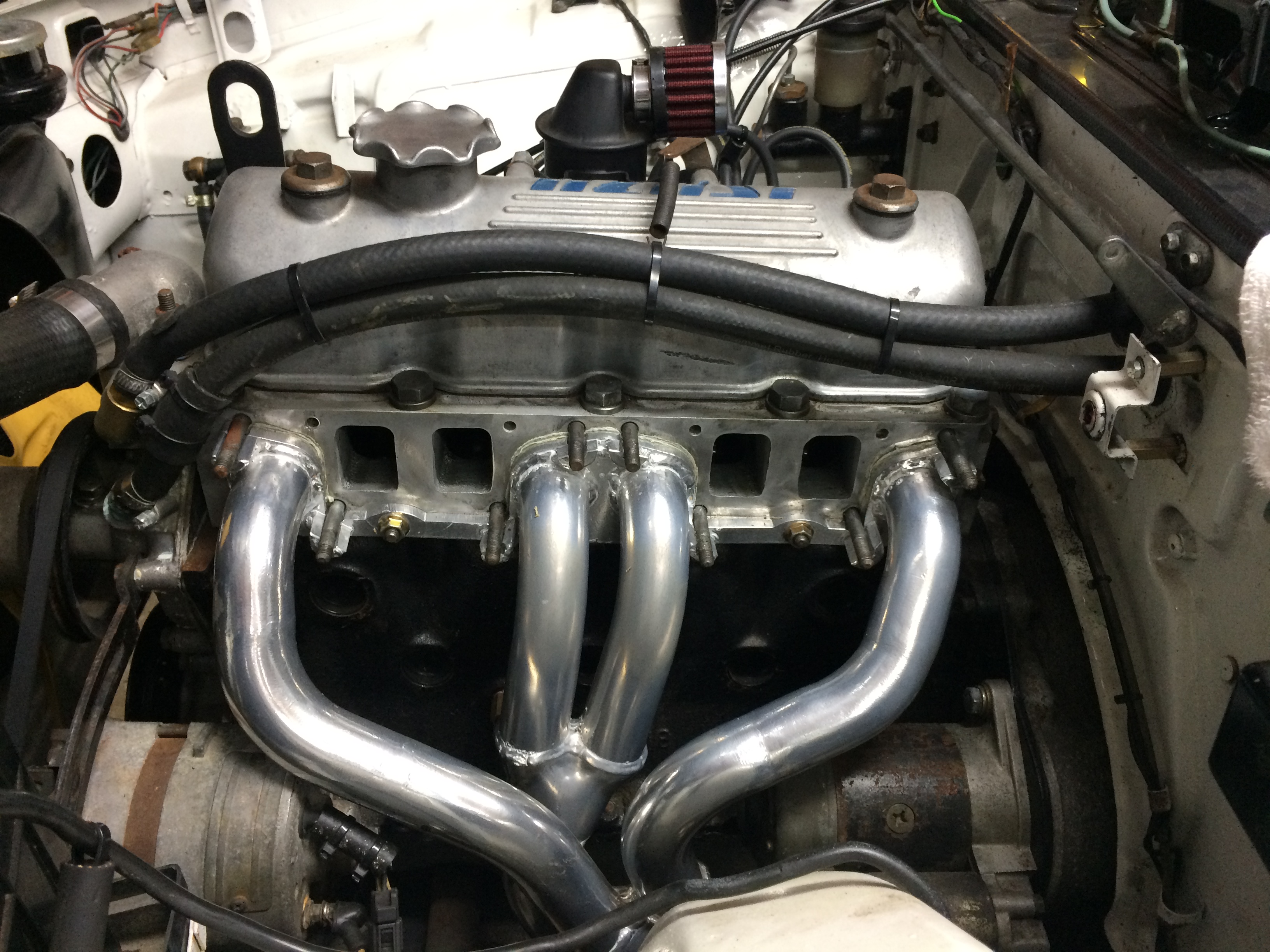

Another problem with the cabin heating unit. It doesn't blow any warm air into the cabin and the hoses seem to be empty. Is there some tap or valve for the cabin radiator? There is some kind of a long screw on the water pump, does it close the cabin circuit? Tried to turn it, but it was stuck.

Hello there. The long screw is the tap, if the hose runs to it. The fitting in the water pump is the outlet and the one in the head is the inlet. Try disconnecting the hoses to see if coolant flows from the pump. If the tap is siezed, take care trying to free it. It is often impossible to remove the tap from the pump as it welds itself in there.(Annodising siezure) I once broke the housing of a good pump trying to remove one, and the car was only 11 years old! If coolant flows, I would put new hose on and an inline brass tap. I have done this on my Florian as the tap is frozen open. I have to open the bonnet to turn off the water, but its not very often needed.

Another question about the cabin heater. Could someone explain the lever positions, the labels on my car are in such a bad condition. The right one moves the air flow (floor or window), the left one should be for temperature adjustment I suppose.
The water from the pump goes up towards cabin heater, but the pipes behind the heater unit are bit blocked. I'll try to set them better, hopefully it will bring some heat to the cabin.

Hi from Tasmania Well we are the coldest state here in Tassie though nothing like you so I run a constant flow through my heater As you can see in the photo with carbies removed Top hose return to thermostat housing on head Low hose feed to heater from water pump Traditional there is a manual turn brass valve at the head Some remove and retro-fit an inline valve either manual or cable operated Regarding levers I just move till I get what's needed where needed Cheer J
