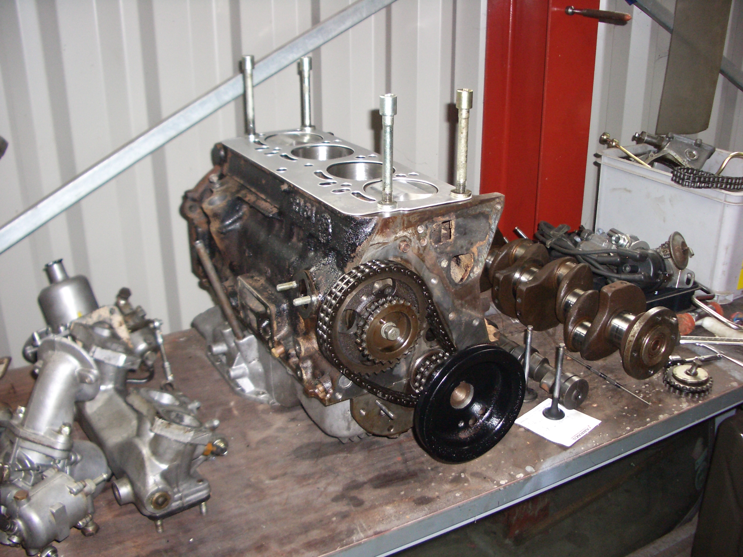

UK calling.....just to let everyone know we're still here. The engine build is proceeding at a positively glacial pace. I suppose after the massive effort to get the car ready for Goodwood we've taken our eye off the ball since then.
But we've got all the clever goodies in the block and it's off to the machine shop again this week, before (hopefully) a final reassemble.
Our revised aim is for the final race of the season, at a little circuit called Mallory Park (where I began my racing career).
In the meantime I've been able to follow my other passion......cricket :shock: :(

nice lookin dome top poking out of the block there, Pom!
bet she will really run hard and sweet once all back together.
love the photos, just keep them coming on in.

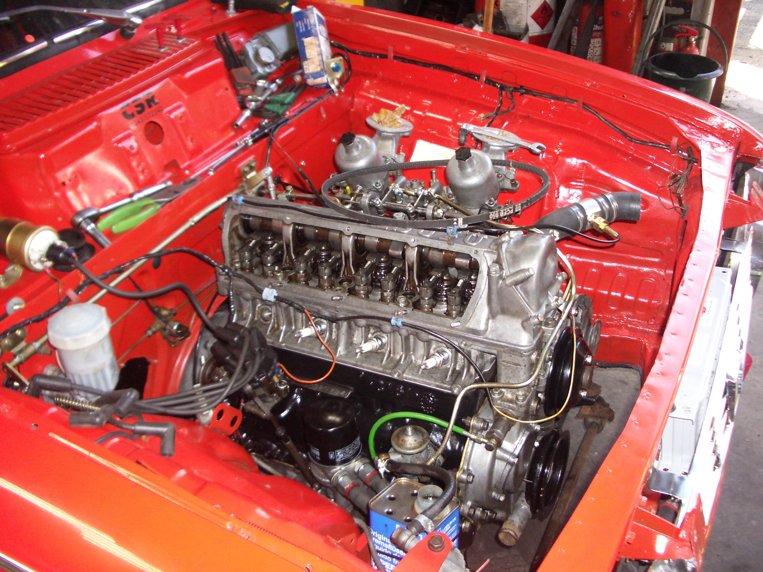

Well, at last we have the engine in.
We haven't lit the fire yet, I might give my clever new 'in car' camera a test and see if we can post some sounds this week when we do.

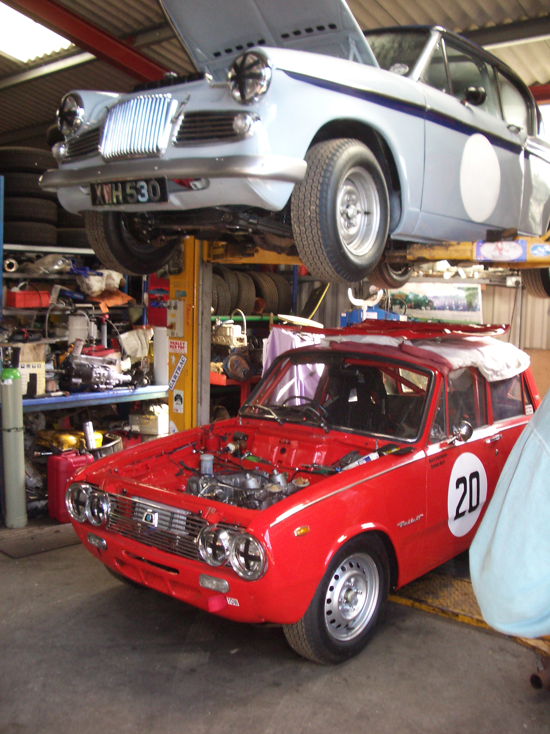

Above Rolie is Harry Sherrard's Rapier being fettled for this years Revival, he's sharing the drive with ex F1, Indicar, Le Mans star Derek Daly.

Nice to see that engine back in the car again, Mark.
I hope you get 2000hp from it....... well at least the hp you were hoping for !

Mark, what have you done with the chain tensioner. You have a pipe going into it in the picture.
