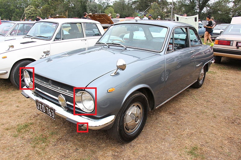

Hi guys...I'm back
The Bellett was in pause mode, I was finishing my 73 Toyota Celica TA22 restoration. The Celica is now ready for the roads
Now is Bellett time
Meanwhile I bought some parts for the Bellett through the years...but I'm still looking for some parts, can you help me?
I'm looking for the front blinkers and the headlight trims.
Thanks guys
Now is Bellett time
Thanks guys

Re: 1967 ISUZU BELLETT GT
Both of those items are very rare to find as spares.Earthp wrote:Hi guys...I'm backThe Bellett was in pause mode, I was finishing my 73 Toyota Celica TA22 restoration. The Celica is now ready for the roads
Now is Bellett time![]()
Thanks guys

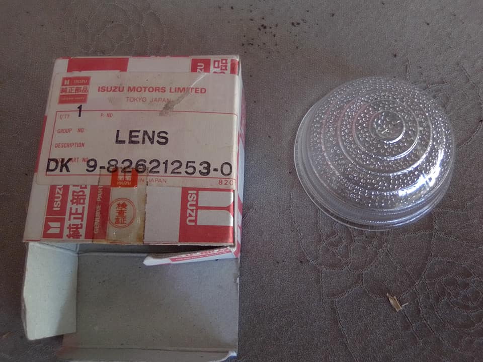

Hi
I have clear copies of the beehive lens but not the metal surroud
As Glenn has said the headlight surrounds are very scarce
Flying
Flying

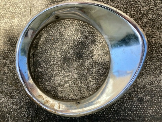

Maybe I'll try to make metal surround replicasflying wrote:Hi
Flying
I believe that the most import thing to find now is the headlight trims, because I have the front grille but the trims are missing
I have a set of the beehive (GT) lenses for sale. PM me or go to classic isuzu on Facebook.
Morris 1800 look similar, maybe they can be modified to fit?
I didn't knew this Morris 1800...they really look similar. I will try to find the Austin trims.50 Bells Bellett wrote:Morris 1800 look similar, maybe they can be modified to fit?
I have both types, the Bellett ones are pressed alloy and tend to get banged up a bit but the Austin ones are cast then chromed. The Austin ones ar a bit deeper too and in my opinion look better, much better quality but totally different mounting.
I am actually using the Austin ones on my GT instead of the original Isuzu ones (which are a bit beat up anyway)
