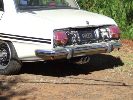

i love the paint you have lovingly aged so well! you are going to devastate me when you paint the beast!
Sat Jan 23, 2010 8:59 pm
seriously luv it rob!!
when i posted the pic of my sedan that had the stripes, i honestly thought u were going to repaint the car and do the stripes as a new resto type of thing.
but this patina idea is even better!!
you've done well!!
a suggestion tho... i'd do the window frames and "B" pillar the same way. i think the white looks out of place now. the GT-R had them black as well, so it'd suit nicely.
and yep, maybe PR20W would suit... gav has the word on it!!
Sun Jan 24, 2010 3:38 am
LOL, as I posted elsewhere, I ran out of masking tape ... the frames and pillars are next.
Until the car gets the bodywork done I thought clean new black paint was way out of place so ....

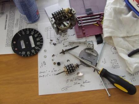

oh, speedo is out, trying to fix the tripmeter, cable to come out next and be cleaned,

Speedo !? Well I'm borrowing a GPS while I pull another one apart (thanks Chris).
Need to get some trip wheels to replace the ones that don't work anymore.

I'll see how I go with the reassembly, it just won't have a white wheel for the tenths of miles.

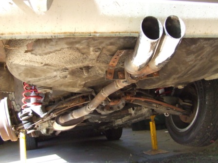

Well, I couldn't fix it with a hammer, so my alternator problem is electrical ... dang it : (
Good news is that the exhaust is on ...
FRUSTRATION !!!! trying to weld paper thin rusty exhaust tubing !!!!!
Looks cool though. The final product while not as pretty as a professional shop wood do it will suffice for now.

Thats some tricky welding, Rob!! You must have a nice gentle MIG. One thing I don't like is exhaust work - always seem to get bits of rust in my eyes! I'm taking betty to Young to get a new system from the extractors back as there's nothing there at the minute. Could be a noisy trip! Oh well, only 70 k's! Bam balaaaaAAAAAAAAAAAAAAMM!

Yeah, too right mate. Those curves are usually done with a bender on new tubing. Yours is a piece of art, Rob. How many sections ? :o .

Yeah guys, the mig is a gas-less hobby one I picked up in Longreach a couple of years ago. You just gotta get the right wire to make it work. Not all wire is created equal!
The exhaust is a bit of an illusion, as it is only four sections. The first part is the original exhaust cut up (into 3 pieces) and realigned to go past the diff and spring. The rear section was a piece of straight that I ground some slots in at the appropriate places, bent and then welded closed. Would have loved to make one out of new pipe with a bender, maybe later (Might also use a bit smaller pipe and tips, twin 2 and half inch outlets are a bit of overkill- free though, thanks Paul).

Well how time flies.
Drivers side window frames and B pillar to sand back, passenger side front door and guard left to sand.
Still waiting on rack rubbers and finish assembling the speedo.
