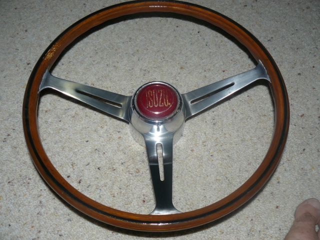

A new dash pad is fitted and the airbrushed woodgrain dash is ready for pick up tomorrow. I finished the steering wheel today.

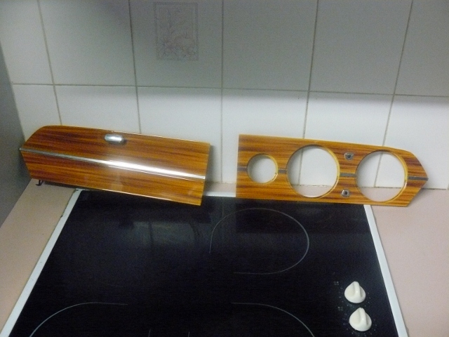

I had the dash panels out of the convertable that were in the weather for over 20 years and gave them to a guy that airbrushes to see what he could do with them. The reason he got the stuffed one is that if it was a failure it did not matter.
The end result i am happy with the next set will be darker as this was a practise run. We all know what happend to the experimental horn button :cry:.

oh they look real nice, very sexy indeed!
Wed Apr 18, 2012 8:38 am
KEEP THAT DASH AWAY FROM THAT HOT PLATE ...REMEMBER THE HORN BUTTON WENT IN ITS BEST FRIEND ................AN OVEN ...HEY THEY LOOK BLOODY GREAT CHEERS DAVO

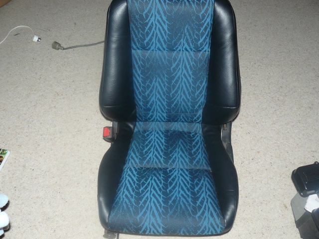

front seats are ready rear is well underway.

Ah mate, thats intrestin, thats diffrent, thats noise!
Seriously, it's good to see some unconventional fabric. That'll look great in.

Now that seat is nice and neat - great shape too!

Yeah, and they are heated as wel :mrgreen:
See the plug behind them... Damn! gotta install an inverter now.

seats looks good ,,,,,not orignal ,,,,but still look good
Tue Apr 24, 2012 10:05 pm
mate i just checked the photo of your chair .....come on greg surely thats not lizzies chair have a look on the lhs is that the lead that goes into it ? ZZZZZZZZZZZZZZZZZZ CHEERS DAVO ANOTHER GOOD JOB UNDER WAY

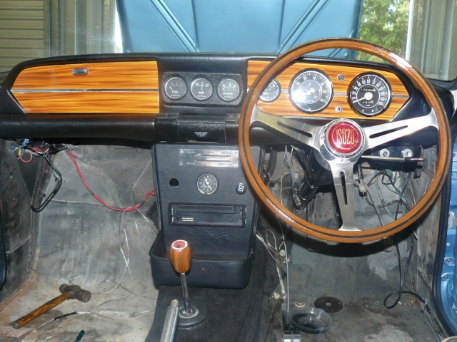

a step closer the console is not bolted in and the speedo panel only sitting in place to confirm wiring is all good.

Fri Apr 27, 2012 3:20 am
hey greg looks great...dash is unbelievable ....the wheel what did you stain/varnish it with ? and how many coats with rub backs in between im getting up to that stage cheers davo
Fri Apr 27, 2012 3:31 am
Davo lots of sanding 400 wet n dry/ dry we want the wood dry. glue any loose ends 400 w.n.d. i put a stain on mine but you need to get back to bare timber. The second wheel i did was 2 coats of clear before 1500 w.n.d wet. The 1st wheel i had a couple of rub throughs and had to re stain these bits it. After then each coat 24 hrs apart i did seven coats the last coat idid 1/4 of the wheel dipped the brush in turps ans redid the 1/4 gave a smoother finish.

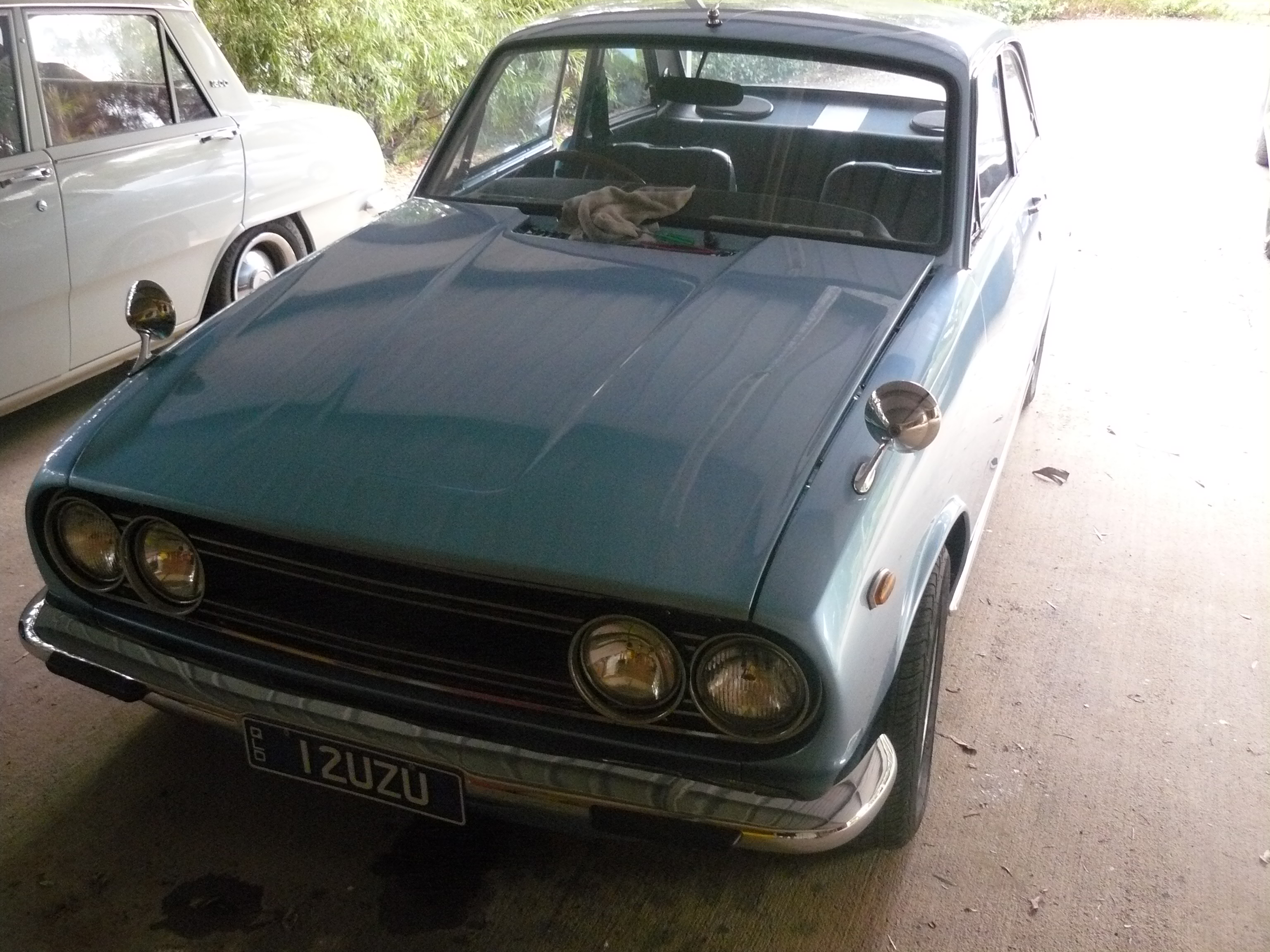

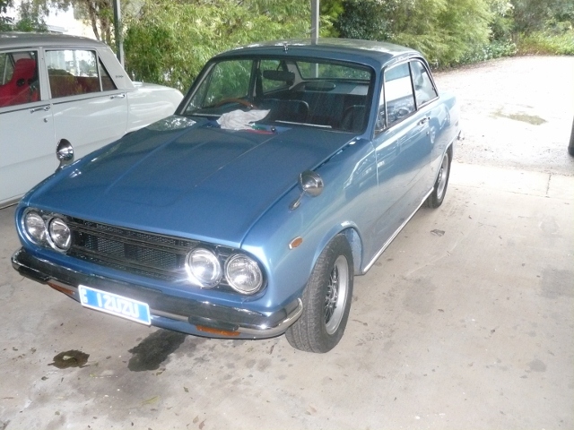

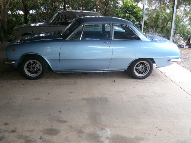

Patches is done he was wheel alligned today and rwc is underway club rego is being done he will hit the streets next week i hope. i no longer have a gt on the road :o . ol yella is waiting for chrome and it's done too.
My next gt croooooze will be in blue.
