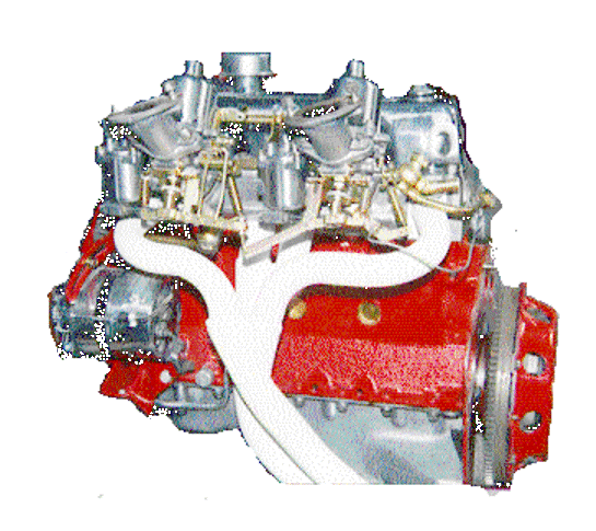

Mark, I don't have the GT anymore so can't post a detailed picture of the rear of the head and pipe. Somebody else should be able to take a closer picture than this.
This is the OHV motor so may not directly translate to the SOHC head. I have no idea of the water passages in those engines.
The pipe uses Bundy fittings and runs out of a tapped insert in the rear of the head to the inlet manifold. The pipe as then electro plated. You should be able to just observe that in this picture of my previous GT's engine.

Yes, i realise that, but idea is the same. I tried to take a picture of the rear of SOHC head but it's too tight in there to see anything. It does not have the pipe of course so Mark will have the same view as I do anyway. He will need to ascertain the water passages to see whats possible.
In the OHV, that pipe goes to the inlet manifold water passage. Visible in my GT motor above.

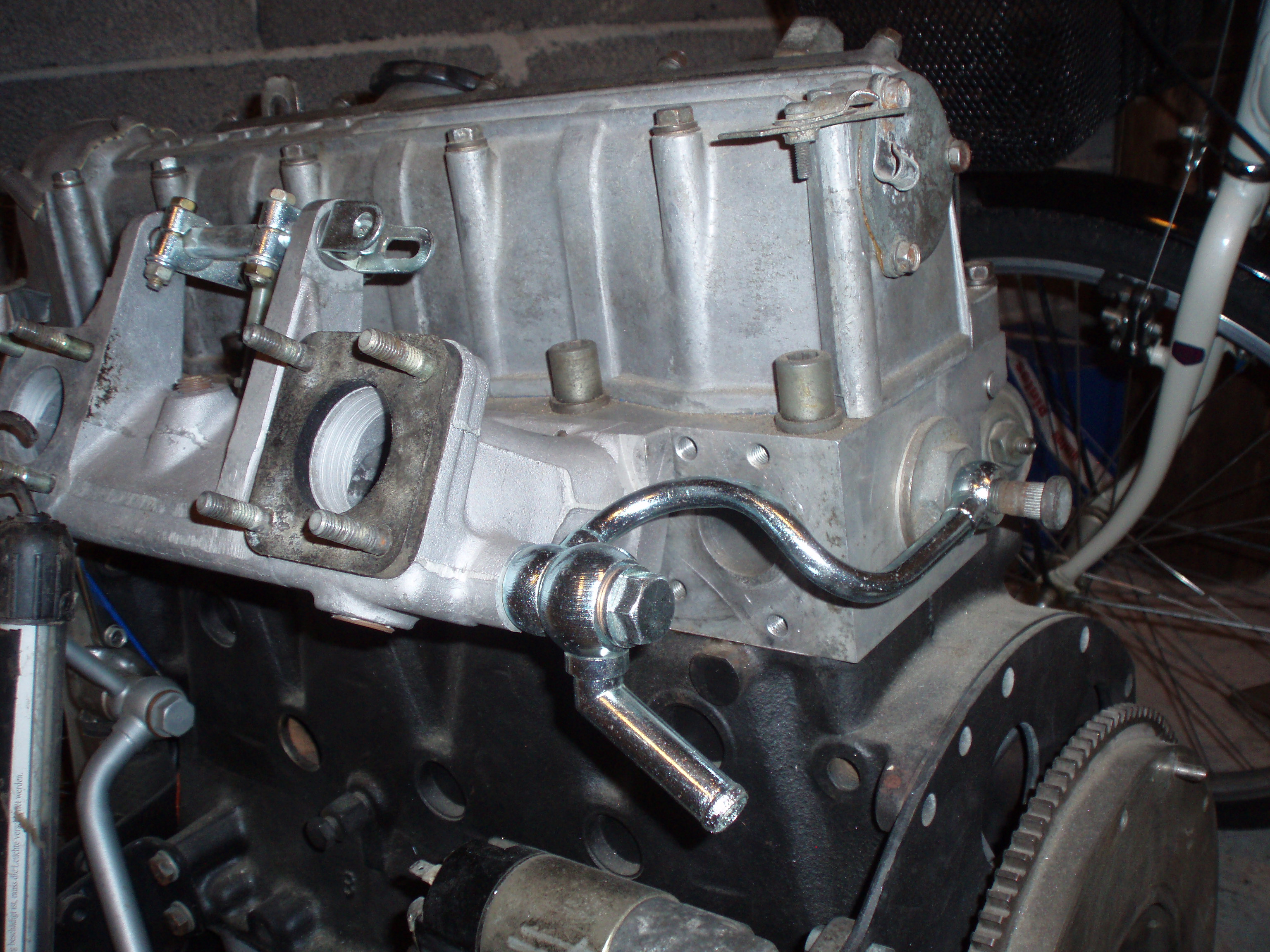

I expect it looks like this Glen...
This is a shot of Ari in Finland's SOHC motor. He reckons the fitting is original, so I'm thinking perhaps because mine is a 1600cc (or maybe mine is an earlier version) it wasn't made with the extra head cooling.

that would be right Mark. Looks much like the way the OHV one is done (except for the wheel stud? in there !!)
In the back of my SOHC head there is no pipe. But there is a large recess there, about 45-50mm.
