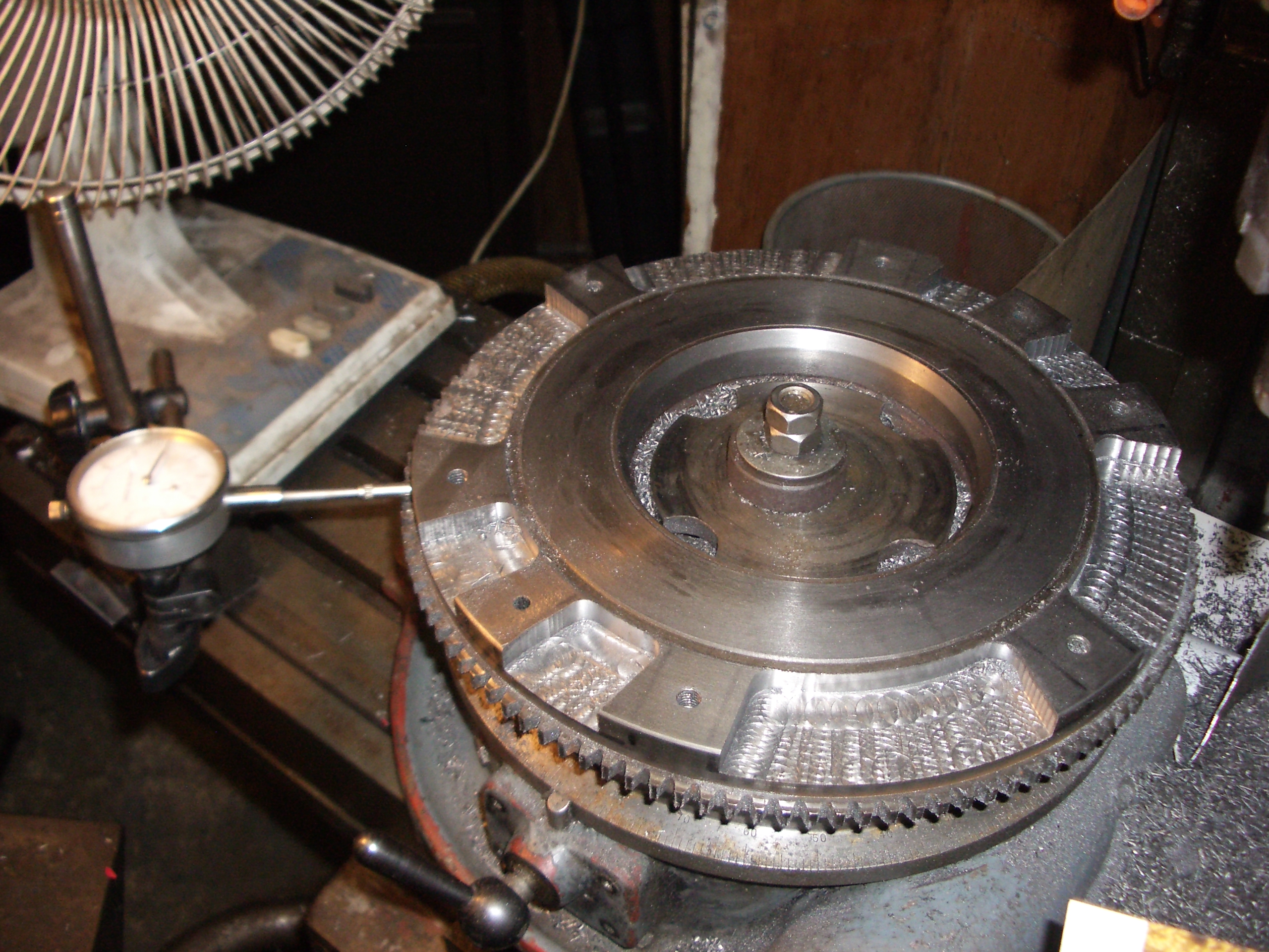

Yep, things are still moving along at a good pace. Crank, cam and valve seats all done. Flywheel's been on a serious diet...see below.
So the bottom end and the top end will hopefully be reassembled by the end of the week, and the two should have a happy reunion at the weekend.....lets hope they have a long and contented relationship.

Hi Mark, great that you are able to make great progress.
I assume you will have that wheel balanced? I don't want to nag, but I saw what that one I mentioned above did to George's GT, and you don't want that. Very scarey stuff. 35 years ago, but I still remember it. I'm no engineer, just an observer.
Sun Aug 02, 2015 11:06 am
Posts: 490
Appreciate your concern Matt, and totally understand. I saw something happen to an MG Metro, probably similar to George's scare...all very violent, and it's lived with me for about 30 years.
Funnily enough, after close inspection of the newly machined 1800 flywheel, we decided to start again using Rolie's original flywheel....this allowed us to run closer to the pattern we were using, but also to go down a much safer route.
Needless to say, it's been balanced, along with pretty much anything that moves in the engine.

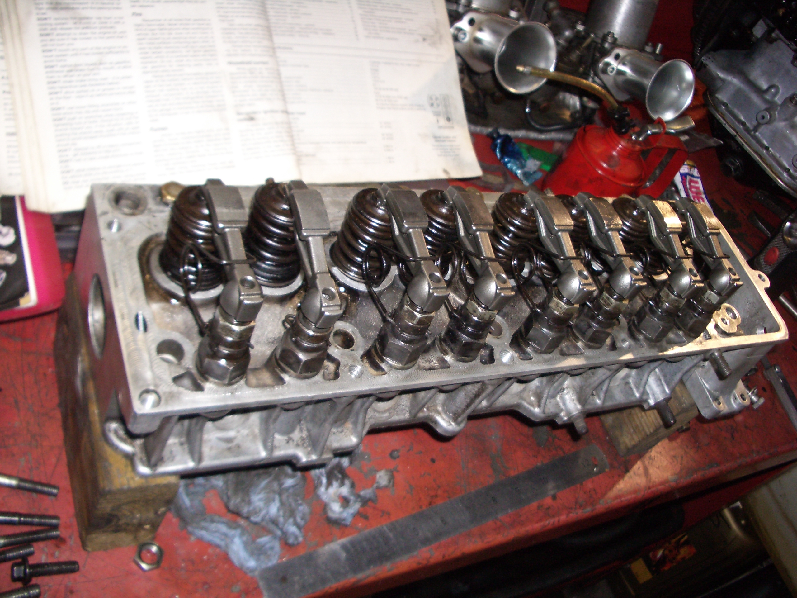

The run up to the test was a little fraught, as a few days before we discovered that whilst in the States the TOP of the head had been machined down by a few mm.....we assumed in a cock-eyed attempt to increase valve lift.
All it did though, was to totally upset the angles of the rockers and their attack on the tops of the valves....you can just about see this on the rocker second from left.

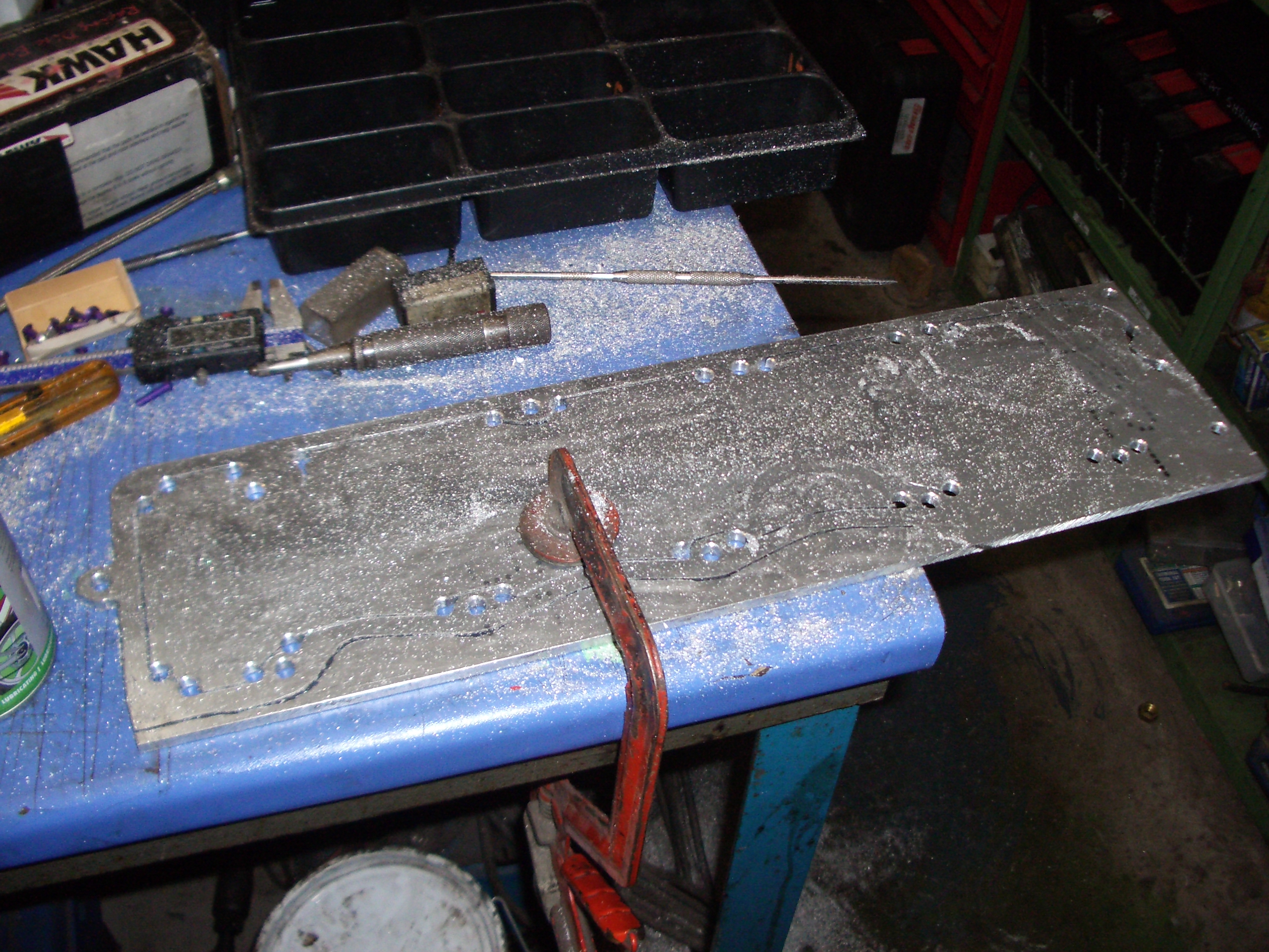

The solution was to cut a spacer
A laborious process to say the least, especially when we realised we hadn't take into account rocker ratio into our calculations and had to do it all again.
But it worked, and when attached to the block....

And after a few teething troubles the test went OK Good pressures and temps, but lacking in revs. So hopefully we can dial a few in before we test again on Thursday.
