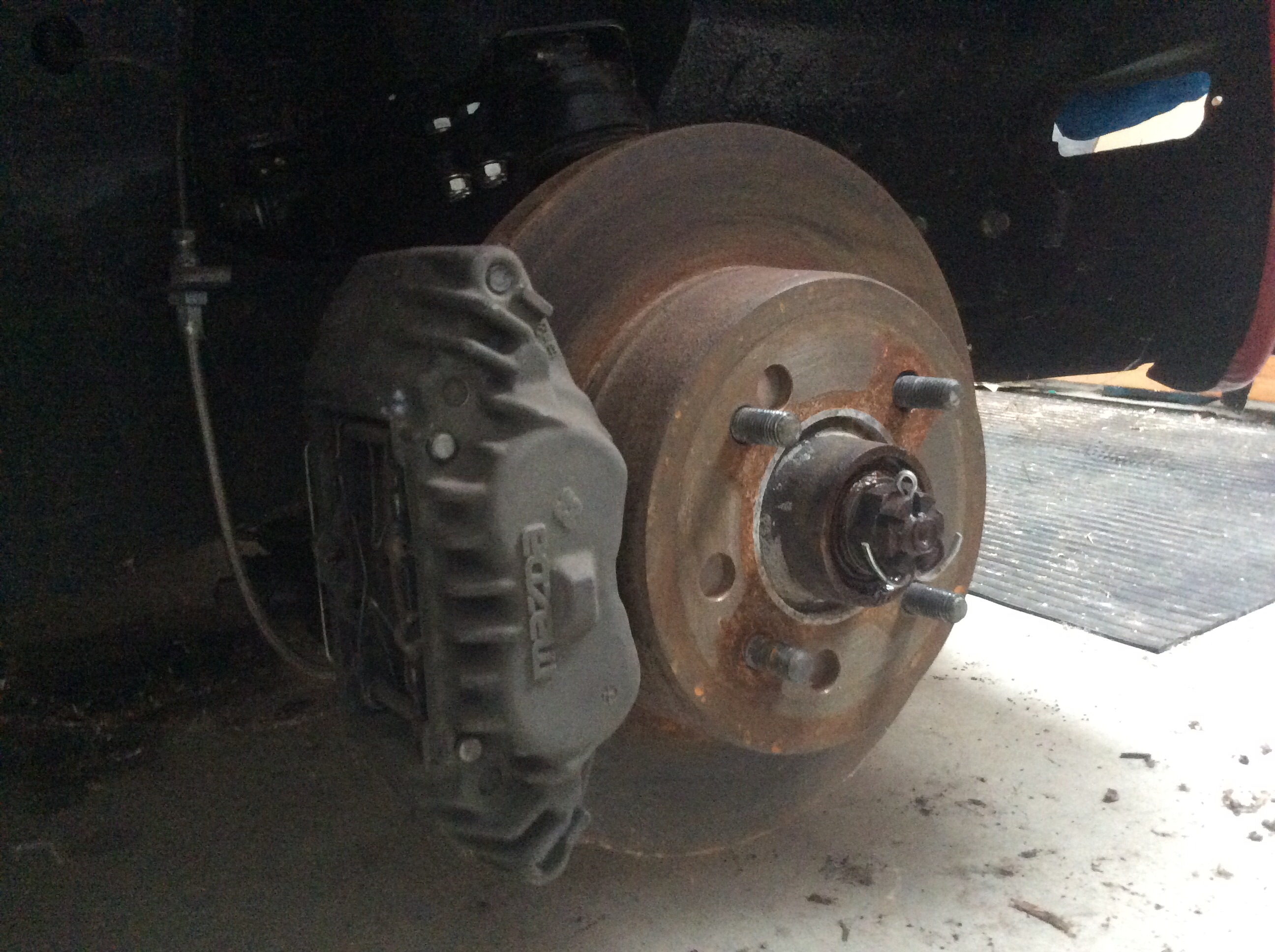

Having the wheel off means I can take a good picture of the front brakes, XF discs and RX7 series 4 calipers.
- Attachments
- image.jpg (963.24 KiB) Viewed 74791 times

Re: 69 Deluxe Sedan
that should stop it !Chris wrote:Having the wheel off means I can take a good picture of the front brakes, XF discs and RX7 series 4 calipers.
I see re-drilled disks..... not allowed here in Vic.. Is it ok up in NT ?

Re: 69 Deluxe Sedan
They'd have to take a wheel off to notice. Not too many places would do that in newsouth!
Looks pretty sound, and a fair improvement on what is required.

Re: 69 Deluxe Sedan
I um'd and R'd over getting blanks drilled... Just wanted to get the setup all done before I went to that expense...
Wheel fixed so should be able to pull it out of the shed this weekend... About time it's been a while... Looking a bit dusty at the moment... Binet goes tomorrow to the boys at Delta to get sorted.

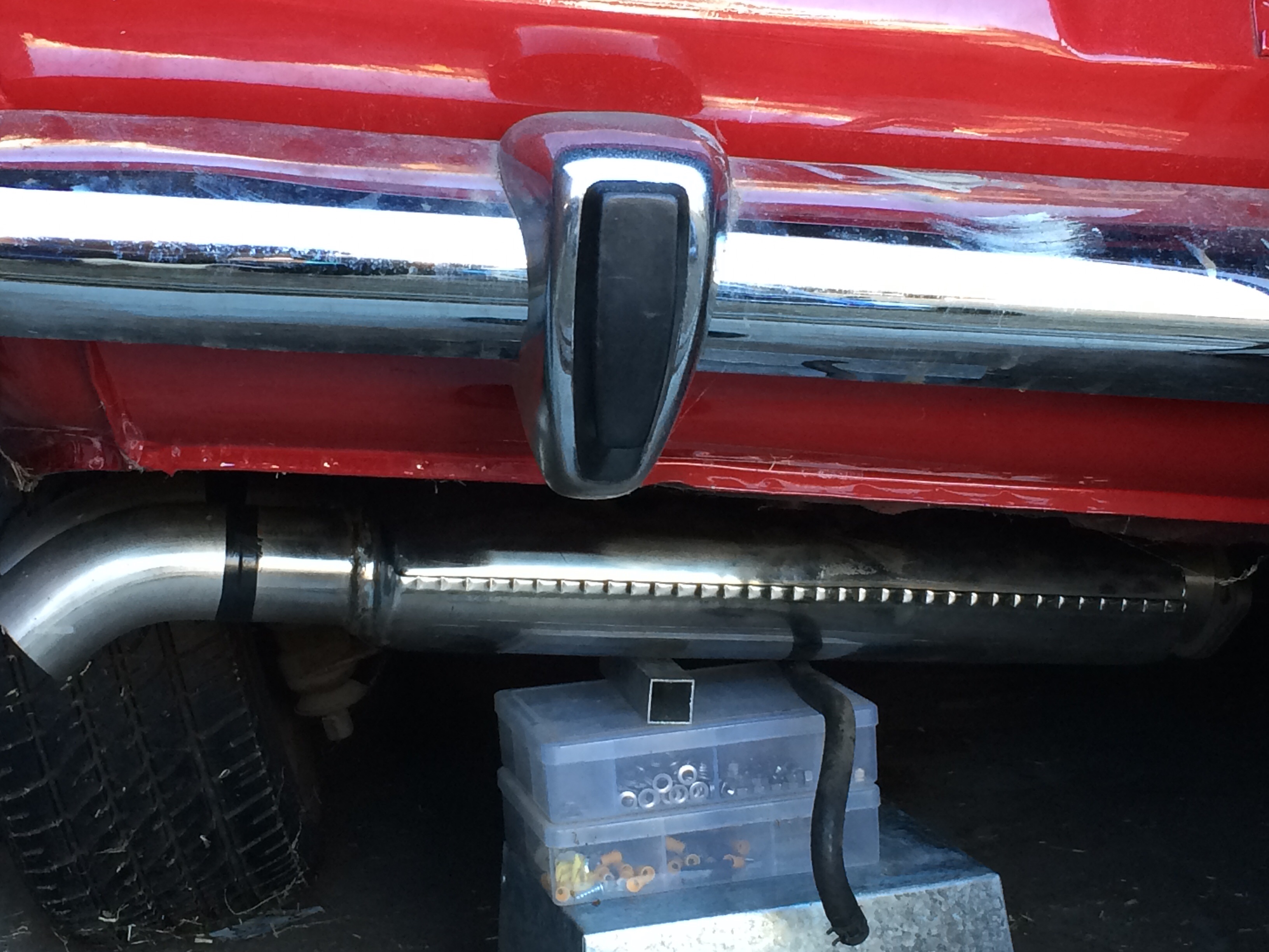

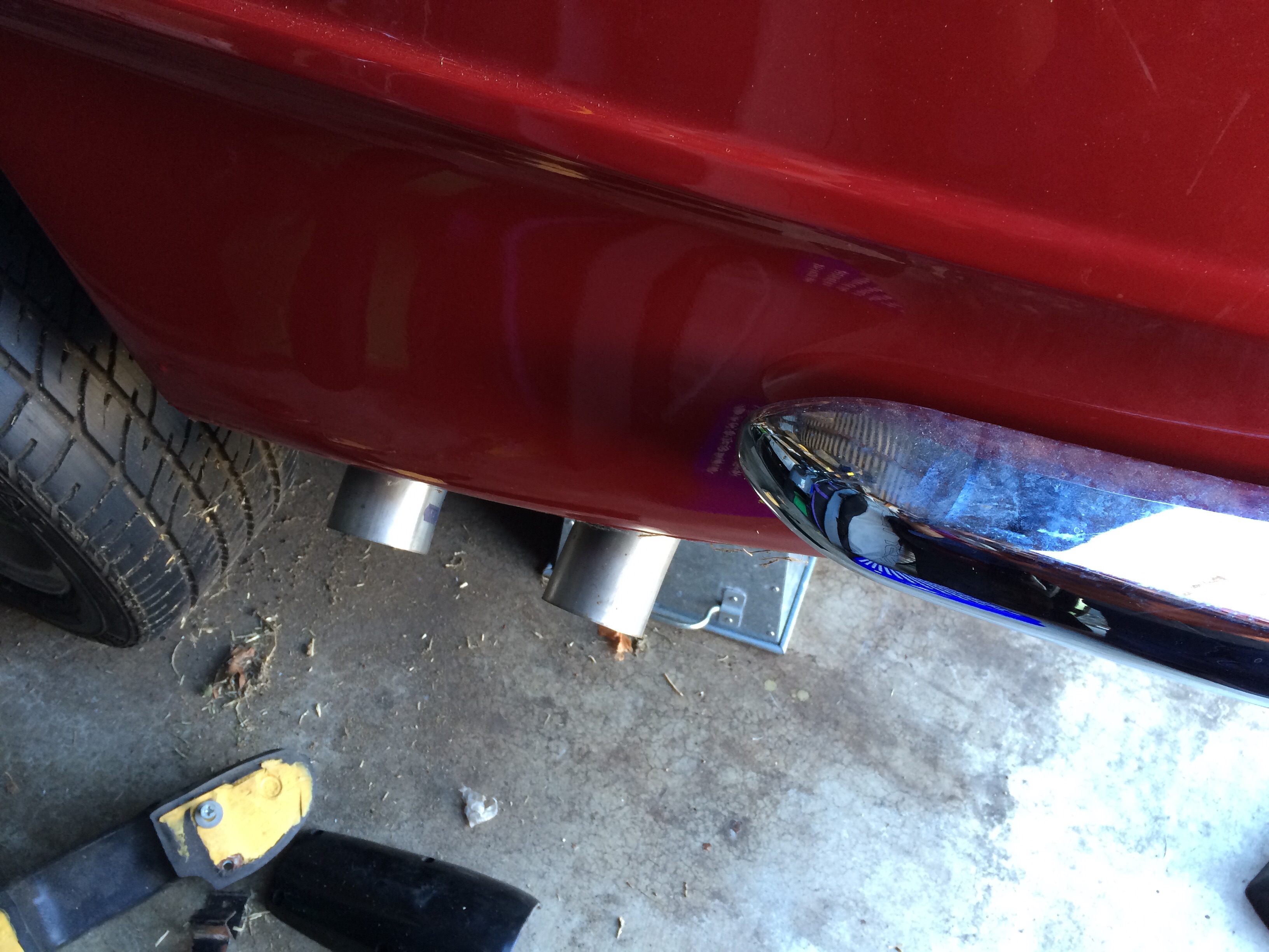

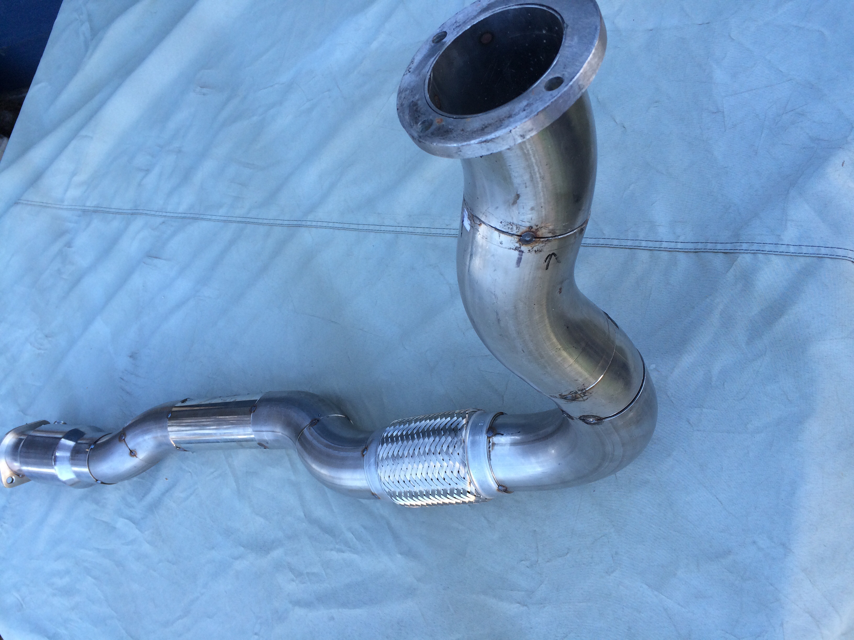

Re: 69 Deluxe Sedan
Hi,
Slowly but surely the exhaust is happening...
AAA Exhausts have been awesome in helping out with tacking the bends as I bring them in. Here are a couple of pictures so far.... Still a bit to go though.
- Attachments
- image.jpg (1.3 MiB) Viewed 74579 times
- image.jpg (1013.29 KiB) Viewed 74579 times
- image.jpg (1.54 MiB) Viewed 74579 times
- Glenn
- Posts: 2826
- Location: Melb.
- Contact:
Re: 69 Deluxe Sedan
VERY nice work. Not a lot of space under a Bellett for bigger pipes, mufflers etc.

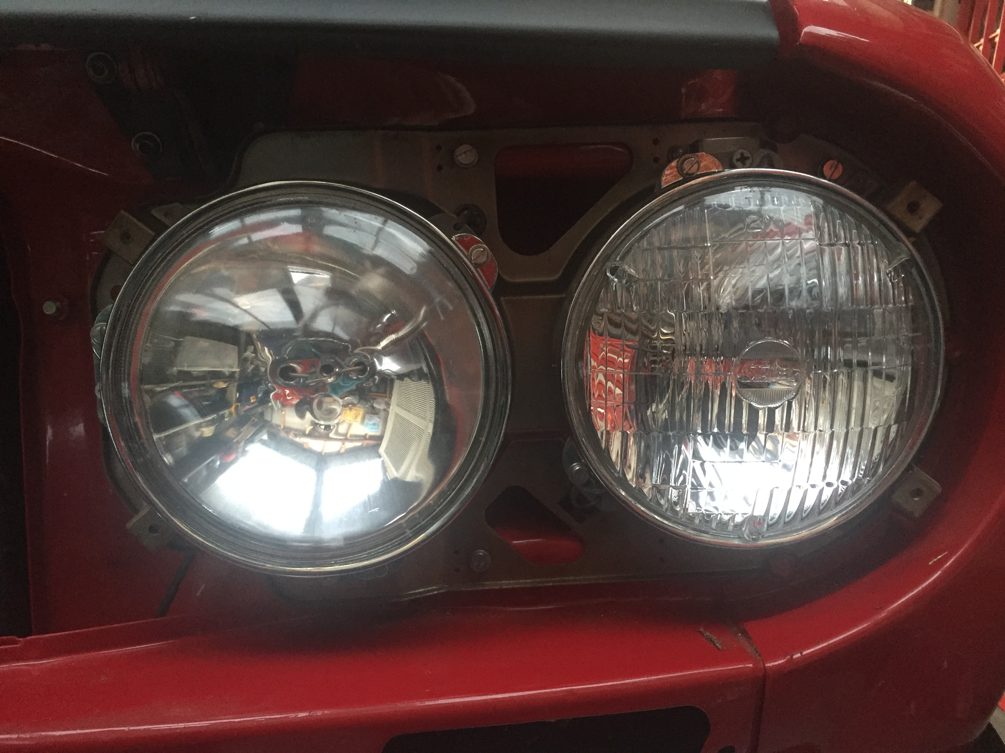

A long time ago, I got the wrong light mount, blasted and painted... just wondering if someone may have the right ones...
- Glenn
- Posts: 2826
- Location: Melb.
- Contact:
Re: 69 Deluxe Sedan
Is the picture the one you want ?Chris wrote:A long time ago, I got the wrong light mount, blasted and painted... just wondering if someone may have the right ones...
- Chris
- Posts: 56
- Joined: Sat Apr 28, 2012 10:16 am
- Car(s): 1969 Isuzu Bellett Sedan, 1995 Toyota Hilux SR5, 2014 Land Rover Discovery XXV
- Location: Largs Bay SA
Re: 69 Deluxe Sedan
I threw the ones that were on the car away, think there from a PR90 I need some from a PR91....
- Farmer
- Posts: 2591
- Location: Rye Park, N.S.W.
Re: 69 Deluxe Sedan
Hello Chris.
Knowing which ones you need is a bit difficult. I have some here of various types. PR90 is early GT single headlight. PR91 is single as well until '68 1/2 where they changed to strip taillights and twin headlight. Sedans changed with grille changes. If you post a pic of the grille and light surrounds you intend using that will help identify the ones you want.
I'll help if possible.
Re: 69 Deluxe Sedan
The ones you have are early (teardrop taillight) PR20 sedan. The location of the surround mounts is obvious.
You need the late PR20 mounts that have the surround mounts between the lights themselves.

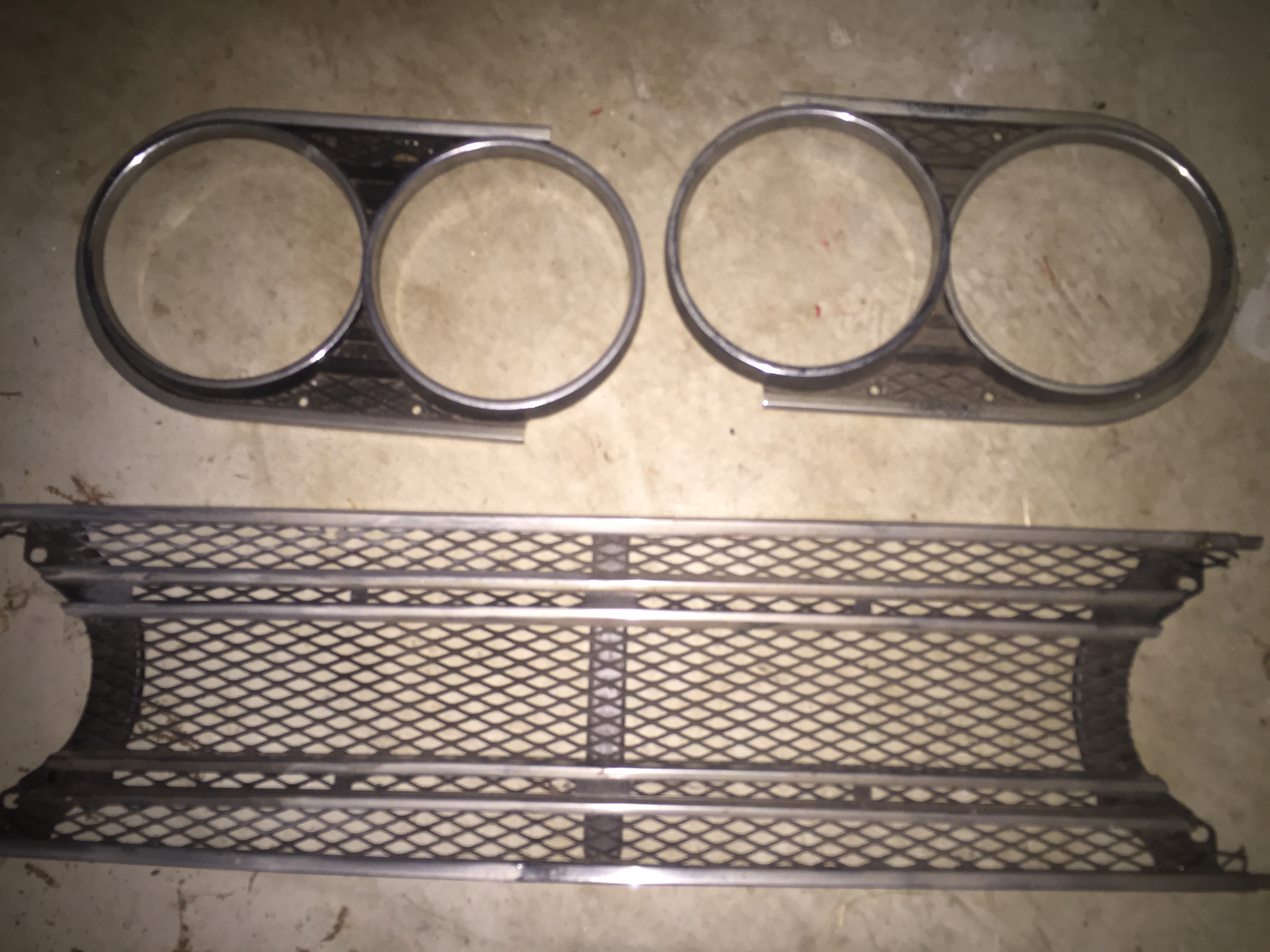

- Chris
- Posts: 56
Re: 69 Deluxe Sedan
Hi, here is a pic of the original grill I want to use, just would like to st least try to get a set of the headlight mounts, really wish I’d looked but 20 yrs ago when I took the thing off... I really didn’t think... twin lights... twin lights... should be the same...
