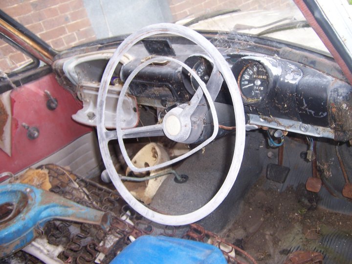

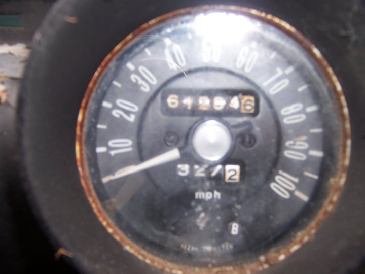

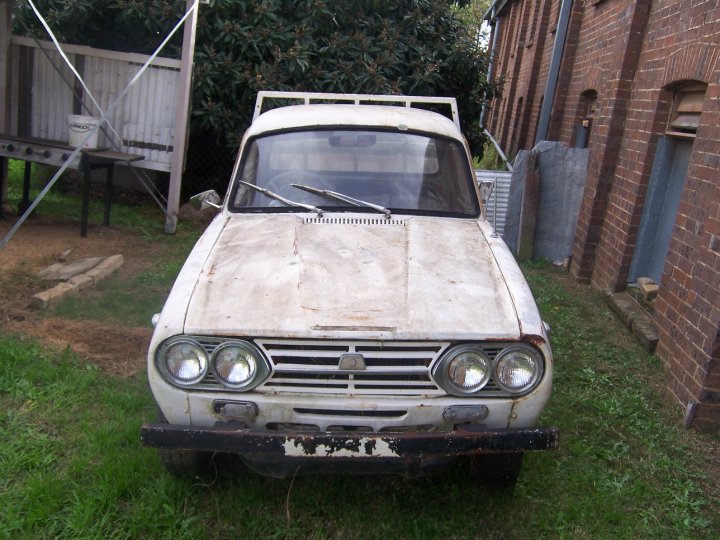

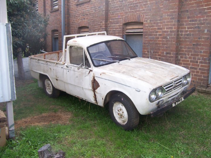

ok might as well give this a go! since i know bugger all about the wasp, and since the plate with all the details on it has evaded me, i thought i might leave it up to you guys to fill in the blanks!

koolies. i wasnt sure exactly what to do about the rh door, im assuming someone had left the door open and reversed into something quite hard! what do you reckon condition wise? i know it will be a mission either way, but it would be worth it though hey?

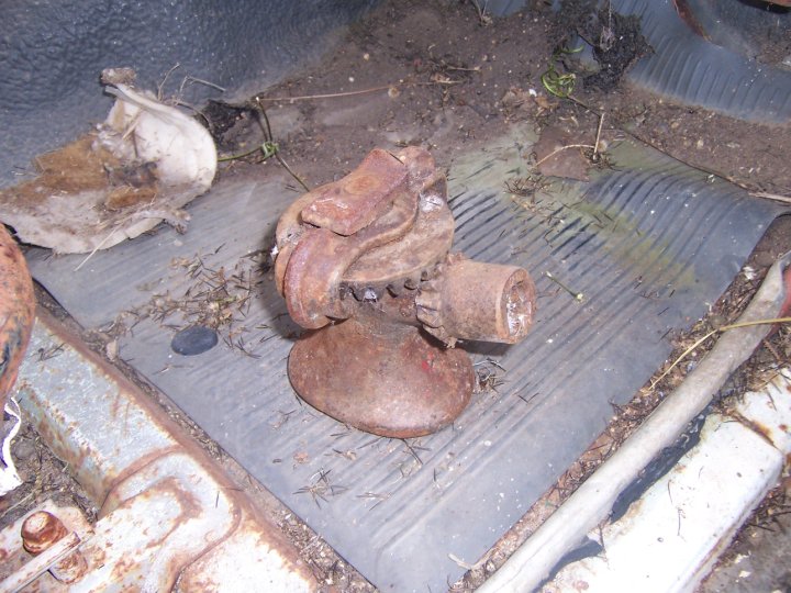

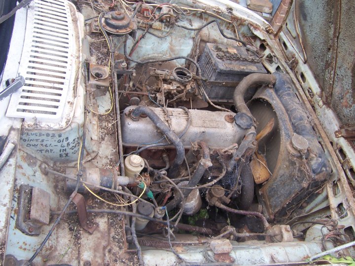

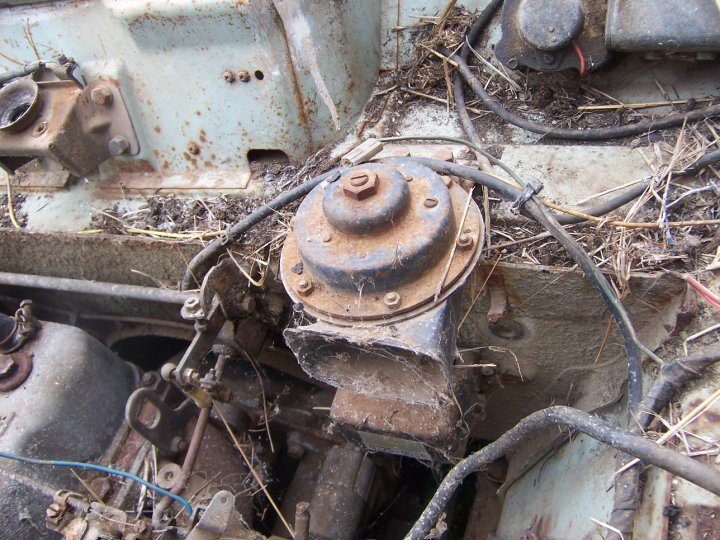

got the other pics working

Oh yeah, I noticed that the rear reflectors appear to be the original ones, although someone has moved them to make the rear of your car look a bit cross-eyed! A look at some of the stuff above should reveal where they're supposed to be.

also i had a look earlier for any details about the engine, and the only thing i could find was G161 stamped on the block. does anyone know what that means?

Yeah man it looks like it's got an Isuzu Florian/Chevrolet LUV 1600cc engine, rather than the G150C 1500cc donk that would have come with it.
The 1600cc G161 from the Florian/LUV is a straight swap, but the Gemini G161Z doesn't bolt straight in; the Bellett runs the mounts way down the front of the engine, while the Gemini runs them about half way along the motor.
I've seen pics of it done, but the Isuzu G180 and G200 DOHC motor fits in stacks easier as the mounts are in the right place, normally.

Just looking at your pics again, I'd go so far as to say that yours has LESS rust in it than mine!
Plus they often rust in the roof.... which is a fairly big job to sort out, however yours appears to have not, which is good.

yeah well considering it had been in a paddock with one door wide open for over 10 years, its in reasonable condition. the interior suffered a fair beating from the weather though. i looked at another g161 on google, and the numbers are in a different place to the ones on the wasp. dont know if that means they are different era maybe? also how would i go about getting seats? as mine are just springs at the moment =)

well hopefully i will get a few spare hours this weekend, would like to do a proper cleanup on it. thats about all i can do with it at the moment with my financial status. the only problem with getting it started is the fact that the owner before me had pulled a heap of wires out from under the dash after parking it. i guess it will be mostly trial and error. they were a fairly basic wiring system back then, so might just need to spend a bit of time with my head under the dash. i am fairly sure the springs are all in fairly good nick, just pretty rusty. i have a good mate of mine that could probably bang something up for me. one other critical fact that i hadnt taken notice of until we got it home: there is no ignition key. but to my surprise one of my spare keys from my KE35 corolla coupe fits straight in and turns! would like to get a proper wasp key for it though. i heard that you can take the barrel to a locksmith and they can make keys from using the barrel?

Well Kemosabe, perhaps I can help. I have a Wasp wiring diagram, but my vintage scanner is having trouble getting a clear scan. I will try again tomorrow. Maybe the trick is to photocopy it & mail it to you.
You have discovered the fact that, with age, most Bellett / Wasp keys fit most Belletts! I have a tin of old keys that don't fit my locks. I could send you a couple. PM me your address if you like.
For a shortcut, you can run a live wire to the + side of the coil (& ensure the - is continuous to the dizzy), then push the button on the back of the starter switch to wind it over. (left inner guard)
