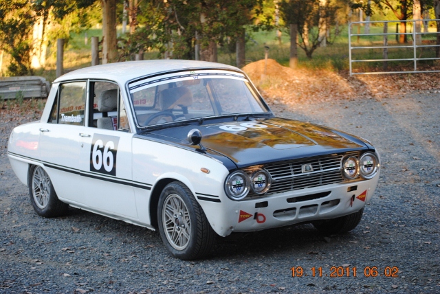

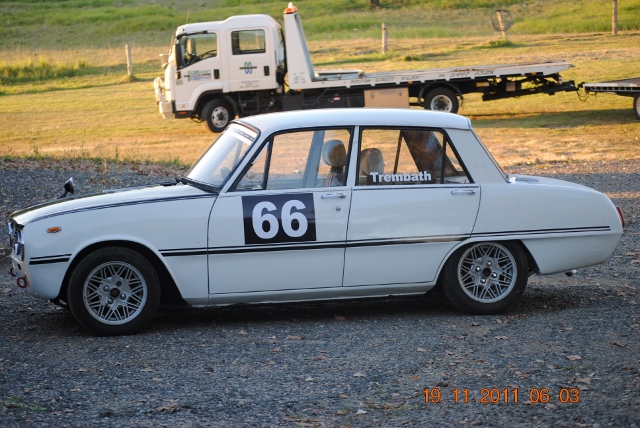

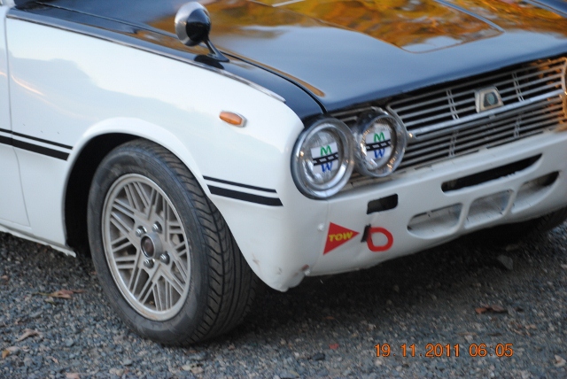

A few months back we picked up 4 ugly belletts 3 painted in house paint in side and out and as they were bought for parts it was decided that 3 remain with us and plans for all 4. 1 is to be past on to someone else that will also be rebuilt.
Long story short i put the most ugly of them all and the one in the worst condition and decided to do a low budget track car for lizzie to play with. Low budget i painted it in hino white as we buy this in bulk for cleaning up truck trays and there was gloss black also. seats are from a piazza we bought 12 months back for the diff for walter. When i orderd the shocks for my car last year koni adjustables i was lucky not that i thought this at the time but they stuffed the order and sent me 4 for the rear that was orderd from overseas this took 6 weeks to get here another 6 weeks i get 2 sets for the front when i told them i had got 2 sets they said you have only been charged for 1 set wahoo the springs in this beast have been cut down.
The car has been sitting for a long time so a recondition brake job was in order. The engine was missing a fuel pump so a plate was made to cover the hole and a electric pump fitted the point were missing so it got a new set and the fuel tank had a white slime that would not run out. After a fuel tank flush it was time to hit the key and awy she went :D it has a little timing chain rattle but runs fine.
Tomorrow was to be it's 1st day out after weeks of late night's and 5.30 am paint jobs before the wind picked up but the master cyl that was recoed was a failure :roll: queensland raceway are having a ladies day tomorrow so Liz is going to give mine a workout.

Sat Nov 19, 2011 10:42 am
WOW looking good. :shock:
Sat Nov 19, 2011 11:05 am
wwwwwwoooooooowwwwwwwwwwwwwww
looks bloooody GREAT!!!!!!!
YOU GO GIRL! :D
Sat Nov 19, 2011 12:18 pm
looks good! the corona wheels even look reasonable on it!
have fun on the track with it!
Sat Nov 19, 2011 12:20 pm
The wheels do not fit properly the centers fowl the hub at the front and the centre of the drum rear. It runs 5mm spacers to fix this as the wheel rocks on the hubs. Just in case someone thinks of buying them you may need to machine the centres of the rims for road use.
