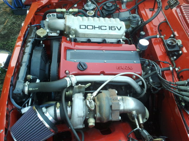

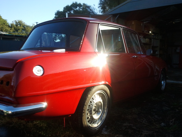

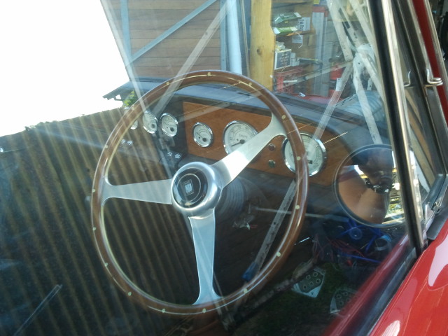

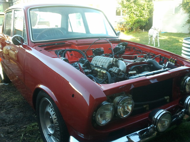

Here's my pride an joy, its been about 20yrs of on and off work on the car, mostly its in the garage but i get it out every now and then to give it a tubs and think about the good old days when life was a bit simpler.
Engine - 4XE1-WT
Gearbox - Nissan FJ20 Turbo
Wheels - Sigma Turbo
Brakes - Mazda RX7 - Series 4 (4 Spot)
- 11" Ford Discs
Guages - Classic VDO
Steering Wheel - Nardi
Seats - Cobra Classic
Chris
Engine - 4XE1-WT
- 11" Ford Discs
Chris

oh thats very nice, bet it goes well too!
I like the dash treatment and the steering wheel looks good too, Is the paint the origional colour?
be good to see some more pics of the beast or even see it out and about sometime!

well done there Chris, I have often thought of this set up rwd gearbox and dizzy a issue was my thoughts? theres only a week or so left in that

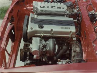

Thanks for the info. LOve to see the mods to the pedal mods also when you take pics of the brakes.
Here's a picture you sent me years ago.........

- 4xe1%20from%20left-small[1].jpg (17.23 KiB) Viewed 128379 times

The Motor is out of a JT AWD Gemini, its the same as the Lotus Elan S2, Isuzu Built it to for the Elan but ended up putting it into the AWD Gemini, I had one of those for a few years but sold when i bought the Hilux, best thing ive ever bought.
