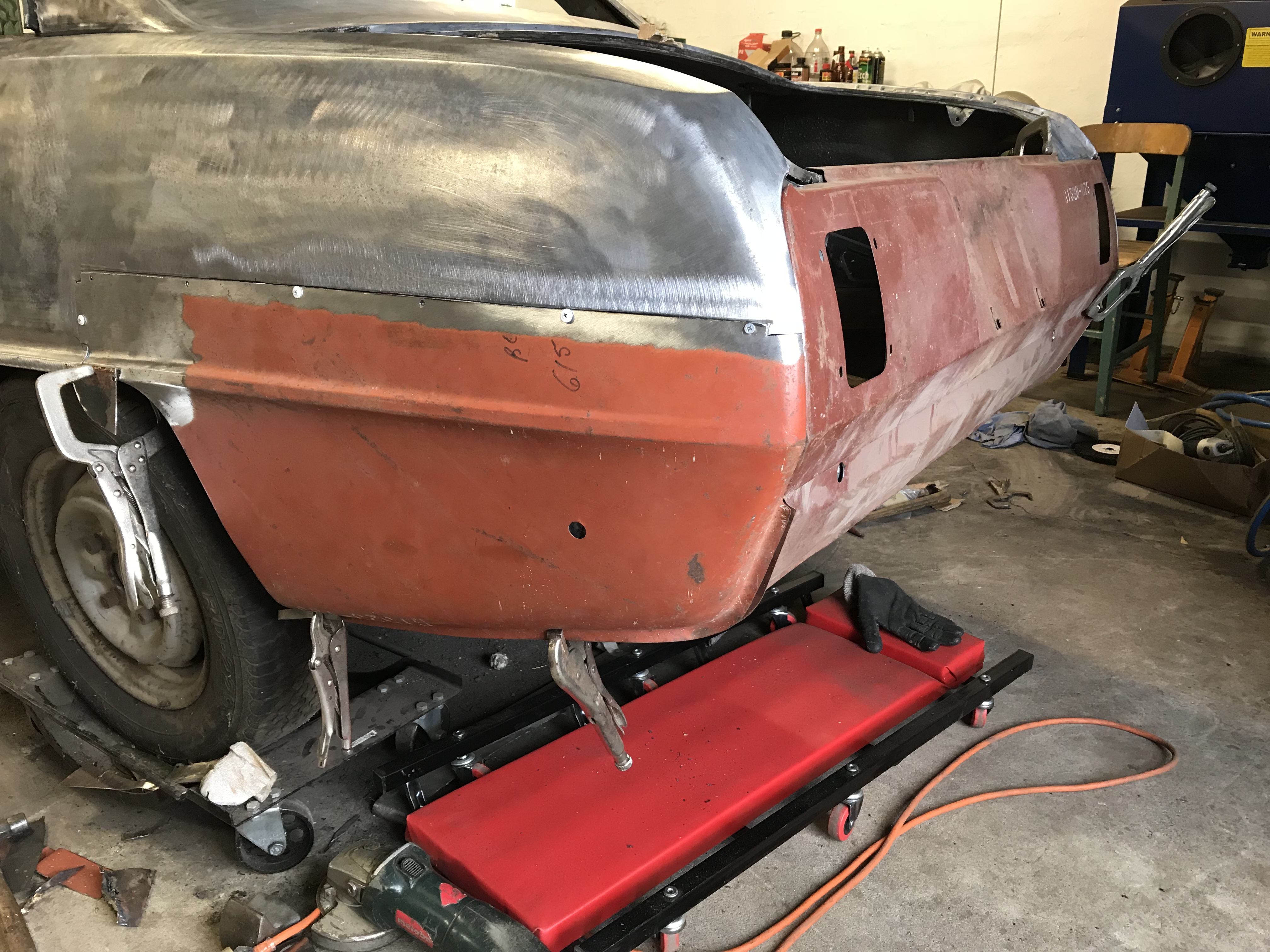

Author:  claws [ Mon Apr 23, 2018 11:46 am ]
Post subject:  Re: pr90 resto begins
Learning about fitting NOS panels today that don’t fit to the original factory bodywork. Lots of cutting, bending, oxy, fitting and re fitting. Welding the rear end panels up tomorrow. New sill panels get rolled next week.
