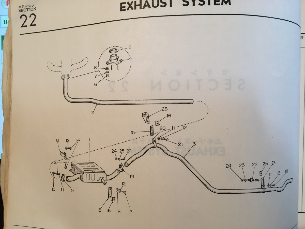

A picture of my sedan exhaust is here but note it has the rear GT twin pipes (standard on a Sport model) . http://bellett.net/forums/viewtopic.php?f=13&t=2084&start=140 This is the original central muffler on this car by the way. The central muffler on a Bellett is a bit unusual in that it fits up under the rear seat area. Very difficult to find an off the shelf muffler to fit up so high and allow the pipes room to fit, so most i think use a short standard muffler hanging a little lower.

Here is the original with the old style muffler which can be. Replaced with something easier cheers dave

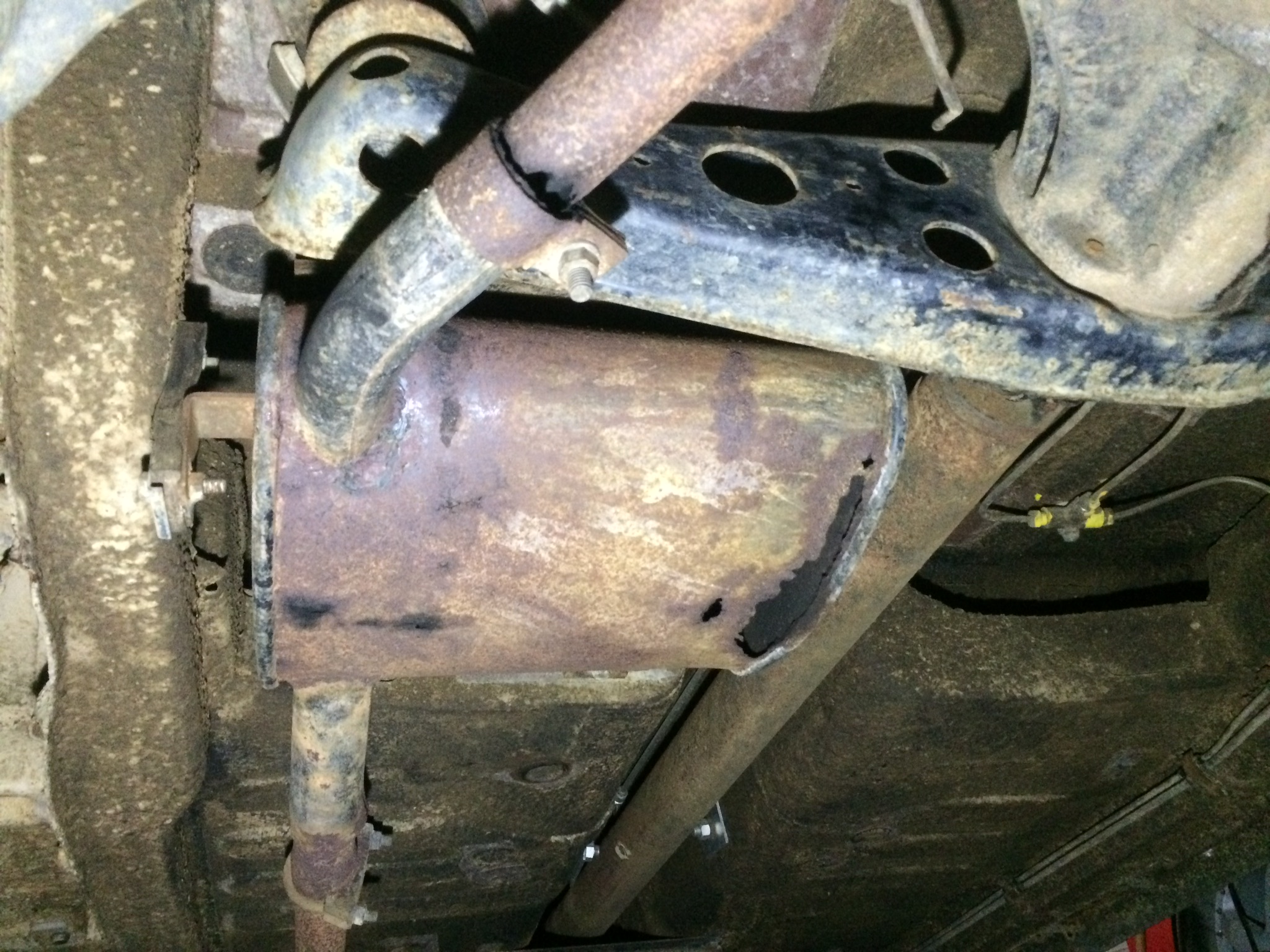

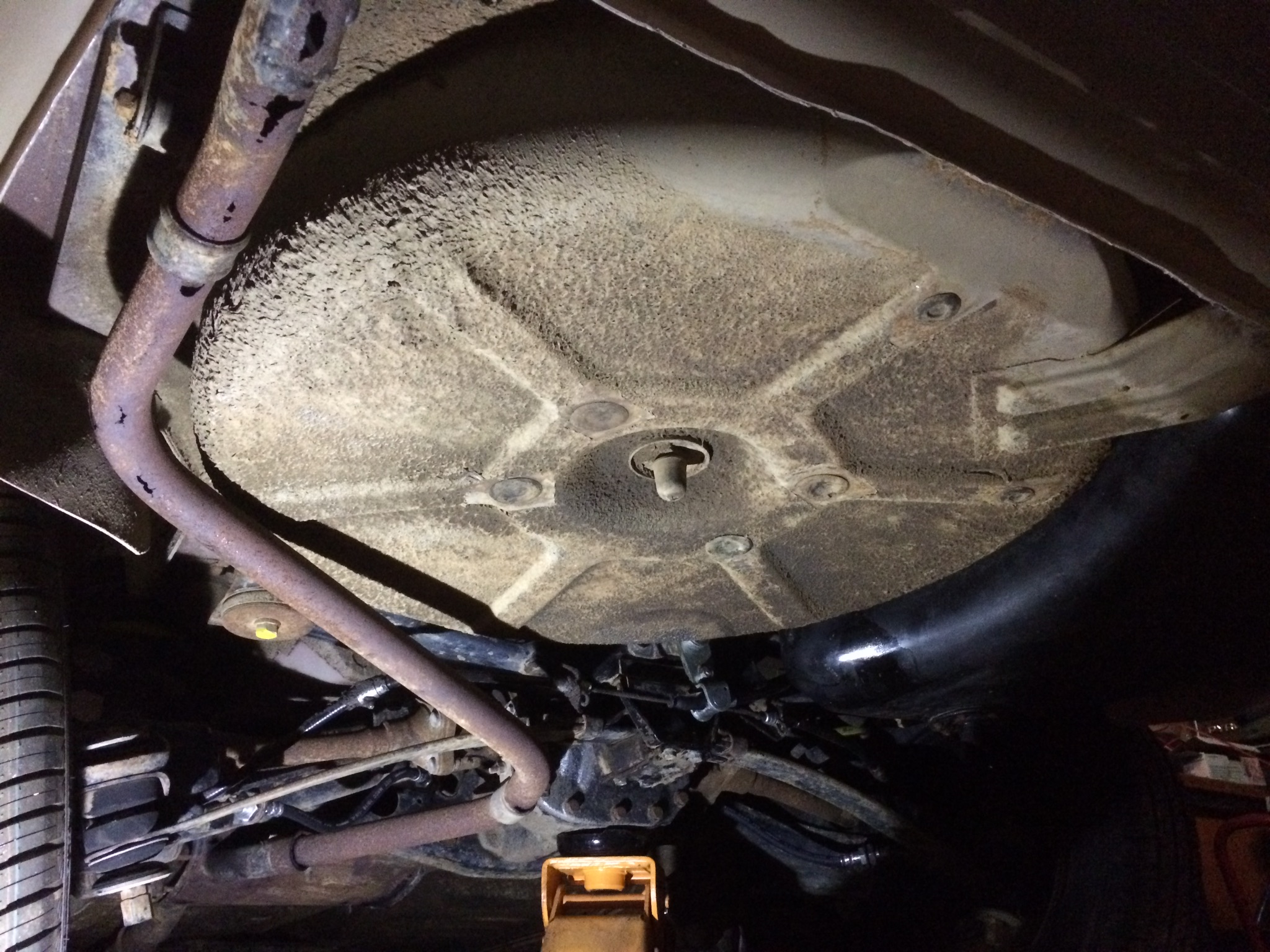

Firstly, I'm very impressed with the new model 1 post hoist made in Estonia these days. Nice work.
I have taken some photos that may help. I have been told the muffler might not be original as mine
is round & the book shows it as being squared on the edges. Hope these Help

Thanks for the pics, now I have much better overview of the pipes. There is just a plain pipe from front to the under-back-seat pot? No resonator in the middle?
