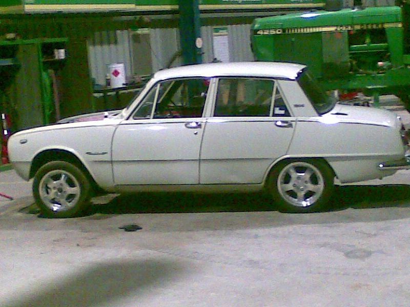

thought i'd post a coupla pics of my belletts... still getting the hang of this :?
this is my 67 that is coppin a toyota 2T-g and a 5 spd. biiiiiig job!! the engine bay is all flushed over, no wiring visible, battery in the boot, and the rust below the upper wishbone mounts repaired
will post more as it happens...

Looks minter:)
wheels look good on it too. good luck with the project!

Dude you told me you couldn't use a computer! You lie!
Car looks bloody great! So far so good! Hope to see the finished product prowling the roads soon!

Keen to see some engine bay pics! The 2T-G must fill the engine bay quite nicely.
Very cool.
PS. What size are the wheels in that picture?

You're not wrong there barney, its real tight!!! had to custom fab engine and gearbox mounts, and the bonnett will need a 80-100mm rise in centre to contain the whole thing. custom sump, custom inlet and exhaust manifold, but the origional bellett radiator will fit- with 20 mm to spare!!! the wheels are a seyt of 15's i found, off a late model ford laser. The tyres are a 195/55, and they just fit. had to do some serious mods to the bumpstops, and lower the front an extra inch to flaten out the wishbones.as i collect all my tech notes together, i'll post more
