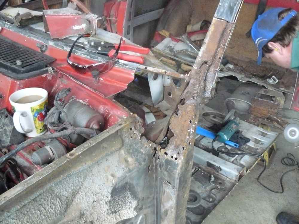

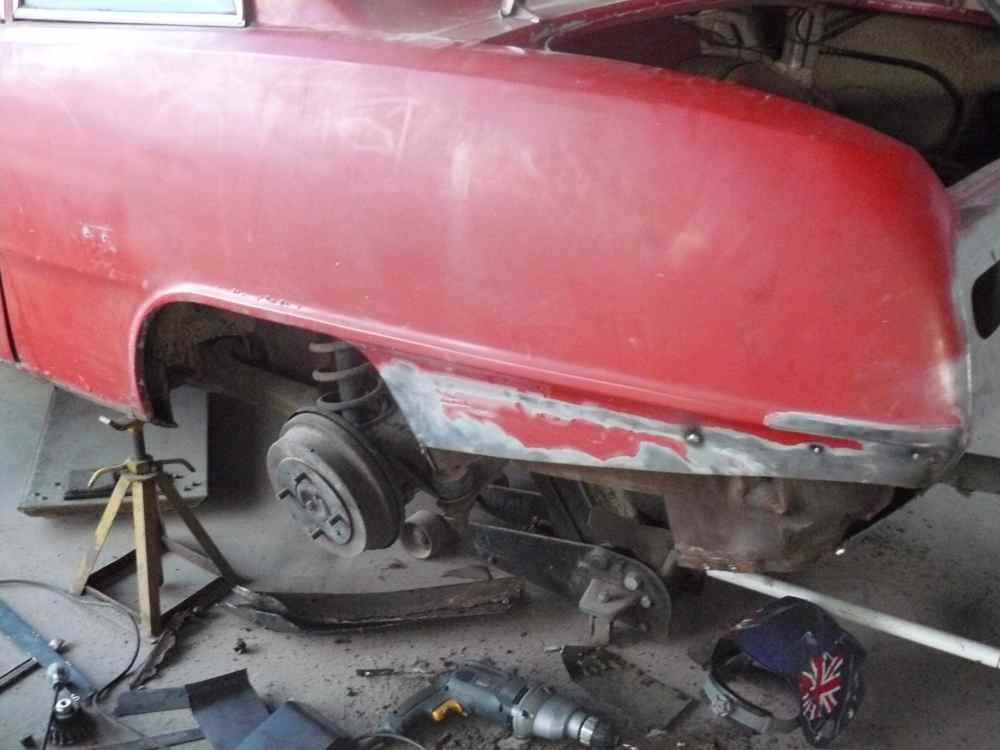

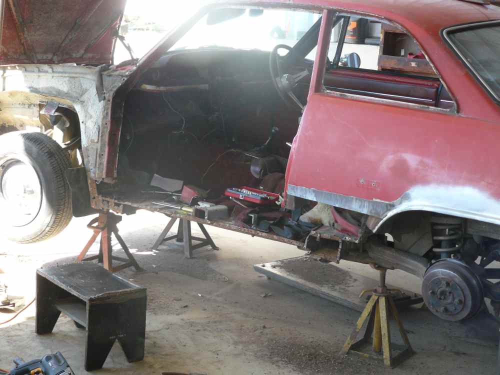

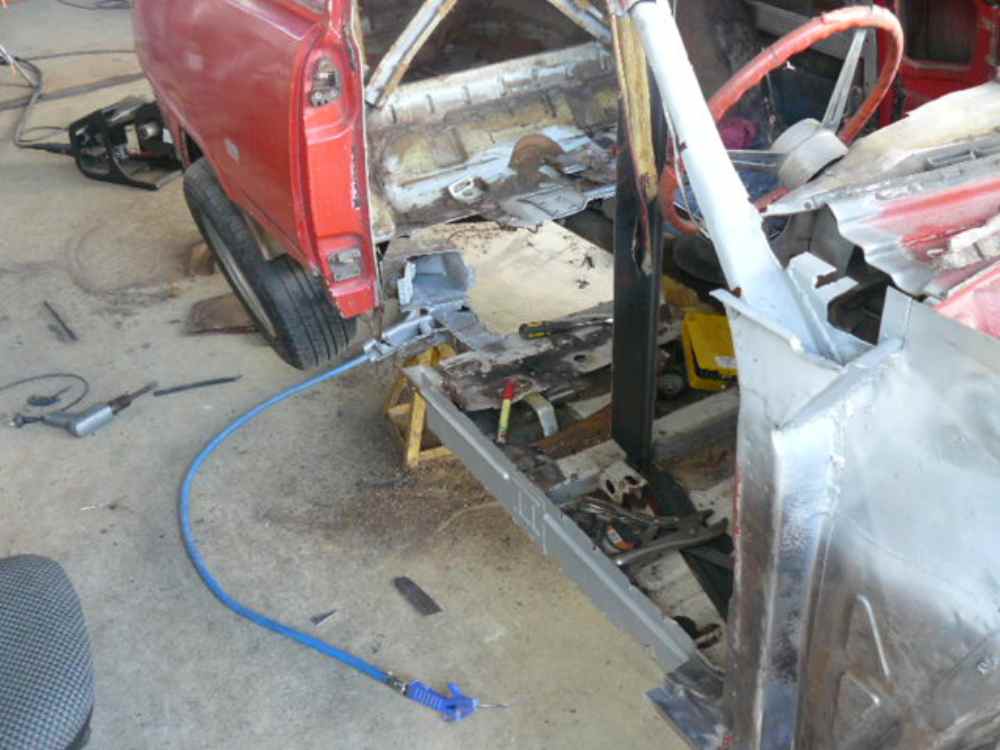

Around 10 months ago i bought a little delight from bell qld.The plan for this little car was to repair the rusted door sills and rusty rear quarter panels and keep it alive until i got back to it,with isabellas car and another one waiting this one was called patches as it was going to have a few grey spots.As the grey spots were supposed to appear in small areas this didnt happen with outer sills needed we folded up a couple of sets and quickly found out the inners were gone then the rear sub frame was not in a condition that they would still be there in 5/10 years time so it was all reconstructed from sheetmetal the tops of the door pillars were gone it become obvios it was time for a full resto the car was completly stripped out and sanded back to bare metal,90%of the suspension was powder coated except the few bits that i did not want to disturb the bushes,chrome has been sent to be redone and it went from a patch job to a full resto.
here are some picks.

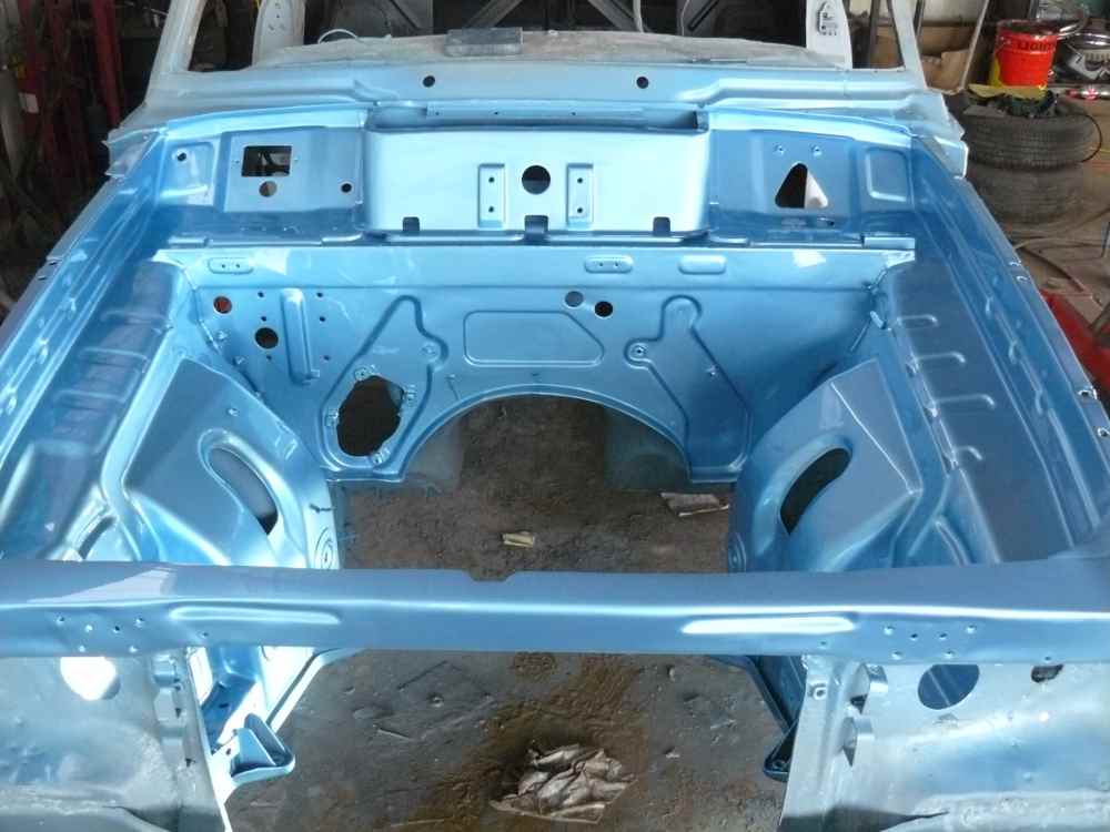

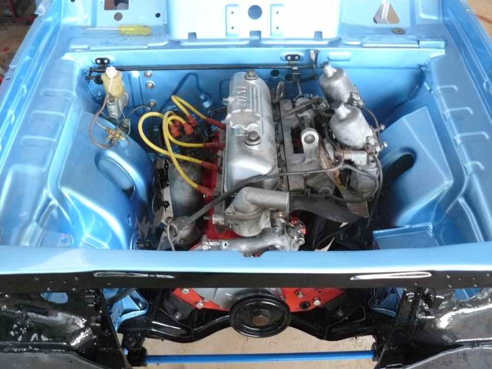

Thu Mar 18, 2010 11:54 am

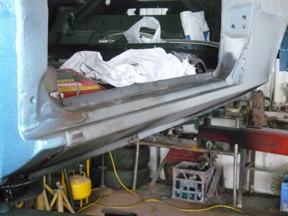

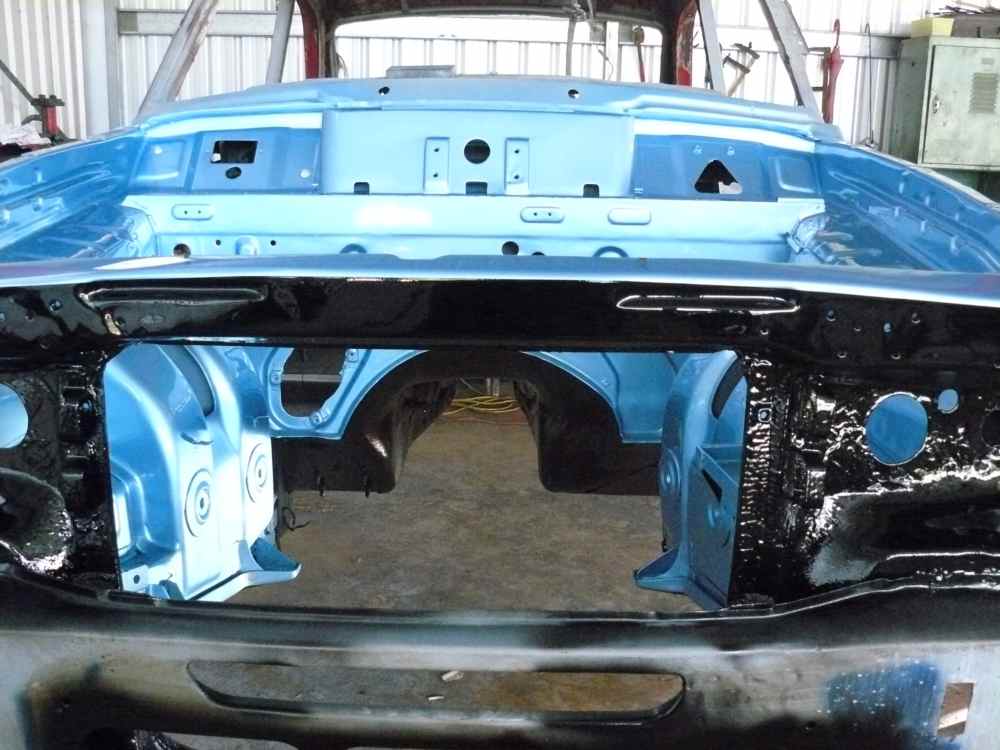

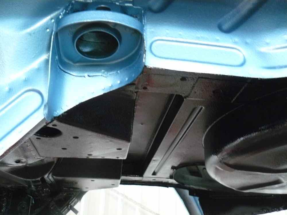

Yesterday we painted the engine bay and today it was blacked out and the under side was completed in a gloss black over body deadner it had all been strpped to bare metal.

Fri Mar 19, 2010 1:54 am
Dear me, that's some serious cutting! :shock: And I thought my rusty spares car was too far gone! But if you were prepared to do that much cutting, then it might be possible to save it!
Good work on being so thorough, there must be some serious man-hours in there. It's beaut to see one more saved & returned to it's former glory. Might we see it at Coonabarrabran?

Fri Mar 19, 2010 10:48 am
The plan is to have it at coonabarrabran as well as the north qld car.I have held back on this post there were times we thought patches was not going to pull through but its alive and well.
It has been repaired properly all sections replaced with new steel bog only been used to hide welds small dents ect as any car has.

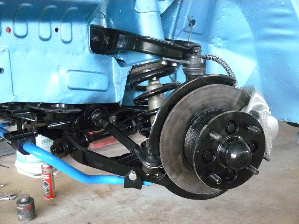

Mon Mar 29, 2010 6:16 am

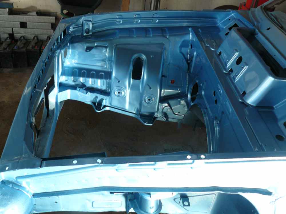

I am working on the nats engine is back in front end is back in new brake lines recoed calipers new pads nolethene rack bushes all boots replaced.Over easter i hope to refit the rear end rear wheel berings should arrive tomorrow.Chrome work is under the bed.[thats another story].I have a spare rocker cover,oil filter cover,fuel pump,fuel filter assy,and carbies being chromed i should get it back thursday.
I got a email from the qld courier mail today to do a article called me and my wheels on the maroon gt they are doing a photo shoot in the next couple of weeks so i might put some of the chrome bits on it i.e carbies ect and see if i can get a fast chrome job on the twin cam rocker cover[why pollish when you can chamios]

Tue Mar 30, 2010 2:03 am
nice car or will b when finnished nice front end if they are new front shocks , where did you get them , has the front been lowered ? cheers rod
Tue Mar 30, 2010 6:33 am
HI ROD
As for the shockies they are new i started a parts thread called parts and contractred services this will help you feel free to add to it or if i have gone the hard way about sourcing a part correct it this info should help anyone doing a resto or a repair.
As for lowering the front a set of rear sedan springs were used.
