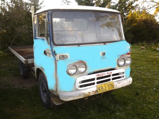

Or this?
Sat Apr 18, 2015 1:15 pm
Need a better finger painting program... :?
Sat Apr 18, 2015 1:17 pm
pale blue would suit it, your photo shop skills are better than mine!
Sat Apr 18, 2015 1:50 pm
I'm with mrflibbles, a soft powder blue (similar to Datto 180B colour) with an ivory white roof & cream leather or velour interior.
Sat Apr 18, 2015 9:39 pm
Go the fluro slime green but with the trimmings in purple. It'll be a conversation starter. Why be boring.
Sat Apr 18, 2015 10:23 pm
My vote Original colour,with pearl in paint,reason,you have a real pearler there,then build set of ramps to load a Bellett on the back,maybe even a Pink GT on the back for a splash colour ;) Gerry

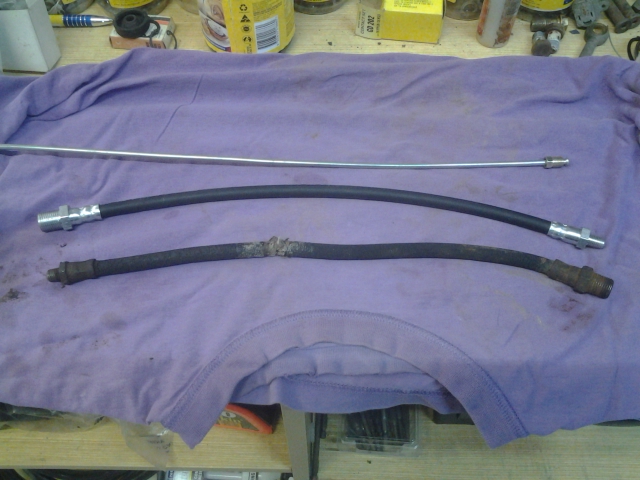

Well, Dobby got into the shed a couple of months ago. I get a few hours here and there to do a bit.
Pulled the non functioning clutch master cylinder out. It was full of gunge of course. Put it back together with new parts, but still no go. Its non original, and the piston requires a short, grooved primary cup. So I've fitted a shorter piston from another kit. I will try it tomorrow.
Also,
Its good to check the brake lines. The flexi one had been rubbing on the hanbrake linkage. It was wrapped with gaffa tape!
The copper line had a kink, so had a new one made. They have to be steel now, by law. Strange, the old one was still pliable, and probably fine, apart from the kink. I didn't want it splitting.
All good fun.

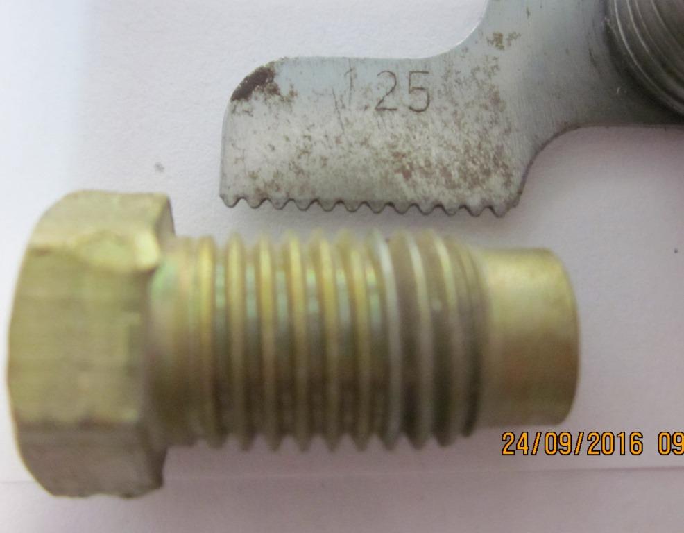

does the flex line have the same strange threads as a bellett ? If so where did you get it made
Tue Sep 20, 2016 10:23 pm
Glenn,I had new ones made for the Wasp. Any brake and clutch specialist should be able to do it. If not Pirtek, or any similar hydraulic company could do it.
Wed Sep 21, 2016 9:19 am
thanks
In the distant past i tried to get hoses made and the reply was the threads are non standard and the fittings have to be custom made.
Wed Sep 21, 2016 10:27 pm
Posts: 428
Location: Sydney NSW
Same here Glenn in the good old south
The local brake guys reused the Bellett fittings with new hose
J
Thu Sep 22, 2016 3:05 am
The hose was made by ACT brake service, a long term old school buisness. They made it by machining the end and cutting the threads by hand. This is because it has a mixture of metric and UNF threads! Cost $43. Pretty good I reckon.
Male end is 10x1 european (metric).Female is 10x1.25 and 5/8 unf.
Tube has 3/8x24 UNF nuts.
Bleed screws are UNF, but now a 10mm spanner fits at least.
Total cost 71.90.
Cheers, Matt
Total cost 71.90.
Cheers, Matt
not sure what you mean by 'tube has 3/8x24 nuts'.
Fri Sep 23, 2016 11:09 pm
Hmmm, tick tock! Time flies by, but back into Dobby now as I want him on the road.
I had to have a couple more lines made. The end of the rear section of the brake line that runs along the chassis was frozen. When I pulled it out, it had a badly pitted section, so just as well.
That description of the flare nuts above came from the receipt, and another brake place I went to said that my fittings are different, so Glenn, I'm not sure how they should be described.

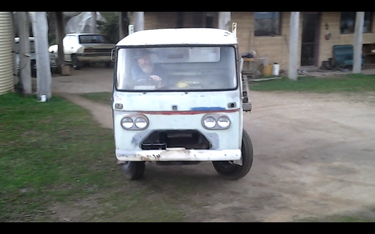

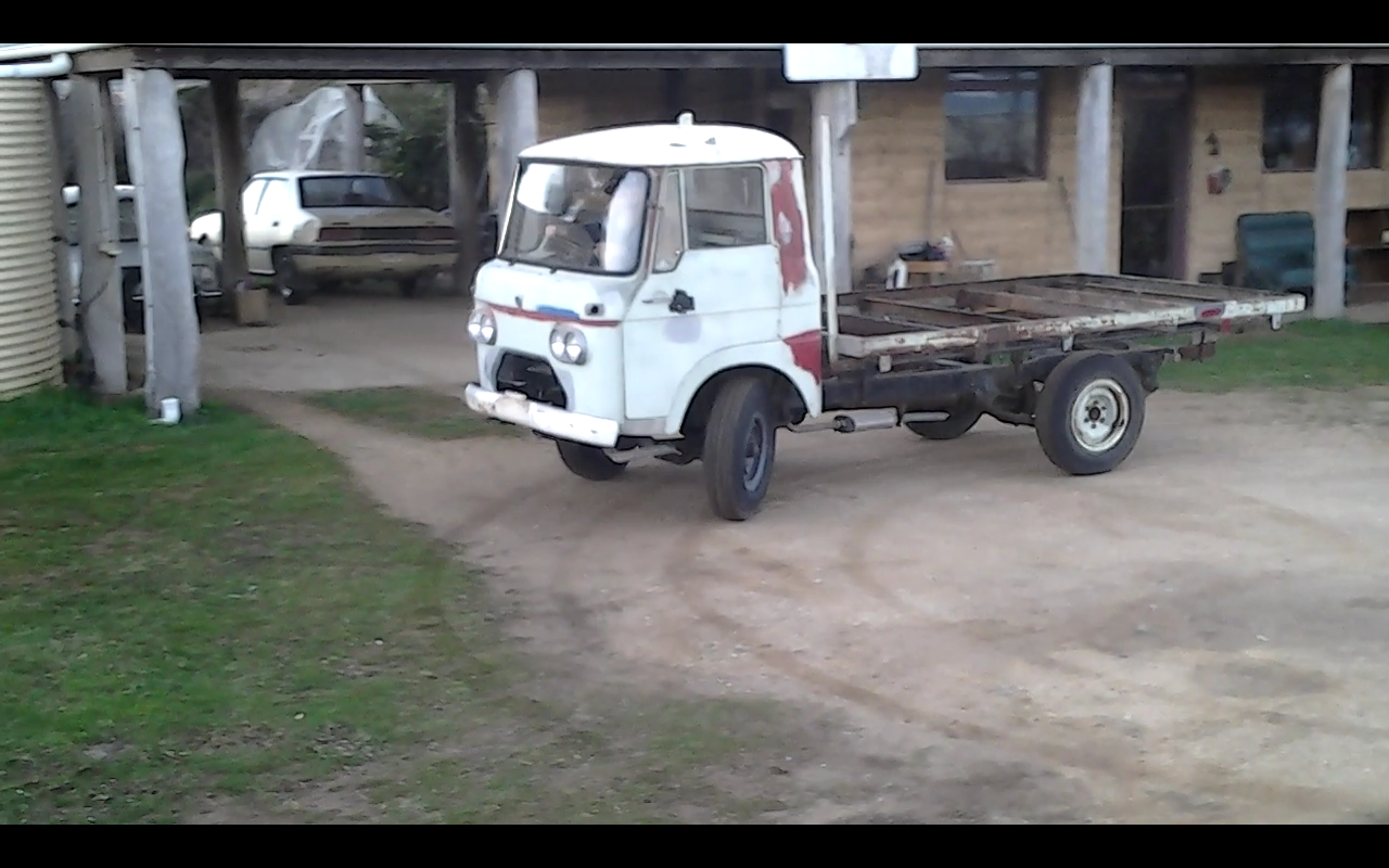

So today Dobby came out of the shed under his own power. :D
Heres an action shot!
Sorry theres no vid, for that you need instagram! (@ryeparkbellettbloke)
I was pretty excited.
He has a surprising turning circle, a bit tighter than a Bellett and way tighter than a Florian. Somehow he turns more tightly to the right, might be a wheel alignment needed.
So, the clutch works, all the gears select, even reverse, and the brakes are surprisingly effective, considering theres no booster.
