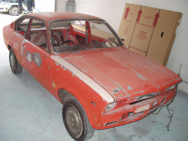

Site Admin
Posts: 208

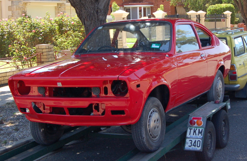

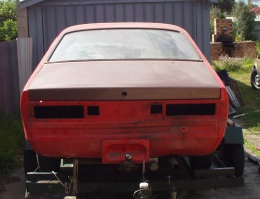

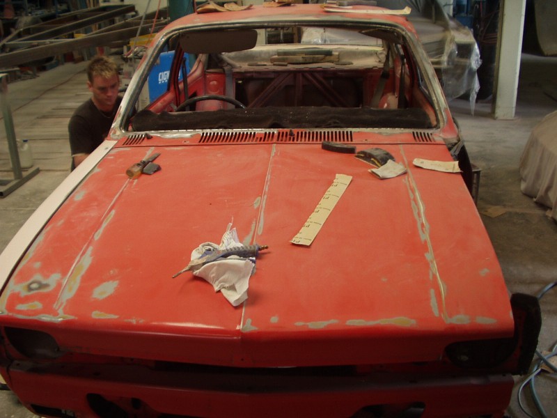

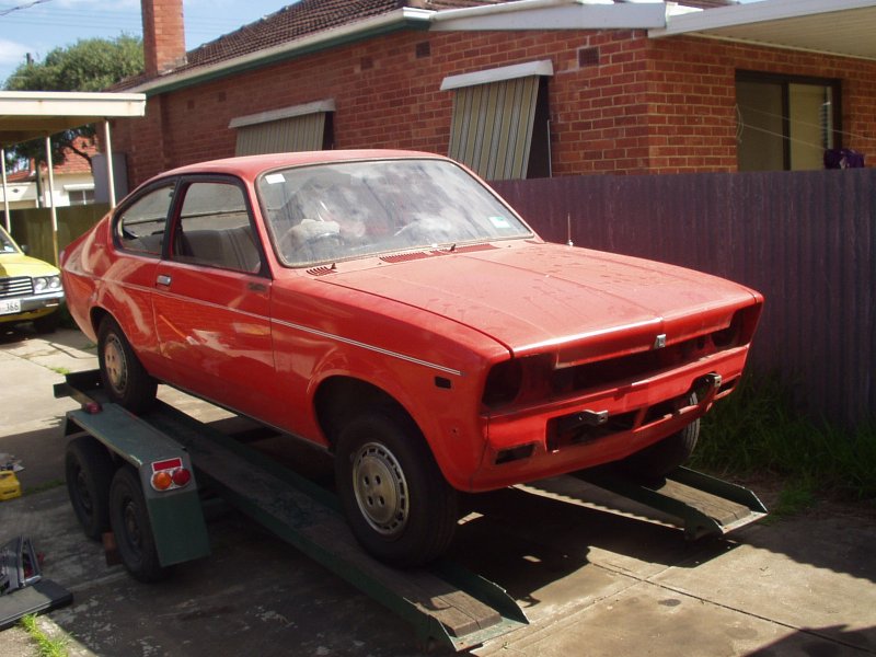

The car originally had rust along the back of the boot and through it that aligned with the frame. I took these photos after I had replaced the boot with this brown one, so the brown boot was the first step toward repair. There was a bit of damage to the bumper, and a bit of dent in the back, as well as more of a chunk above the left rear wheel (not pictured). These pics are after I had started stripping it for the body and paint work.

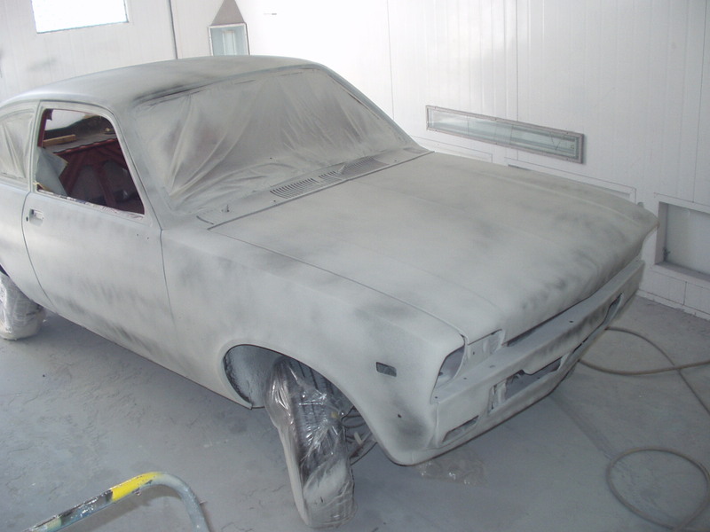

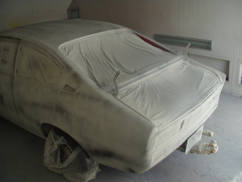

Site Admin
Posts: 208

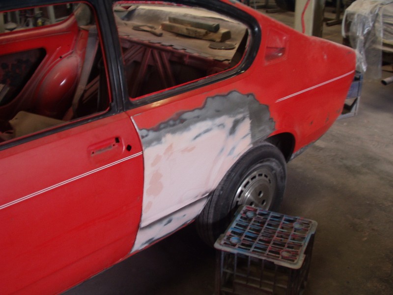

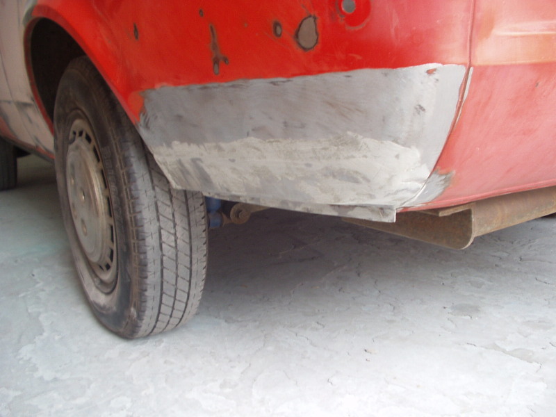

At the paint shop they took it back to metal where it was needed, fixed the chunk over the wheel, replaced the front left guard, fixed the boot rust, replaced the fuel cover, and generally made the body perfect.

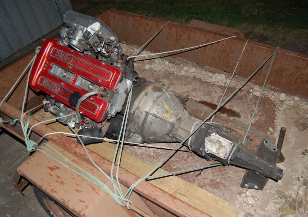

a good condition twin cam engine and 5 speed box was sourced, which also happened to have a suitably coloured rocker cover for my car. The engine was seen running but the ECU was not supplied. (Damn that was a mistake, blew out the difficulty and costs way more than I expected!)

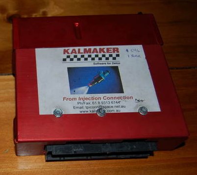

Site Admin
Posts: 208

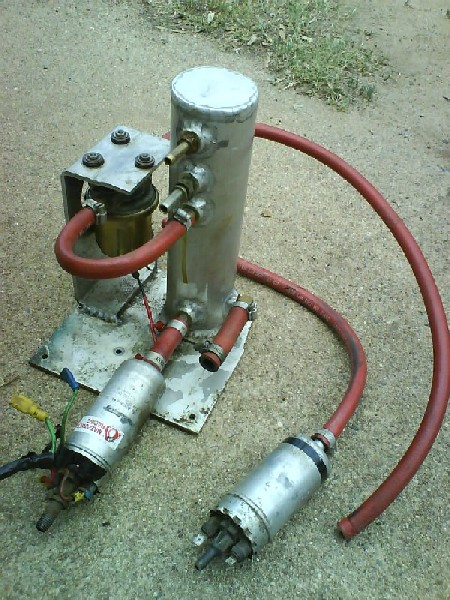

I sourced a Kalmaker ecu package, and a fuel surge tank (to later discover that all pumps had seized)

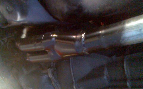

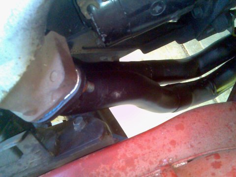

This 2" exhaust was sectioned on to the headers:

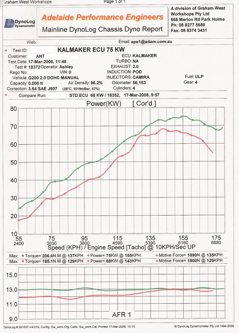

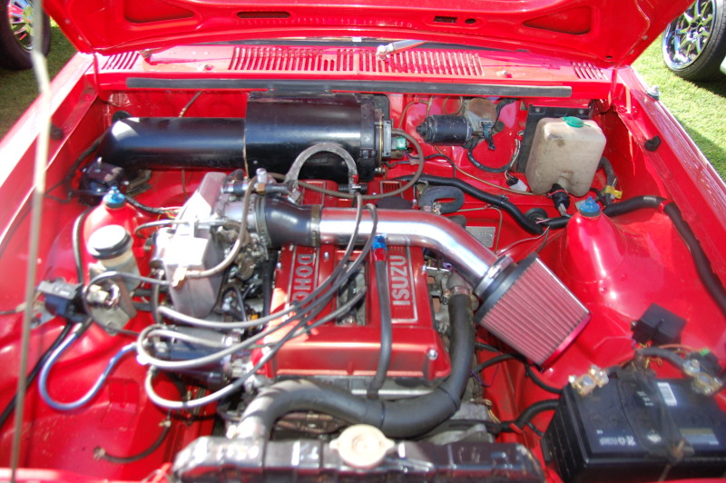

Site Admin
Posts: 208

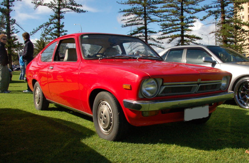

And finally I spent a lot of time on the EFI and eventually gave up and spent much more money than planned down at graham west workshops, who to their credit did an awesome job, got all the bugs out of it and I ended up with this.
