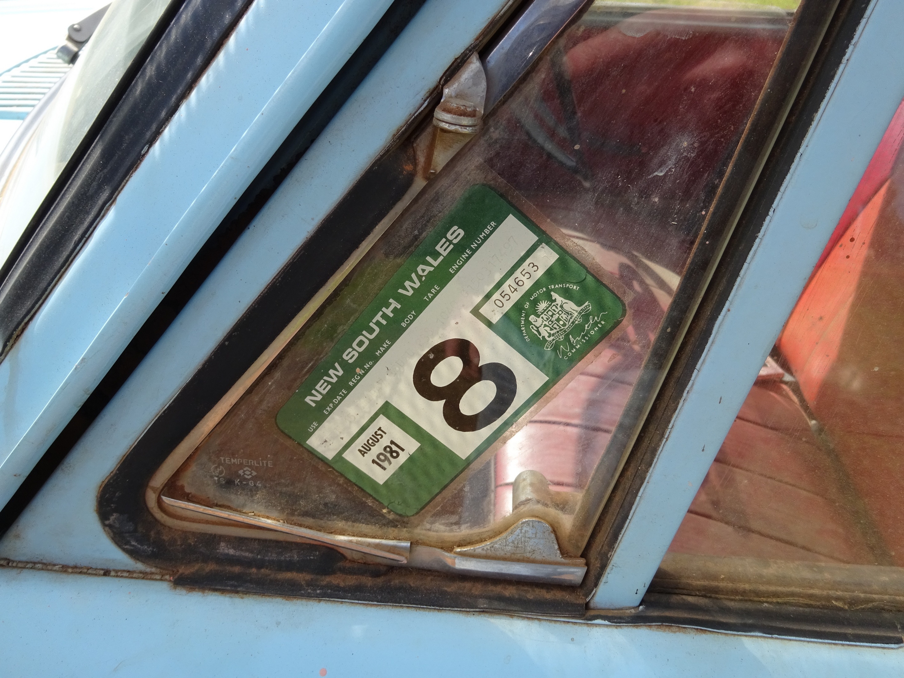

Last time it was rego'd was 1981 and the sticker is still on the quarter window :P
