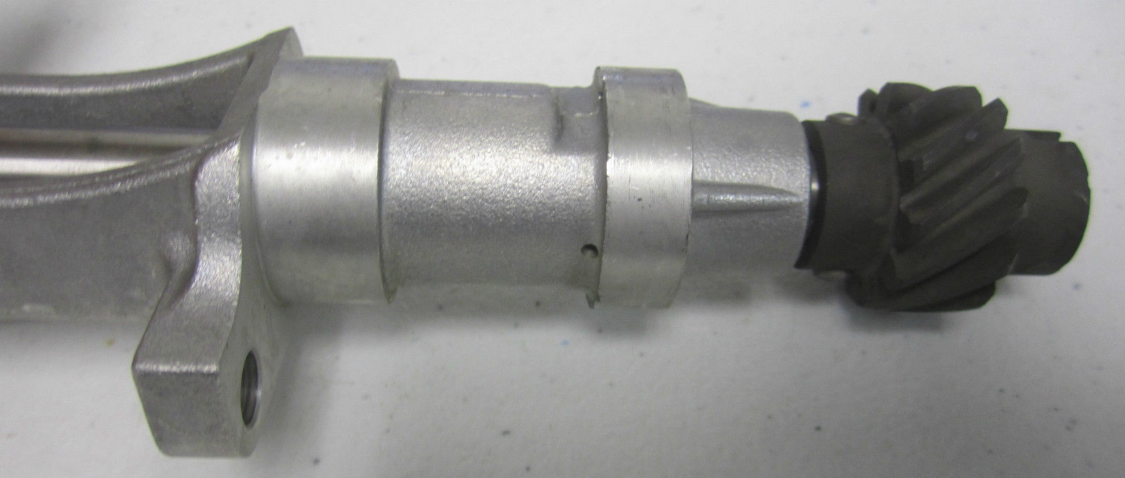

Here is my oil pump I have:

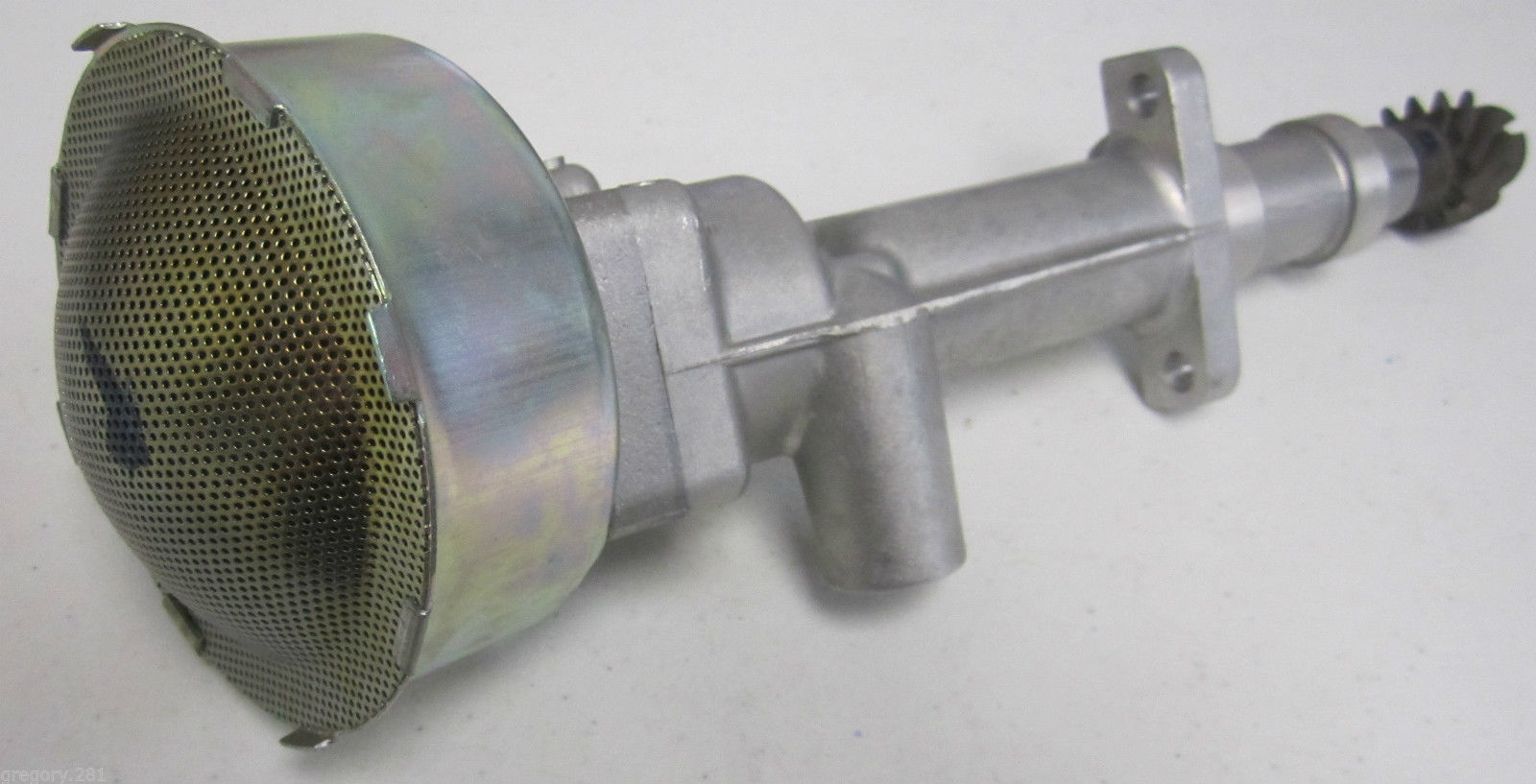

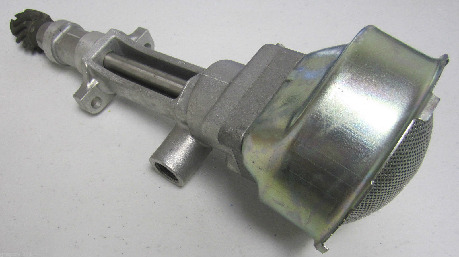

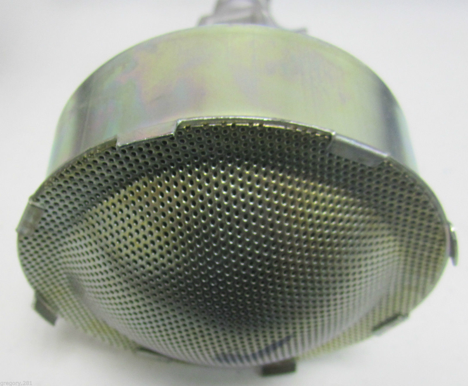

Here are the photos from the Ebay Advert:

Sun Nov 30, 2014 10:02 pm
eye wise they look identical ..hows the length ??? and how did you go with the other bellett in Darwin cheers davo
