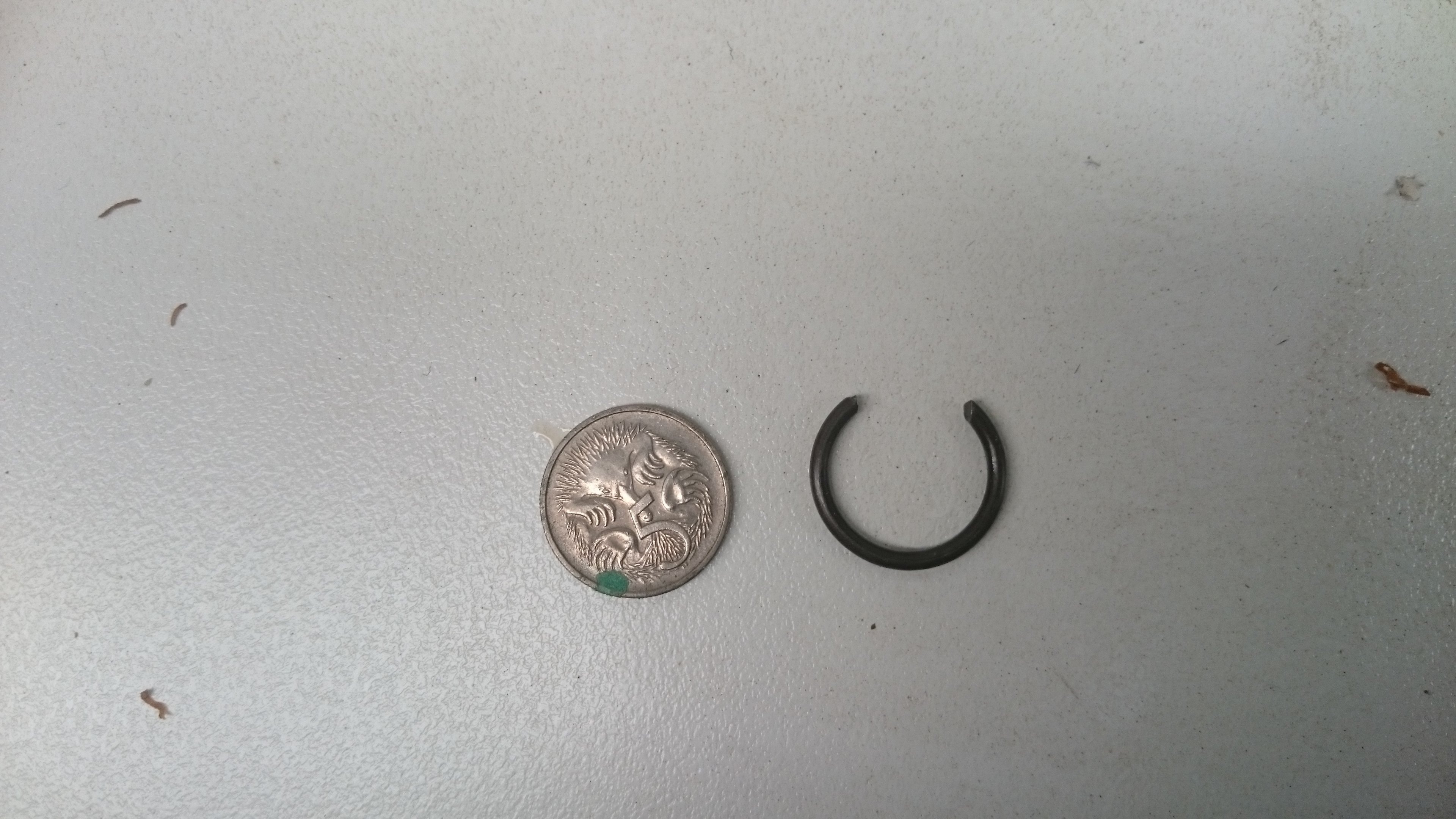

Found this inside oil filter on the deluxe any ideas where it's come from? Gudgeon pin clip?

Or second thoughts does it hold the spring an washer in place on the oil filter bolt?
Sun Sep 13, 2015 3:28 am
Ii will be out of your filter assy.

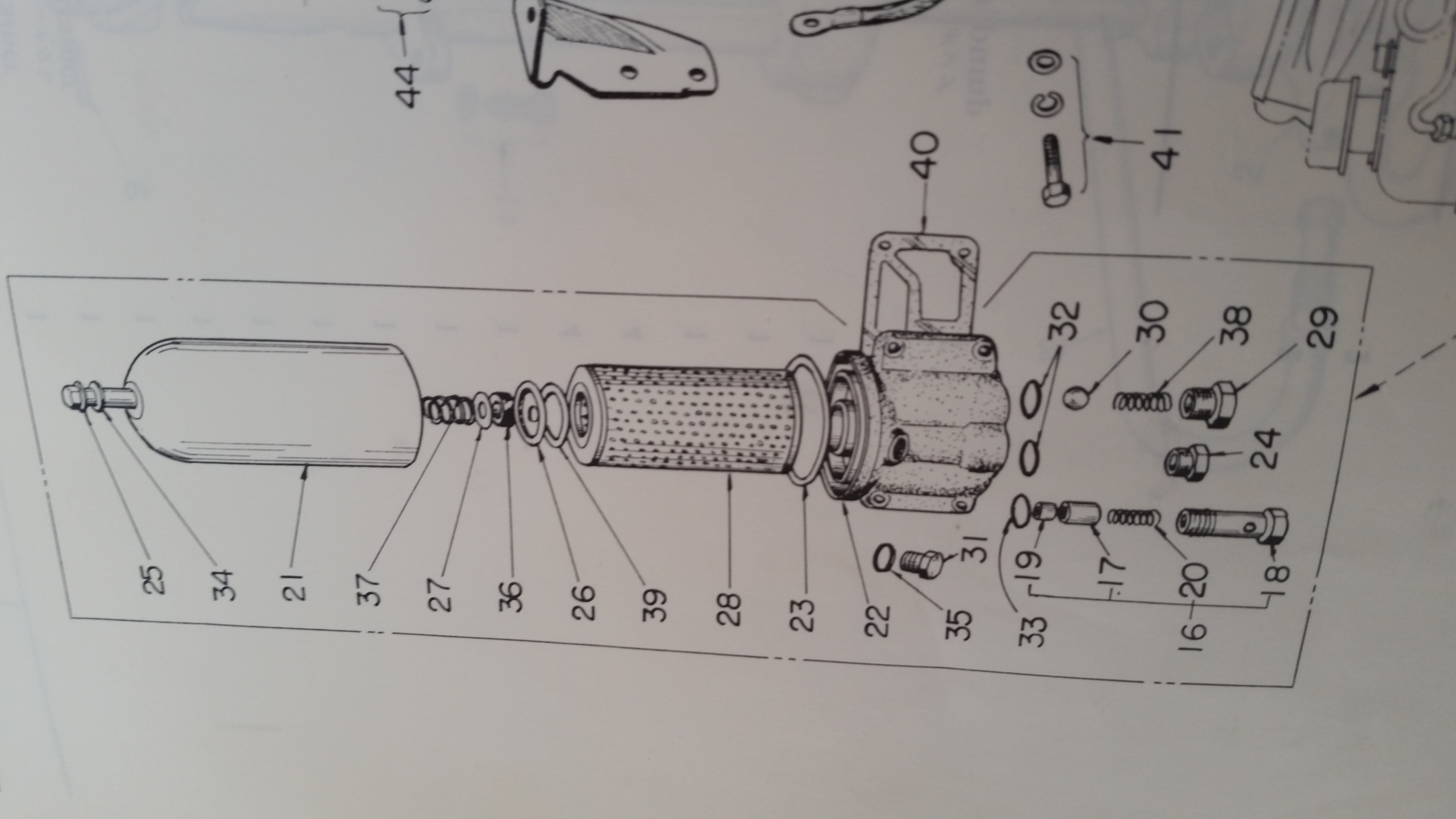

Yep jumped the gun an panicked. Took Betty's off to check. Looks like it was never put on correctly as the spring an washers dropped straight off when I undone it. Now just need to hunt down some new filters

Clip no 39
