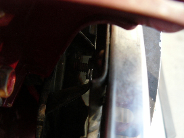

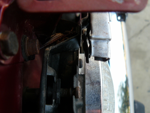

I need to paint these and add some stainless bolts :? and get that grasshopper out more jobs :roll: I hope this helps.

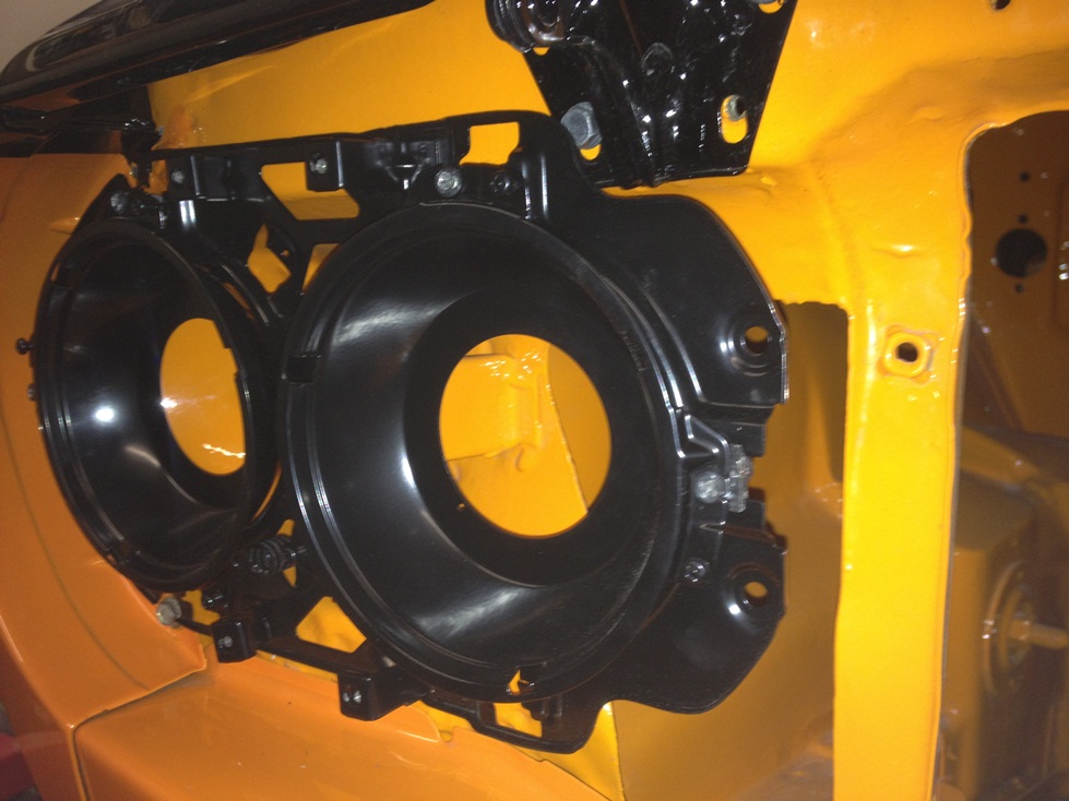

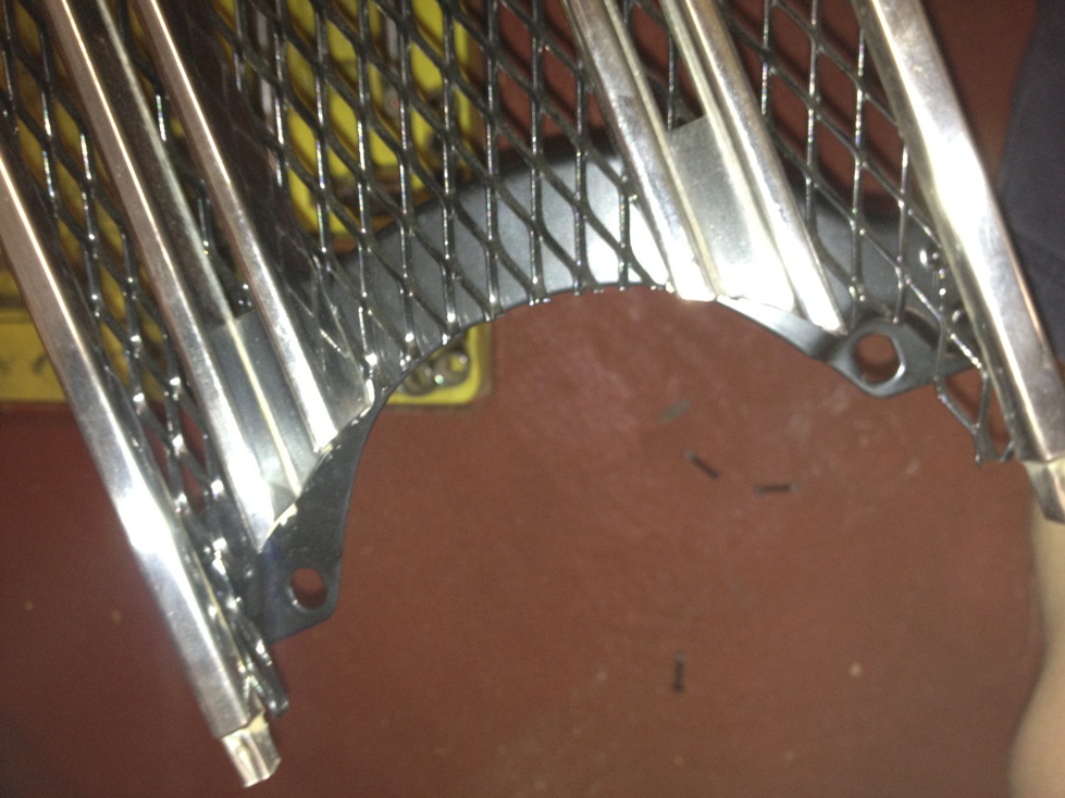

this is what i have or what i dont have!
i dont really want to weld anything to the headlight mounts as they have just been freshly powdercoated....would love to not have to redo them.

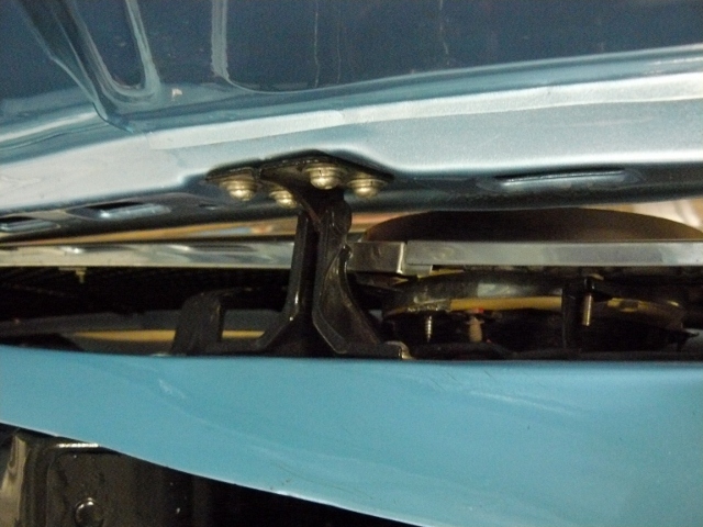

Waldo the other solution then is around a couple of inches in from the surrounds is a slot on the lower part of the front panel and a screw hole on the panel that holds the hinges. A sedan grill uses these mounts and i drilled out the rivets and placed them in the car refitted the grill and the outer headlight rings will hold the grill. I did this as a short term solution and it worked fine so i will leave it. I will send a pick.

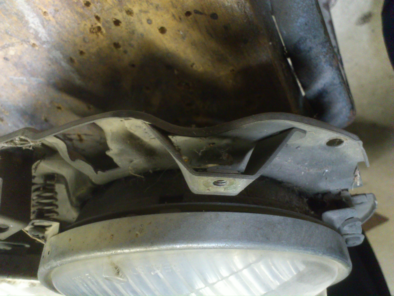

This is the '69 I have here.
