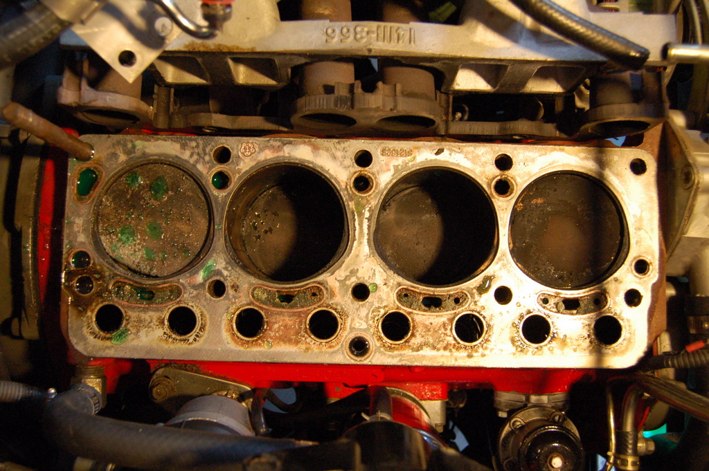

Heading back to Adelaide a couple of weeks ago from SA's Riverland...... lost a cylinder outside Murray Bridge.... yep, $250 tow back home. Finally got around to getting head off tonight, hoping for 'just' a valve or head gasket issue.... take a look at cylinder #4 below. WTF!

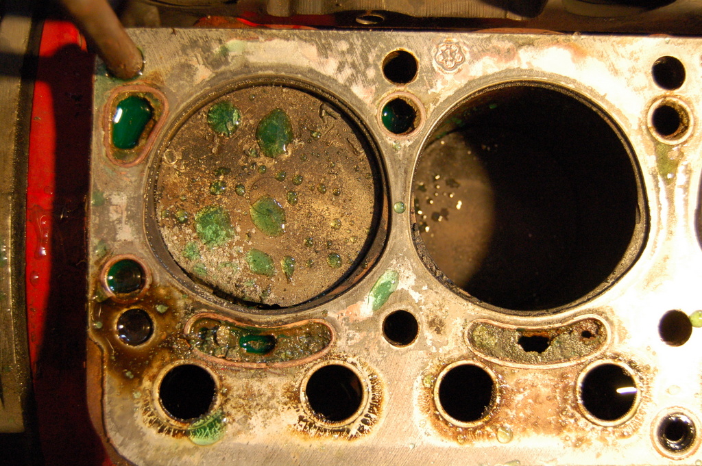

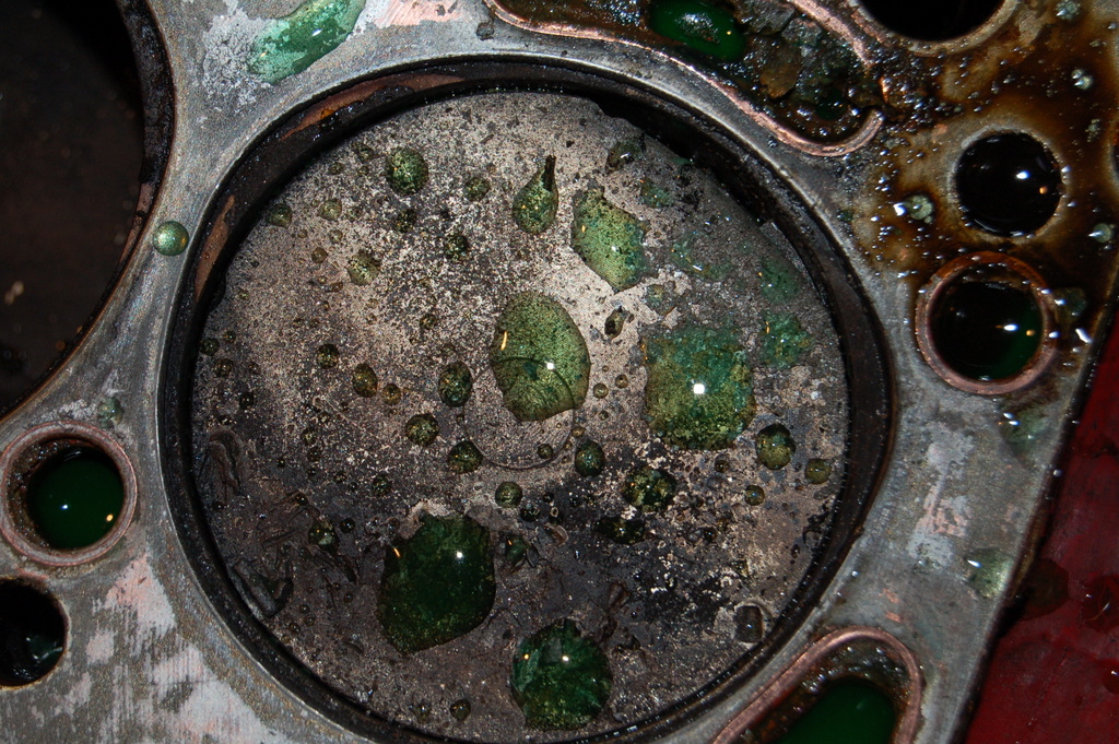

What's that all about? There's a bit of piston missing! Any suggestions on how the hell this happened? Here's a closer look...

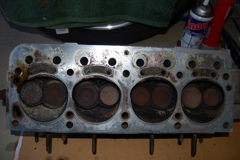

And here are images of the head.

Sun Sep 23, 2012 3:18 pm
Hey Paul,
Looks like you got a lotta corrosion built up blocking water flow through and
past the top of the pistons especially #4, causing overheating and the meltdown. :o
Maybe you didn't have a corrosion inhibitor in your coolant for a period of time.
I have just had my GT engine rebuilt, wasn't in a sorry state like yours, just worn and leaking
some oil. I used a set of Gemini pistons and rings I bought 4 years ago which had to be machined
In height and for circlip ring recesses to suit bellett gudgeon pins so my original rods could be used.
This means I have an old set of Bellett pistons you can have if you want to
do a patchup job, but you will still need the block and head unblocked :oops:
Cheers, Lewis

Mon Sep 24, 2012 12:49 am
with that amount of damage, your very likely to need oversized pistons anyway as that number 4 bore will be quite deeply scratched and worn.
the heads cooling galleys are more blocked as you look back from number 1. quite a build up of corrosion-calcium in the head.
that all said, its not often a Bellet engine does something like that. Hope she is back running for the Nationals :)
let us know if there is anything you need help with.

Mon Sep 24, 2012 11:40 am
Hi Paul, mate, that is sad! :(
It does look pretty melty, but there is another possibility if you discover that the water wasn't blocked, though it is likely to be, my Florian alloy head was all blocked when I got it. Strange though that I was able to drive to the 2011 Nats & back with the temp needle just under the red bit without this happening.
Sometimes a top ring can break up, and the little bits move up & down in the groove, wearing it untill they break through & come up on top of the piston. Are those bits if ring sitting on top of the piston? And the dents in the head surface look like ring bit dents. This is what happened to my first motor in 1977. Same result though, there will probably be bore scoreing needing a re-bore. (Though back then I was still at school, so I was given a good used piston by Ted Freeman, a set of rings from Gary and bought a $10 head gasket. I smoothed the bore score with emery & put it back together. I did about 20,000 mile on that motor, then sold the car to a mate. It used a little oil, nothing serious. Tuff motors.)
