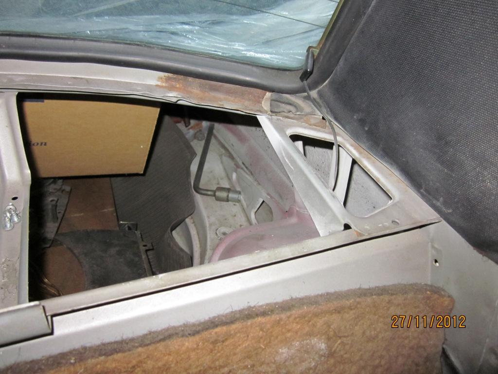

By the way, the engineer i contacted but no reply 2 weeks ago, got back to me yesterday and is happy to do it for $400 (on site)........ mainly interested in the belts. This is proving a problem, There is next to NO metal in the parcel tray area to fit the upper mount.

I'm guessing that a sport is identical to sedan. Maybe this later model has chnaged, not sure. But there is simply nowhere i can see to mount the top hole. I ripped all the shelf out last night. In the corners there is a flat section with the centre cut out (very BIG square hole) but the metal is VERY thin and not up to it i don't think. On the back edge of the side upholtery trim panel, there is a flat section but it is below the top of the seat which according to the ADRs' is too low.

this is how mine looks. That corner section with the big hole in it is very thin metal. About all i can think of at moment is to fit a snug piece of 3mm plate under it to fit into the corners underneath and maybe another piece over the top, in the recess then bolt through the both of them, or maybe also tie it into to the rear squab panel also. The top of the rear seat sits about 70mm above that edge also.

Could your belts be mounted over the seat and down to the floor in the boot like we used to mount full harness belts years ago?
Would that be acceptable with the Engineer?

I have just read your post, and I woukd ask your engineer what he wants or his sugestions, send him your photo's.
The back of the GT is similar, but a much smaller area. I made plates to fit into the holes, drilled and threaded them, and you could finish off with nylock nut. the other solution might be to run a brace from the bottom of the fixing bolt to the wheel arch with another plate.
Have you ran your fingers over the hood lining to see if there may be another mounting point up there?

The C pillar has a cover which forms a duct for the air extraction and there appears to be no way to use that area. Have had my hand all round those areas. Some is double panelled also and you can't get into it.
I'm inclined to use the corner and double plate it with 3mm steel and also perhaps bring it down to the back of the seat too. I am going to remove the plastic parcel shelf also as it has huge speaker holes in it and fit a flat MDF one there too.
