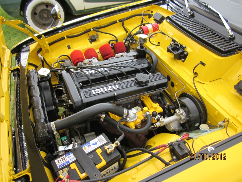

Davo those white wires go from the alt to the reg if you unrap that section it will seperate from the loom i think you will fing the light white will be your charge light and the fat black will be your power supply to the fuse box.
You will need to check other wires bundled in the loom to confirm they are not melted together. I run a fuseable link from the power supply to the fuse box to prevent this. The problem is the wire from the battery or starter solinoid is always live and it has no weak link until it leaves the fuse box, a fuseable link looks like wire so it will not effect the standard look that you are trying to achieve. They come in different colours for the right amps get some advise from a auto electician as i have estimated what amps i have used.
You will see in the photo above the 2 on the date this wire is 2 inches of fusable link in the event that the main power supply to the fuse box fails this 2 inch piece of wire should burn out before any other damage can occur. Your car may be a little different as i cant remember the set up as i think it was a later engine set up than the teardrop :?: But it just needs to go as close as you can to the power supply.
