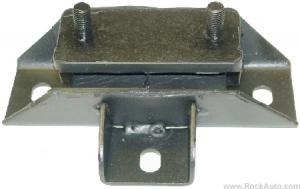

Chevy Luvs start with 1972, maybe later than the KB design.
This is only allowing one image attachment per post.
This is the Luv transmission mount.
- Attachments
- LUV Transmission Mount
- Chevy Luv Transmission Mount.jpg (8.25 KiB) Viewed 78403 times

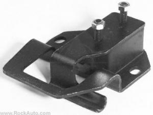

And the Luv motor mount.
- Attachments
- Chevy Luv Motor Mount.jpg (8.25 KiB) Viewed 78400 times

Those engine mounts posted by JT are the ones I used on the Wasp.
Looking at them now, they are slightly different to a Bellett one, but nothing a small trim and a new mounting hole can't fix.
In that pic, the "loop" of steel and the "tab" under it aren't on a Bellett mount, so they could be removed. Also, from memory, the holes in the Luv mount were too wide for a Bellett. The hole at the foreground of the pic will line up, but the other hole doesn't, requiring a new hole to be drilled and the extra steel on the plate to be removed as well.
The gearbox mount looks very, very Bellett. The only difference I can see is that a Bellett doesn't have the extra "tab" that is on that mount in the foreground of that pic. Again, a quick removal is in order.

I know the search function in most forums is dubious at the best,
So here is the result of my search for engine mounts ...
Many thanx to A.J. for this info,
If you want engine mounts contact Tony, he can make the metal part but it is better if you send him the old mounts to refurbish.
http://www.bellett.net/forums/viewtopic.php?f=36&t=57

Re: Engine and Gear box Mounts!
I am about to make you all puke. I have just bought a gearbox mount in NSW $68 including postage. With all the parts I have that was the one I did not have. i had even forgotten what the looked like so I had to email Brett to see if that looked the part.
They also have a few other bits. Like some door skins.
Peter
PS: part number is 8942266800.
The centres on studs 75mm holes 130mm
Peter

I picked up a set of kb20 engine mounts in brisbane today there are gearbox available as well.
The engine mount will need to be drilled as 1 hole is spaced further out but there is enough plate to replicate the original bellett. 4 inch angle grinder with a thin cutting disc and a bucket of water should be a buzz
