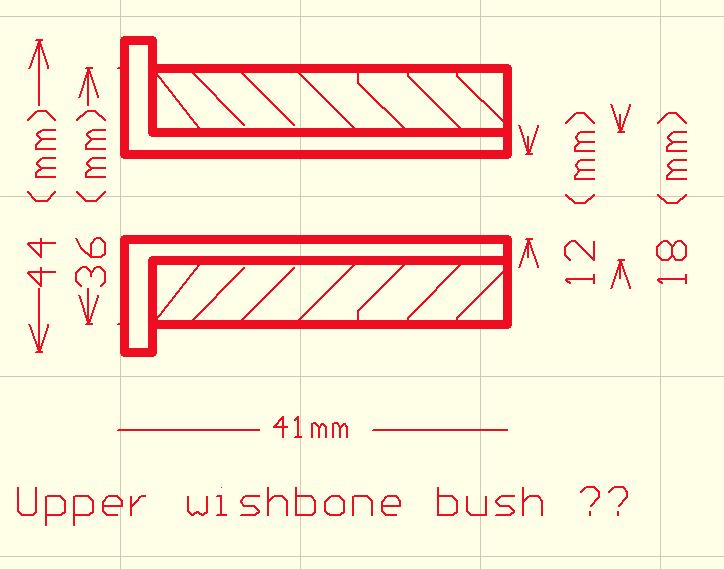

Does anybody know or have aprt to measure, I am after the dimensions of the upper front wishbone bush
I 'think' it has a pressed in metal tube also. But if i have the basic dimensions i can look for something to replace it or perhaps turn up a new one.
Nolathane have a zillion bushes but finding right one is proving hard with out dimensions.

Thanks, that will be great if you can measure for me.
Nolathane list many sized bushes (all dimensions shown) and I was hoping to find something suitable.
I take it from what you say there is an inner and outer metal tube ? Perhaps you could take some pics also when you remove them. Main interest in top bush.

ok front upper arm bushes----shell o.d. 36mm, shell flange 44mm. Total length of crush tube 41mm, i.d. of crush tube 12mm. ( o.d. of crush tube app.18mm)
lower arm bushes---- shell o.d. 32mm, shell flange 44.75mm. Total length 52mm. Crush tube i.d. 16mm (o.d. 20mm )
rear arm bushes -----shell o.d. 34mm, shell flange 51.5mm. Total length 84mm. crush tube i.d. 14mm (o.d. 20mm app.)
Now these measurements are taken from the used bushes removed from the arms of my 67GT., using a set of manual verniers. They are as accurate as I can provide, but if anyone has new bushes to measure, please do.
Cheers, Warren.

Many thanks. Gives me an idea on what to look for.
Note comments also of nothing in catalogs. Alternative is to machine up new stuff of course.
is there an outer metal tube also or just the metal of the arm itself?

is this how your measurements come out (upper only)
[angle lines are the bush material itself]
later edit: changed picture

Your top and bottom red lines don't exist along the length of the bush, just across one end, but otherwise looks good.
Mon Dec 21, 2015 10:26 pm
yes, i realised that after posting the drawing
are there 2 per pivot?
Tue Dec 22, 2015 12:14 am
Ok revised drawing looks good. Two bushes per arm.
Tue Dec 22, 2015 12:58 am
this looks close.....although crush tube would need to be re-made
and one end would need to altered
