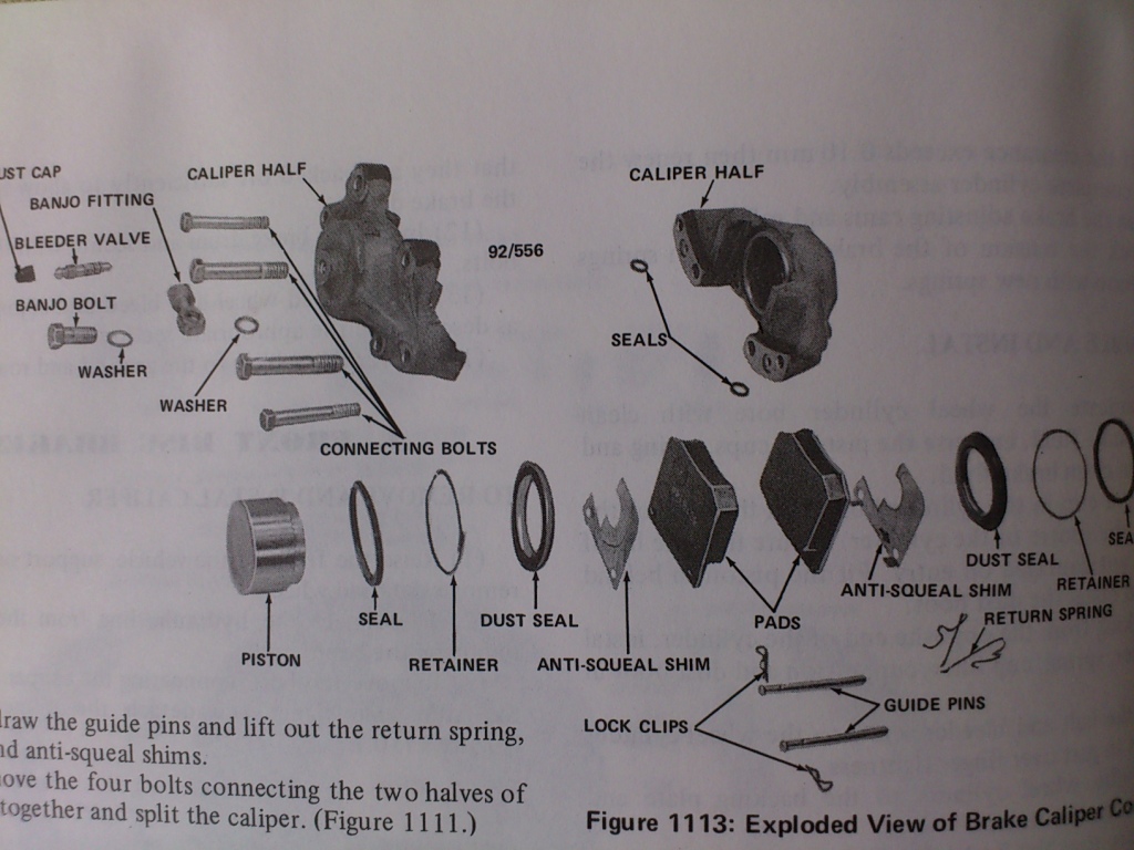

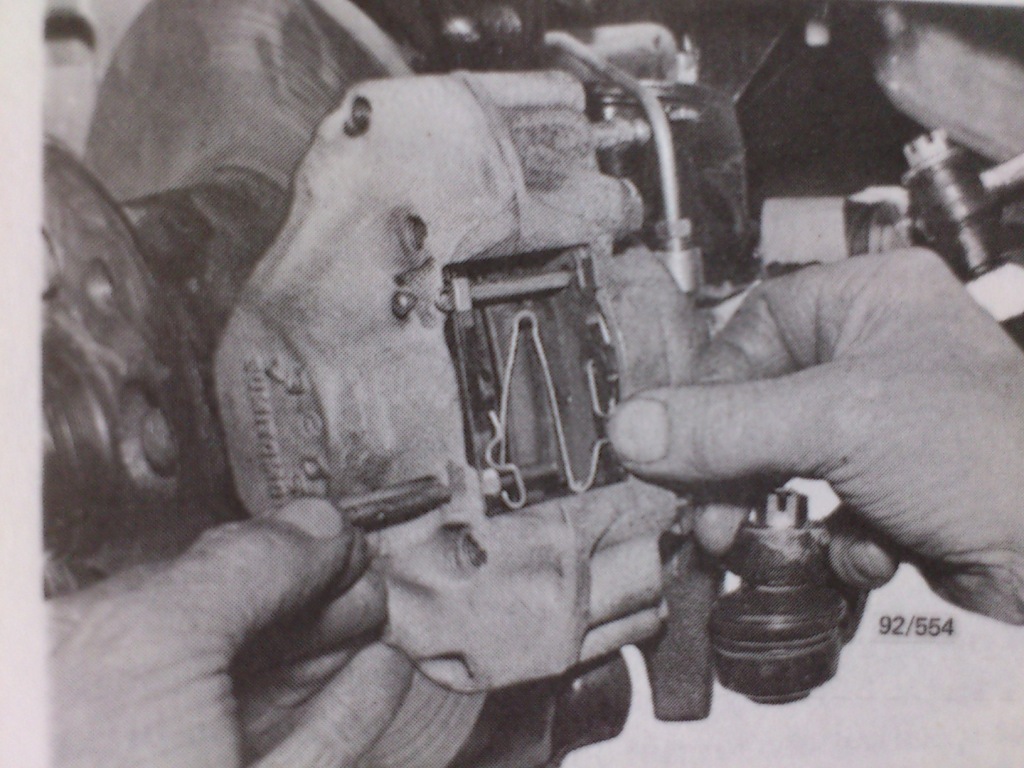

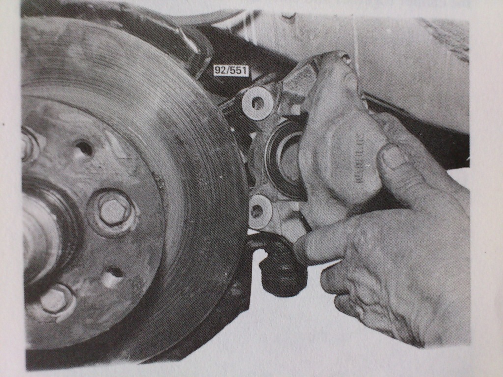

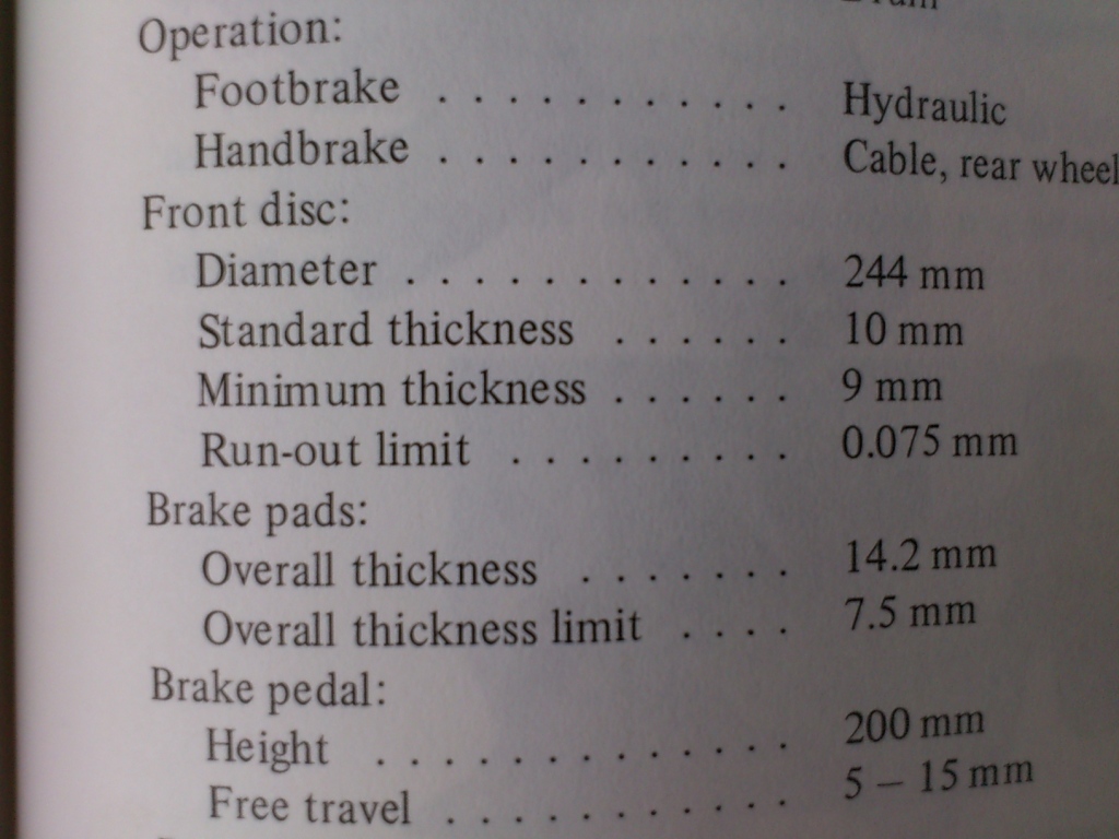

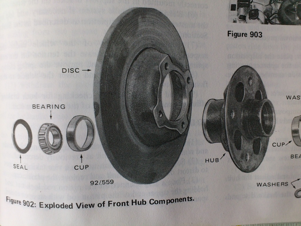

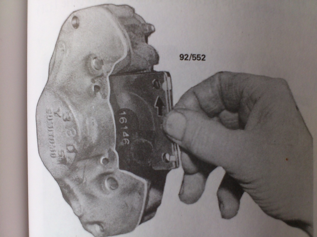

Doing some cleaning up and found and old Mazda DIY book. Quite surprised to see that the disk brakes are very similar to GT's. Calipers have internal piping but the PADS look like GT though.

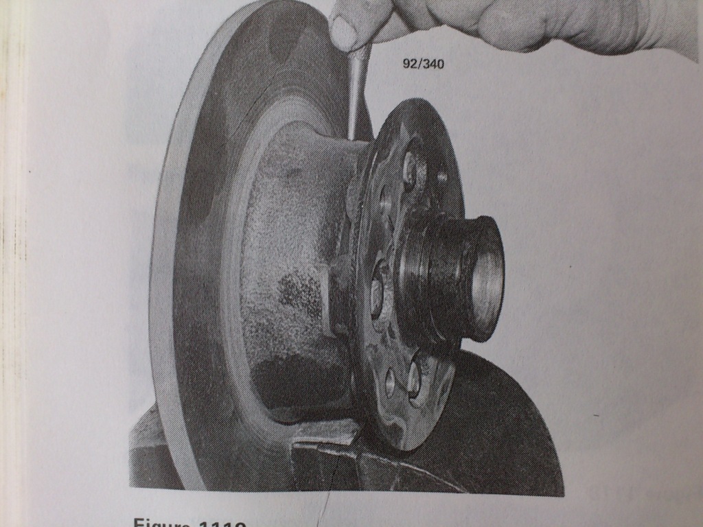

Rotor is similar size, even the hub appears like it might interchange with GT ???
Maybe the seal is same size as GT ?
The chances of finding one of these cars in wreckers is pretty slim though, but pictures show the similarities.

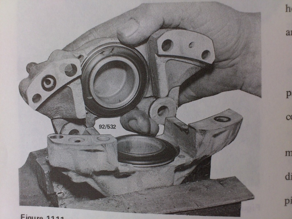

If anybody has brake part books, would be interesting to look up what pads they use.

Brake padss are available ex Japan.

I wa wondering if the disk or hub etc might be adaptable. The disk might be listed with DBA etc while GT is not.

Not sure, but Greg had some brake pipes made the other day and they told him that one model Mazda used the same fitting as the front caliper of GT.
Looks like gt sedtup.
