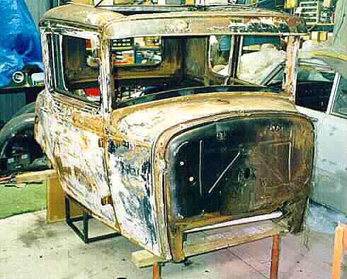

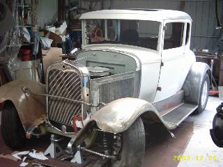

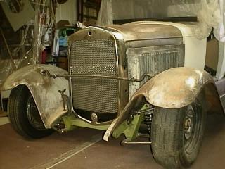

OK HERE IT IS. I STARTED WITH A BODY ONLY AS YOU SEE. NO REAR PANELS, BOOTLID ETC.. NO FLOOR
Typical for these cars, rust all round the bottom 100mm has to be replaced with metal. Bullet holes etc.........
Remember, these cars had a wooden inner structure with a lot of the body nailed to it ! All replaced with steel tube now..
That big hole sin the roof use to be a material nailed to wood also. Now filled with steel and ssunroof from an early Nissan Micra.
Just to keep the thread "Bellett" ;) In the background is a white GT I was putting the Turbo Piazza motor into.

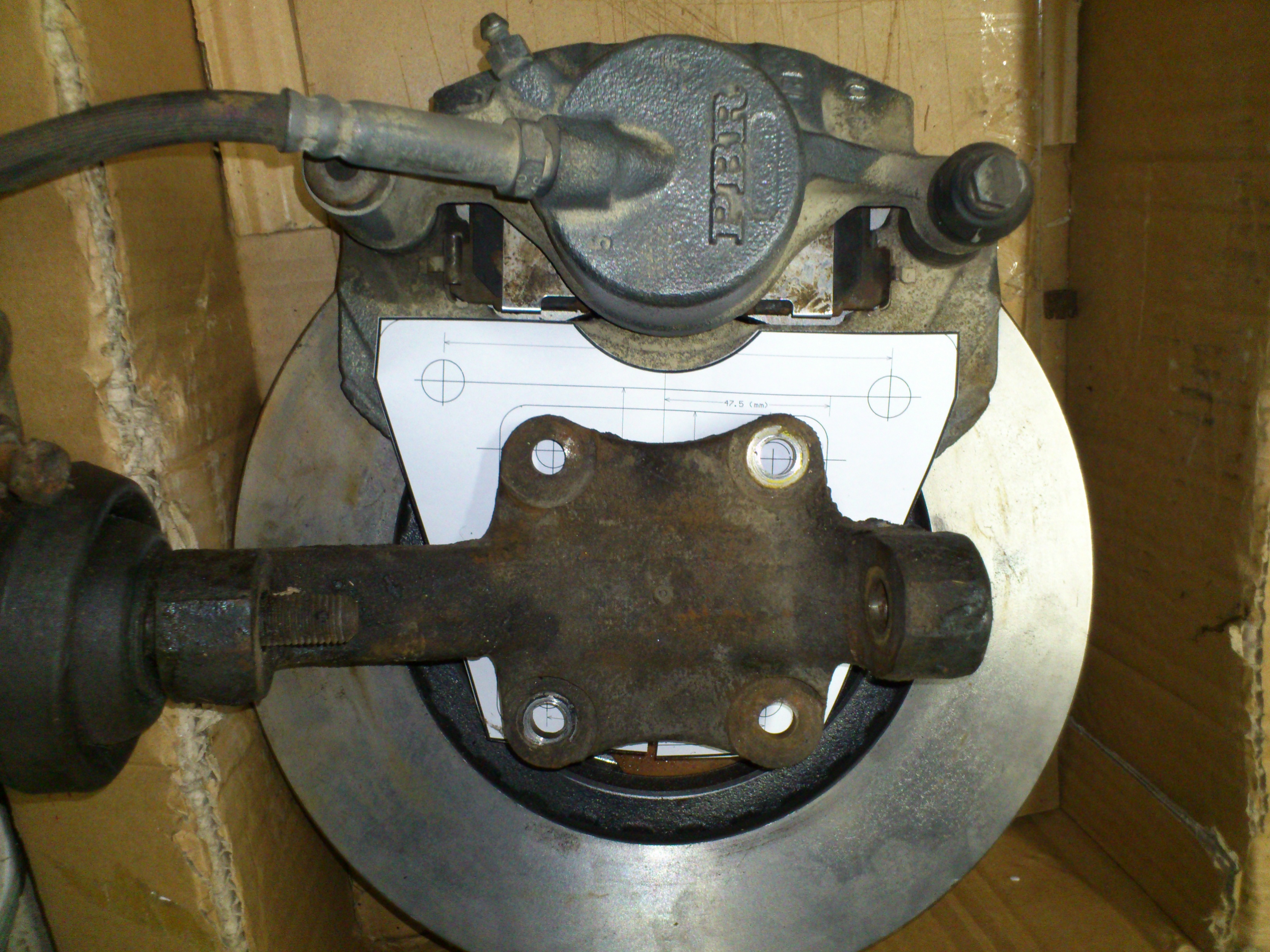

a bit more....... Miserable day today so went to get some steel. This is very preliminary, don't run out and copy this as it's just to show what progress there is?
I bought a piece of mild steel bar, 200mm wide. I won't mention thickness yet.
I used a printed circuit board design package to draw up the caliper mounting bracket. Then printed to scale and cut it out to try. This is the 1st trial only and the pictures do not really show it fitted up properly as i ran out of hands........
Will need some more fiddling etc before i actually cut the steel. The steel cost $6.80 but a bunch of cutting disks added $30 to that ! :( Maybe I don't need them all.
One would assume that if this was a conversion that worked out OK, then laser cut plates would be cheaper and easier. The hassle though with this conversion, using the Magna calipers pictured, is that milling of the bracket is needed also. While I have a mill at home, that is no problem for me.
File comment: print out of the bracket. NOT final version !
File comment: approx fitting of bracket

sorry, bigger picture now......

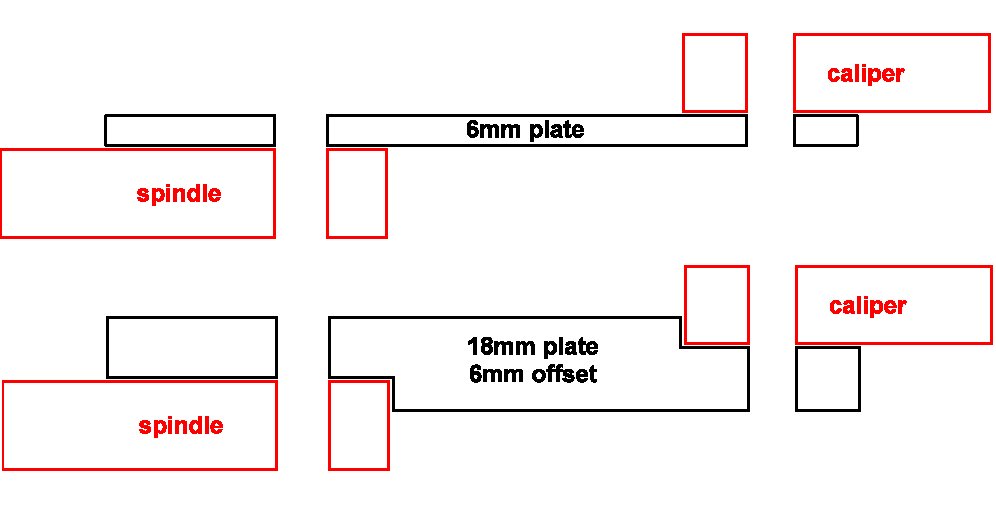

What if you use a 10 mm plate, and machine the face of the spindle mounting surface into one side 2 mm deep, and machine the face of the caliper mounting surface into the other side 2 mm deep?
The offset would be 6mm but the material would be 10mm in the middle and along the edges, for a little extra strength.

This is a diagram of what I was trying to explain.
I drew as 18 mm to illustrate. It's not to scale or an accurate section, just an illustration of the idea.
The idea would be to locate the position of the holes in a thicker piece of sheet/plate. Then draw the outline of the spindle on the back side, and the outline of the caliper bracket on the top side. Use a mill to cut the outline of the spindle into the bottom of the bracket, and cut the outline of the caliper into the top of the bracket, leaving the desired offset (6mm) between the surface that has been recessed into the faces of the bracket.
This will provide more thickness in the middle of the bracket, and on the sides opposite the caliper and the spindle mounting surface. And with more thickness, more strength.
You might also want to add more material around the outside of the axle, and provide enough space to attach a dust shield to the back of the caliper bracket to keep rocks from hitting the back of the disc.
The legal requirement described for not removing material from the spindle or the caliper is less a spoiler and more of a justification for making a more detailed bracket. The more important benefits are:
    1. The car can be returned to the original brakes without additional machining.
    2. Any standard (same model) caliper can be picked up off the shelf and bolted directly on without modification (in case it breaks or wears out).
    3. The same bracket can be used by anyone to attach the same model of caliper to a car sharing the same spindle, without the need of any machining to make them fit.
    4. It is less expensive to machine one piece from scratch, than to machine one piece from scratch and then machine the two existing pieces that bolt to the bracket.
