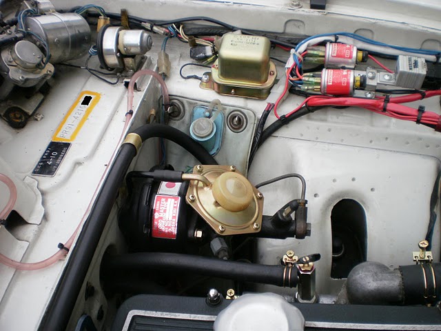

OK, that's going to be what this is. (picture below).
Is it set up with only the front brakes receiving power? It has separate reservoirs for front and rear, and piping. That would require two boosters, right?
Also, the rumorpedia quote: "...the GT-R featured a 1.6 L DOHC engine from the 117 Coupe, power brakes and numerous other modifications." The 117 Coupe has the booster mounted between the firewall/pedal and the master cylinder. So the power brakes weren't "from the 117 Coupe". The rumorpedia quote is ambiguous enough, but worded to at least imply the power brakes were a transplant, not a unique development.
This might be another thing to look for in identifying a GT-R. G161W engines might be pulled from 117 Coupes to convert Bellett GT's to GT-R "spec", but the remote vacuum booster might be more difficult to find.

all GT-R's had them, as did SOHC GT's, and alot of other jap cars from the day, so they are common enough and not a true guide of whether a car is a genuine GT-R or not tho. i have one here to put in the "GT-R'd" orange sedan that looks exactly the same, but it's from a mazda 1500SS.
they only work on the front brakes. the rears are plumbed direct from the master cylinder, and also have a proportioning valve under the back seat to prevent rear brake lock-ups. the 35 page GT-R brochure i have here, printed in october 1969, shows an exploded view off all this in detail.
